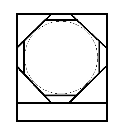

            Something along these lines would be even better for a round oven, as the steel would be right under the oven wall plus it uses less material (less weight too). The area under the hearth & landing could have a frame of lighter weight material.

              Is the backer board going to support any of the weight of the oven? Maybe I'm misunderstaning, but I think you're going to need something quite a bit stronger. I'm still thinking an iron plate across that frame illustrated above would be better somehow. Interesting!

                That was a bit unclear. I didn't mean to suggest placing weight on any unsupported backer board. It wouldn't hold.
                My little oven design I'm working on is a kind of tapered barrel vault & the structural steel frame will be directly under all the walls. If I didn't skin the frame with steel (which I probably will), only the odd brick in the hearth would be supported by the backer/FB board.
                For a Pompeii oven the frame would definitely have to be skinned with steel. The sketch puts the structural channel directly under the walls. I didn't draw in any of the hearth frame or landing frame, only the heavier structural members.
