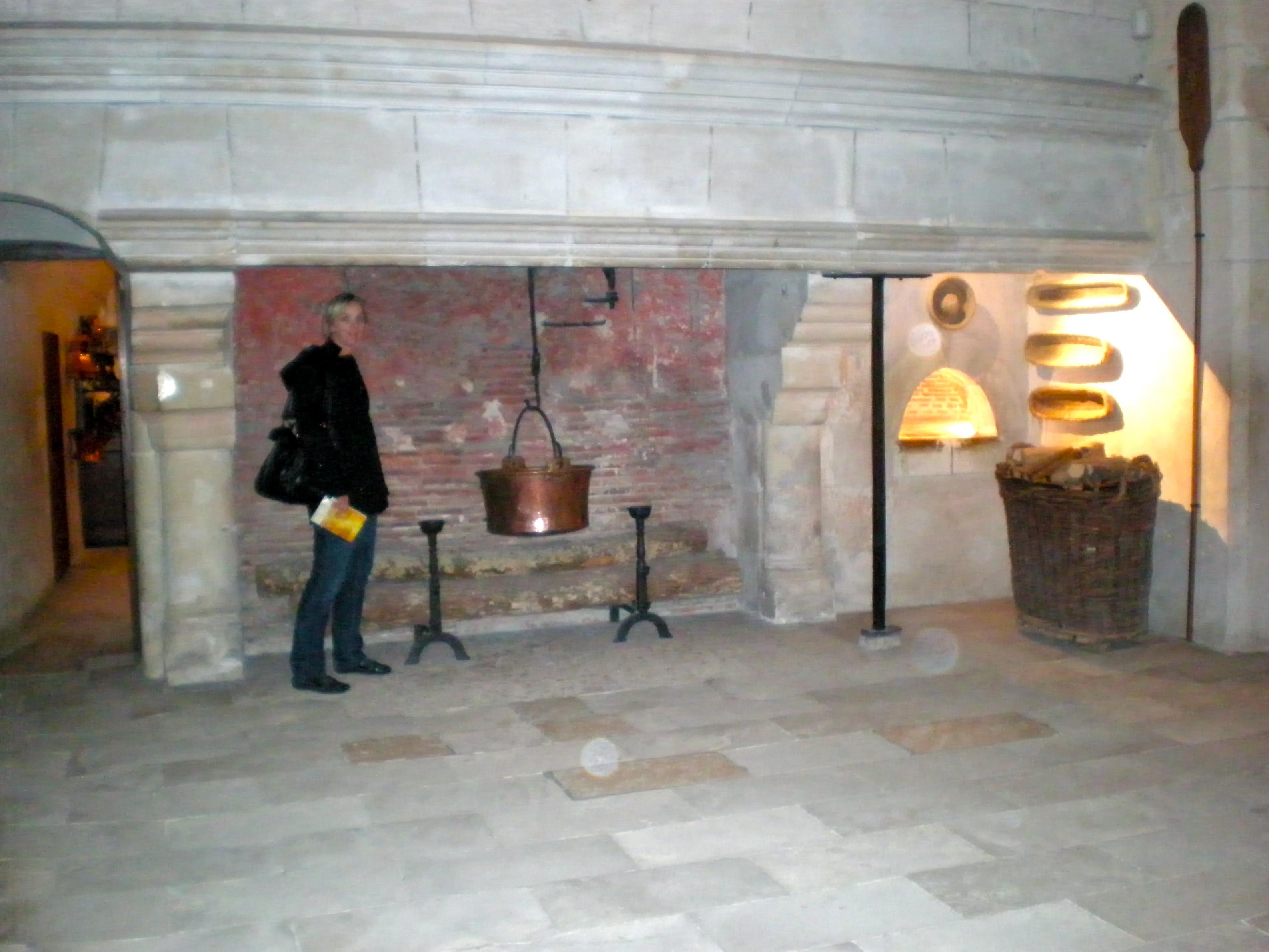

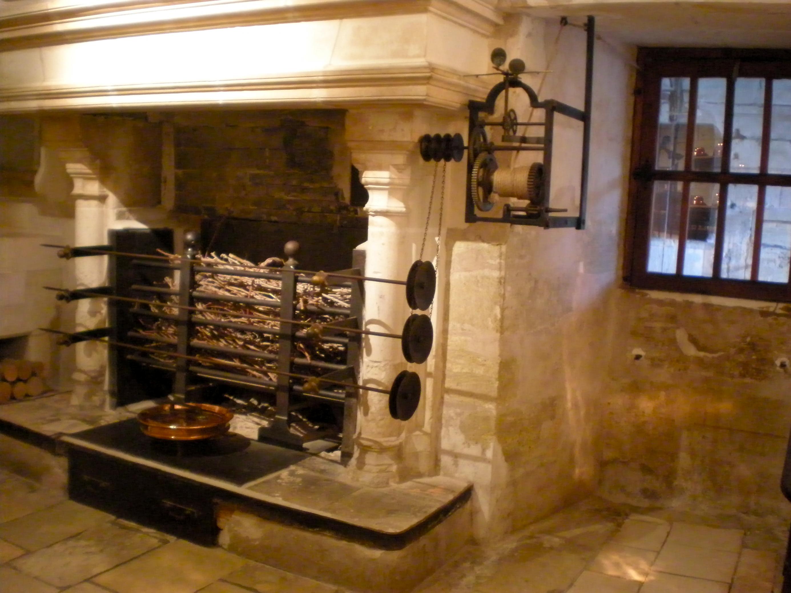

          Rom,
          Here is a solution that I noticed many castles in Europe use to share the one chimney. The rotisserie is powered by weights that drop down from the window, which was also used to lift produce up to from the river it spans.This is one amazing house, probably built on the profits of slavery.
          Dave
          http://www.experienceloire.com/chate...henonceau.html Click image for larger version

            • #7
              Rom,
              Dave
              http://www.experienceloire.com/chate...henonceau.html [ATTACH=CONFIG]n382756[/ATTACH] [ATTACH=CONFIG]n382757[/ATTACH] [ATTACH=CONFIG]n382758[/ATTACH]
              David S,
              Sweet, the weights work like our spinning axles only I will have an electric motor spinning the whole thing with some gear reductions...
              Thank you,
              Rom
