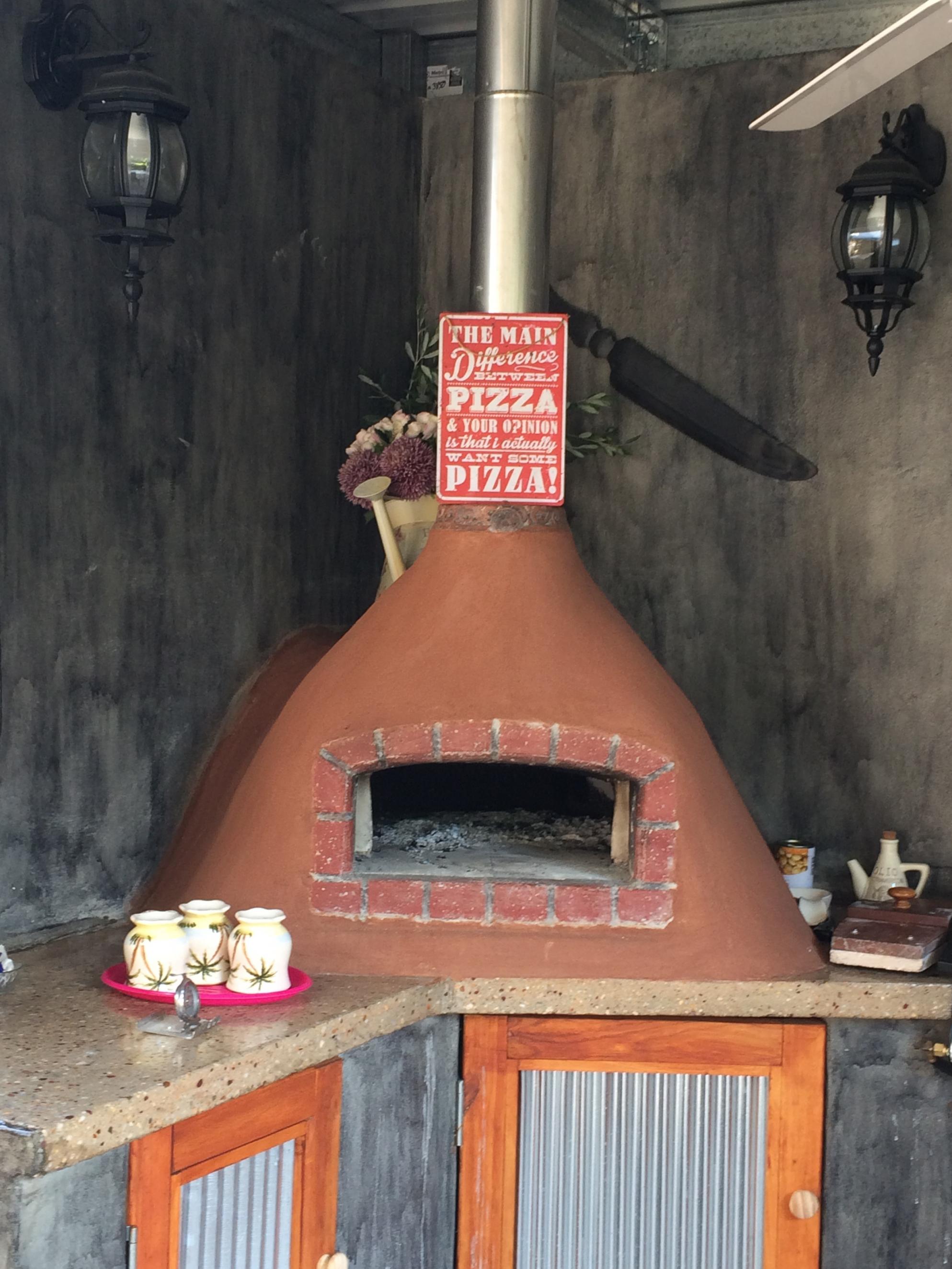

        If building an enclosure you already have two sides to work up to, but if building an igloo you have a back corner tha's extremely hard to work. Here's a solution using vermicrete. You just blend it into the wall on each side and fill in the back corner. Click image for larger version

          Yes. Existing concrete block walls. Access will be a problem. I don't think and enclosure is practical and was planning to finish as an igloo. Thanks for this example.
