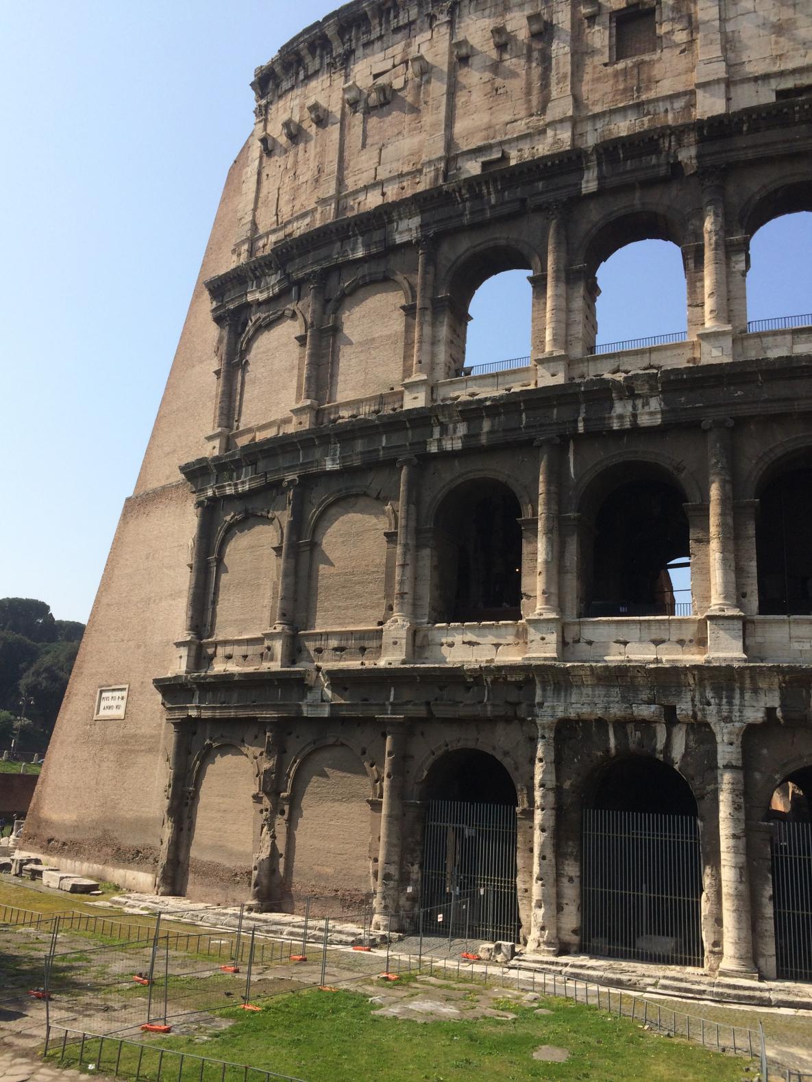

We were in Rome early last year and i noticed a great example of failing semicircular arches.The Colleseum has part of it collapsed and those arches that are not supporting each other progressively fail like dominoes. Zoom in and take a look at the arches on the end. The repairs done are an attempt to stop this chain reaction.
