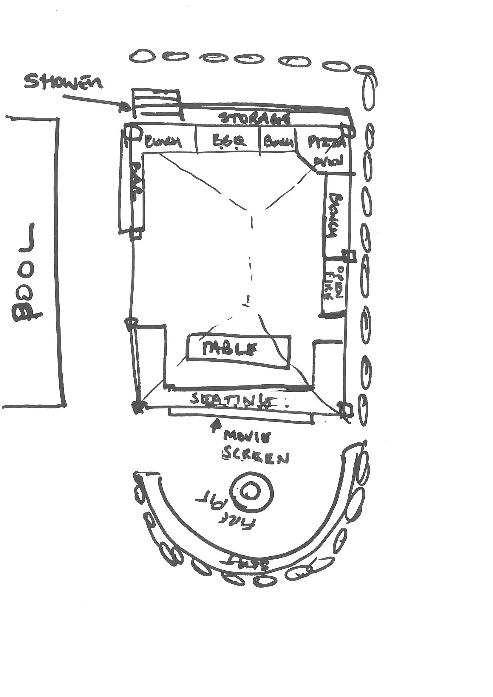

          Thanks Mike, you make some really good points here, i have thought about most of the things you have suggested.
          i have attached a pretty poor sketch of our layout so far.
          Cheers

            Wow! Quite a fabulous entertainment area! Two thoughts...1) make sure that your path bringing wood to the oven and the fireplace is wide enough to bring in a wheelbarrow (and easy to clean/sweep/vacuum)...since there will be a trail of wood debris ...and 2) make sure your fire pit isn't too big to make the movie difficult to watch . Also, have you thought about ash removal and tool storage?
            I think it's great that you have good space between the table and the oven...a crowd will want to gather behind you while you're working the oven. Be sure you leave enough space between the inner pavilion wall and the back of the completed oven. I didn't leave enough space and when I went to put up the last sheet of plywood, not only could I no longer "fit" behind the oven, I couldn't even use my drill (not enough space between the stand and the wall!) So, cleaning behind the oven is now with a long extension on my shop-vac

              Hi Mike,
              thank you, they are great tips. we did'nt even think about getting behind the oven! we deliberatley left a lot of space so we can put a very long table in the space for parties etc, the pavillion is 9 mtrs x 4.2 mtrs so i think we have plenty of space. we had already thought of the size of the fire pit, and technically its going to be a functional feature. you have opened up a can of worms in regards to access, speaker locations, wood stores, ash removal and storage, etc. i am going to have a chat to my stonemason for some ideas, and agree these do need to be thought of now, and not after the job id completed. so thank you very much for your input.

ID:	391519 Just to add to Mike's warning about proximity to the wall, you actually have way more of a problem when you put an oven in a corner. Working the outer layers of the oven down near the base of the dome gets really difficult if you can't get behind it. Also you are left with a pretty much unusable space in the corner behind the oven once it's finished. Depending on what your walls are made of you might like to consider blending the oven into the walls and fill the corner at the back with plastic bottles with their lids on and cover it in vermicrete. Attached pic is such a solution, but you have to look pretty close on the left hand side to see it.

                  Thanks David, That is a great idea! i think i will be surely be doing something along those lines. the corner was going to be open and it is accessible from the back, but i may build the corner wall in and seal the back anyways.

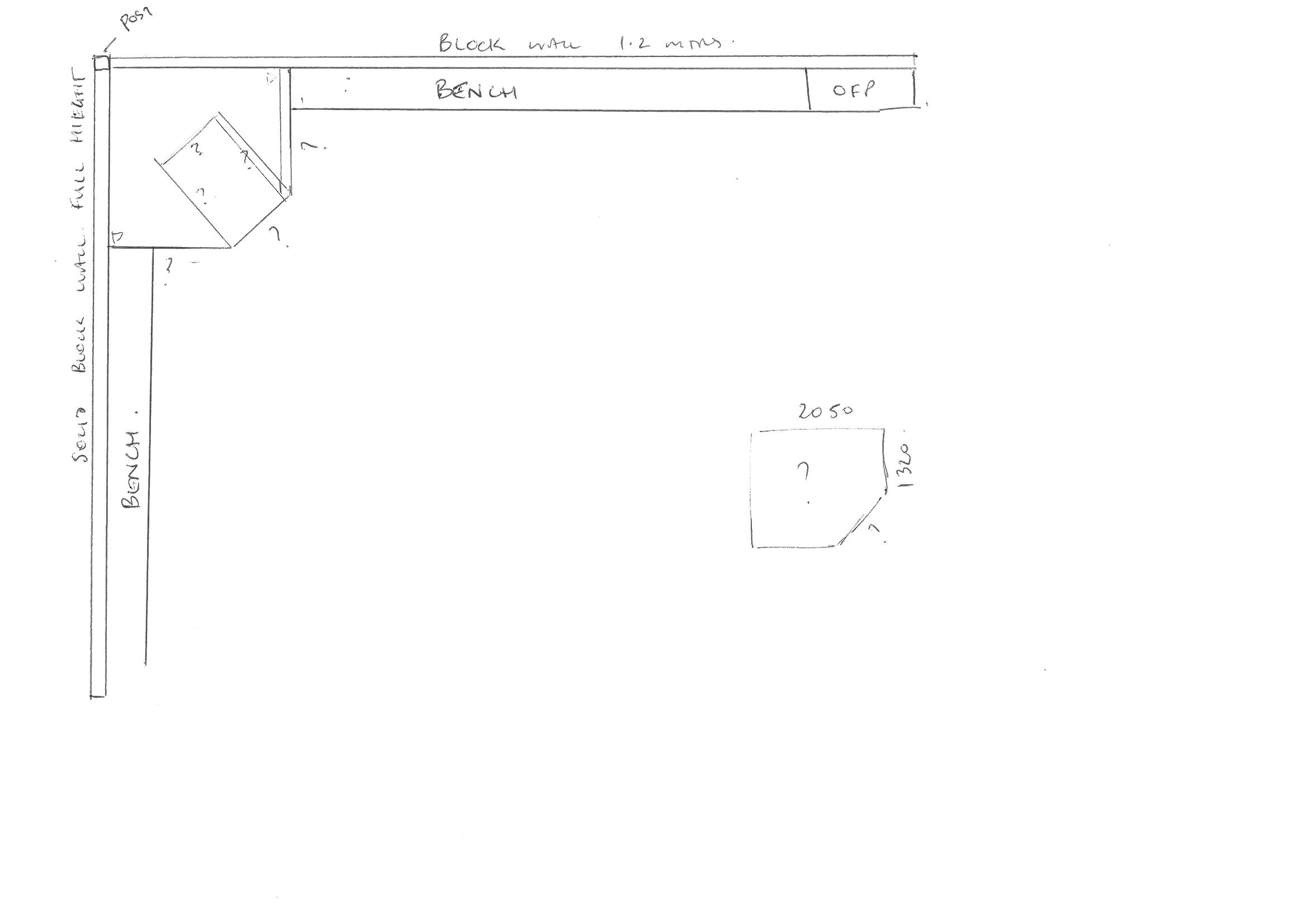

                      i am now going to start planning my slab layout for my oven.
                      couple of questions please. what is the optimum working height for my oven i was thinking somewhere between 1.2 and 1.4 mtrs.(4' and 4'8")
                      also i am doing a 200mm (8") Thick slab which will be level with my paving slabe and 20mm (3/4 Inch) tiles will go on top of this. and as it going to be in a corner and incorporate the retaining wall, and the post for my pergola structure in the corner (or maybe the sides?) i would like to know what i need to allow for as i am planning a 42" oven.
                      i was thinking of a slab dimension from the wall of 2050mm (80 and 3/4 Inches) across the back and 1320mm (52 inches) to the front as per the attached drawing; i would like to allow for cladding the oven in stone etc.
                      Am i leaving enough space for the oven and post.
                      any help would be appreciated
                      Cheers

                          George, optimum working height is a personal thing, but you don't want to have to bend over too far to see (and do peel work) deep into the oven and you don't want to lift up into the oven. Most of us have settled with a cooking floor height of about elbow height or slightly above (when standing). Try holding a peel (or just a stick) and imagine the motion of picking up the pizza and putting it into the oven. Your arms will "tell" you what feels like the right height. If you really want to get visual, cut a piece of cardboard out with what you are planning for your oven opening. Have someone hold it at various heights and again think about looking into the oven and placing the pizza onto the cooking floor using the cardboard mock-up.
                          Be aware that if you make it perfect height for yourself, your significant other or one of your friends might find it too tall or too low. It's important to make sure you add all the vertical components together to come up to the height you decide on--blocks, base slab, moisture barrier, insulation, sand/fireclay floor set, and the cooking floor itself. If you mortar instead of dry stack the blocks, it adds 1/4" for each joint...mortar 4 blocks on top of each other and to the foundation and it's an extra inch to your final height...
                          As to your total dimensions for a 42" oven using half firebricks (4.5") and say 4" of dome insulation, it would be 42+(4.5x2)+(4x2) = 59" without any outside stone cladding. Add an inch or so for a cladding base and 2" for the stone cladding and you are looking at 59 + 2 + 4 = 65" diameter of your finished dome. But of course you will need to have some additional working space outside of that to get between the oven and the pergola post. So, your projected 52" to the front might be too tight (although I might be reading your drawing incorrectly). I hope that helps at least to give you some basic thoughts/guide on the placement.

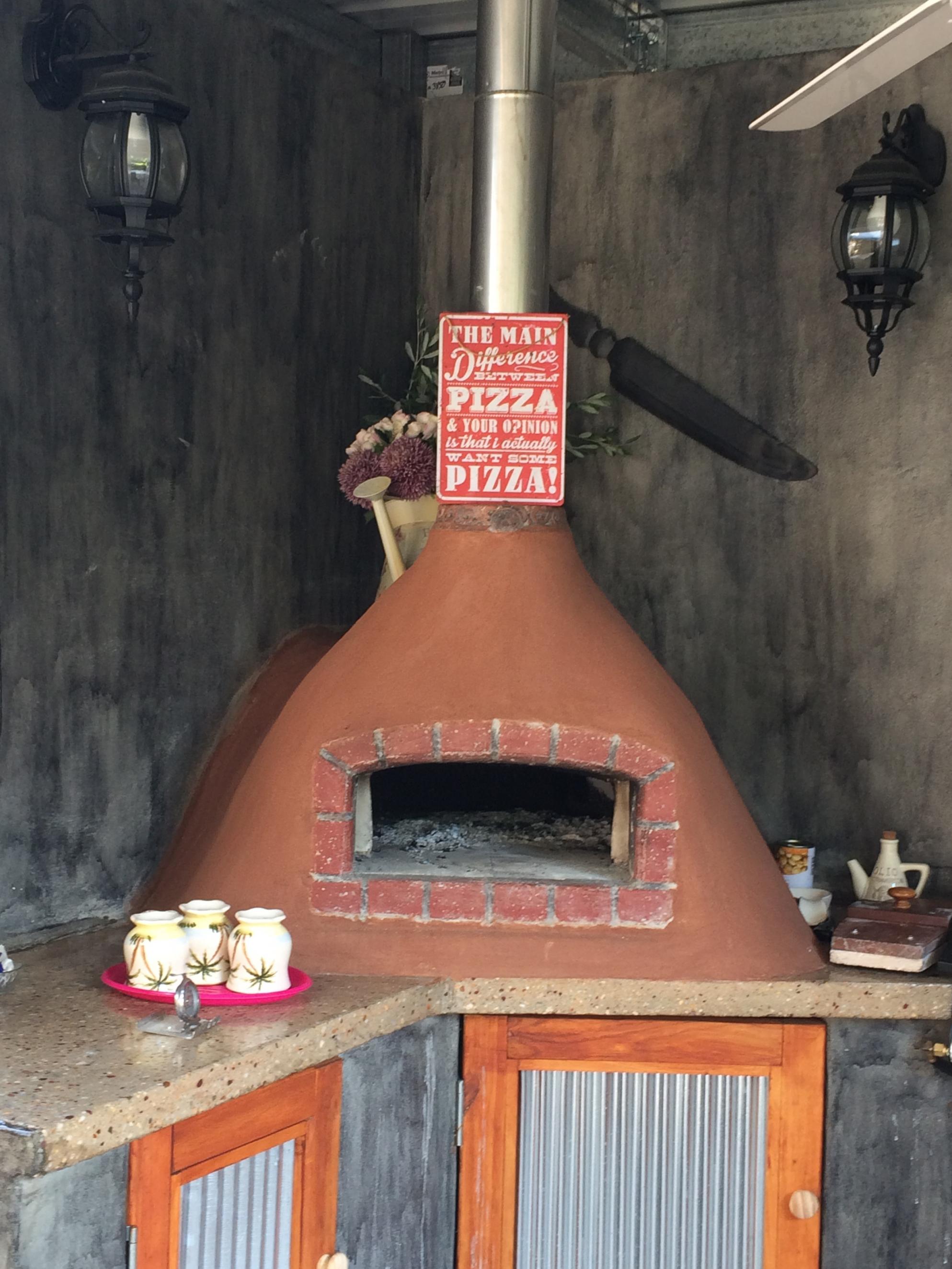

                            #14
                            so here are some pics of the build. all finished.
                            • shelbyright
                              • Aug 2016
                              • 17
                              #15
                              here are some more
