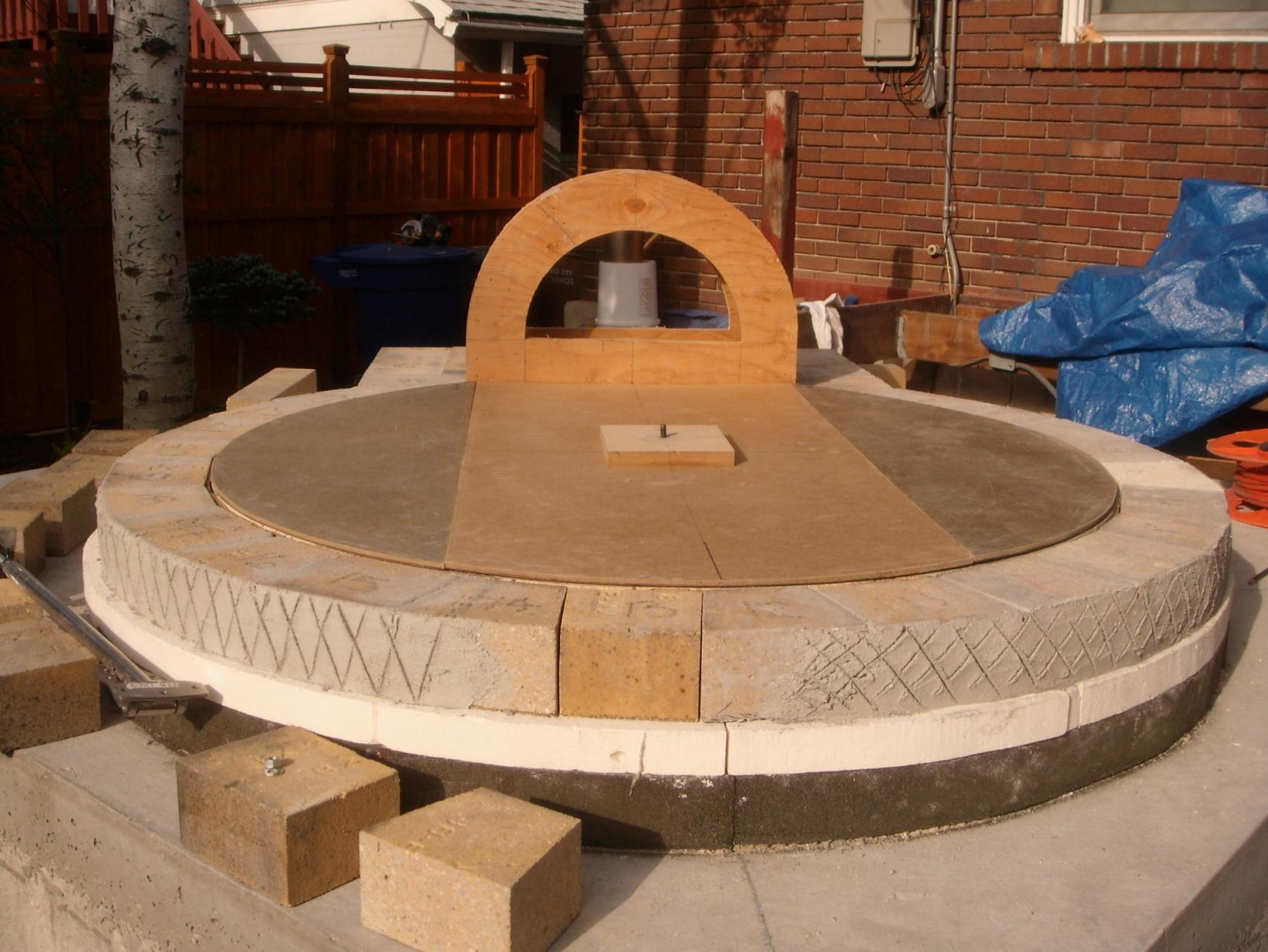

                      My IT. Any obvious faults or flaws any one of you more experienced builders see? It is set so the senter of the brick vil be at a direct line to the piovet point.
                        Just be aware that since the IT is off the floor elevation by the thickness of the ply and the distance to the center of the caster it will affect the dome height by this distance. Not a real big deal but it is something you need to be aware of and will need to make adjustments especially if you are doing a tapered inner arch, the IT use to mark the various bricks will be off. With the current design, there is no way to make length adjustments (shorter or longer) which really comes in handy when doing the dome. Nice start.
                        PS run some blue painters tape along the edge of the ply and the soldiers to keep mortar from dropping in the expansion gap between the floor and the soldiers. There have been some reports of the gap filling up with mortar and the floor has no where to expand and causes some dome cracking.

                          Thanks. Was planning to tape the edge, before building on, as I often am a bit sloppy and messy :-)
                          . I'm planning on using deejayoh's dome design spreadsheet, for cutting bricks, så I had to revise the IT, and get the piovet point below the soldiers. Still static length, though (Except for a few mm I can lengthen or shorten by adding washers behind the angel Iron.)
                          Tapered inner arch? Havn't really conciddered that yet, taking one step at the time and solving problems as they come.
