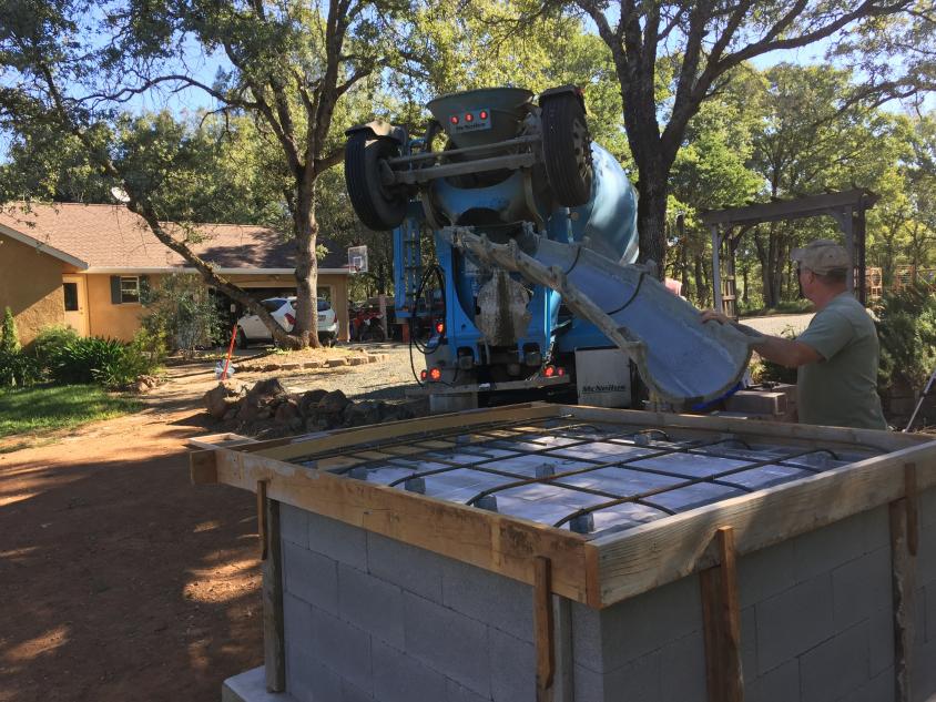

    Looking for Fire Clay. In order to level my oven floor, I will need to mix sand and fireclay according to FB instructions. Finding fireclay seems a bit challenging as I do not need a 50lb bag. Any suggestions would be awesome. My location is Northern California. Building a 42" oven. Click image for larger version
