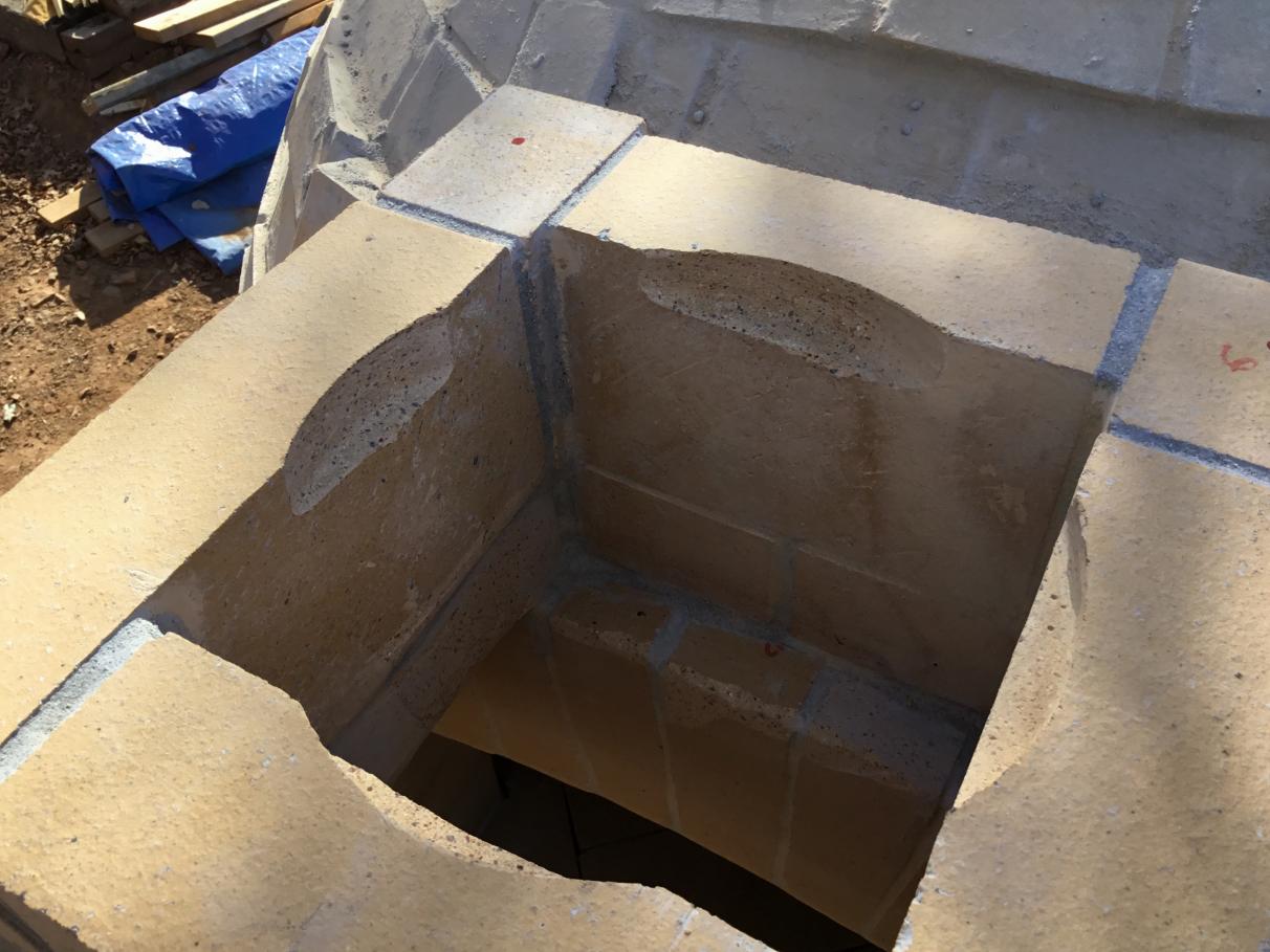

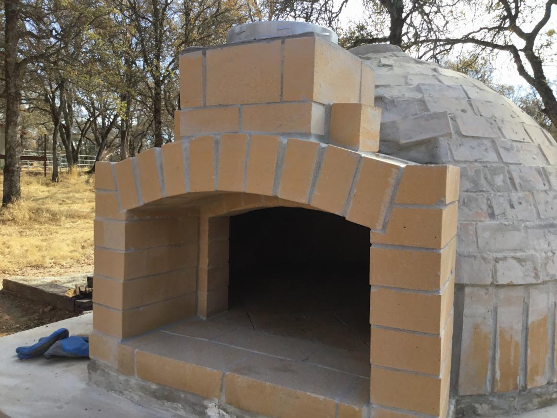

    If you look at Ken's arch the top of his opening is almost 5 brick widths wide versa 3 brick wide for your build. Even though your the opening is wider underneath up top it is still a restriction point. Changing it is up to you. Just pointing out potential smoking issues.
      #17
      providing you have some decent funnelling below the restriction you will be fine. It is the cross sectional area combined with the height of the flue which gives it the drawing power. A small restriction no greater than around 25% of the flue will simply act as a Venturi and smoke will actually accelerate at that point. It would help if you can knock off the sharp edges at both the entry and exit of the restrictionto create a smoother flow.
        #18
        You have a couple options now with David's suggestion.
          #19

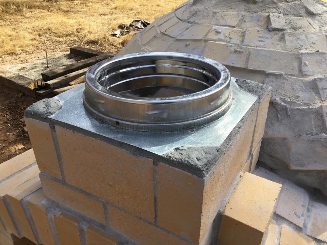

                    I cannot figure out how to post a new topic so I will ask here. What material should I use to attach my vent anchor plate to the chimney? I was going to order Utahs hi temp stuff but did not want to pay $50 a tube. Good substitute? Thank you all. I am really happy with how it's coming along! Thank you all for your advice!

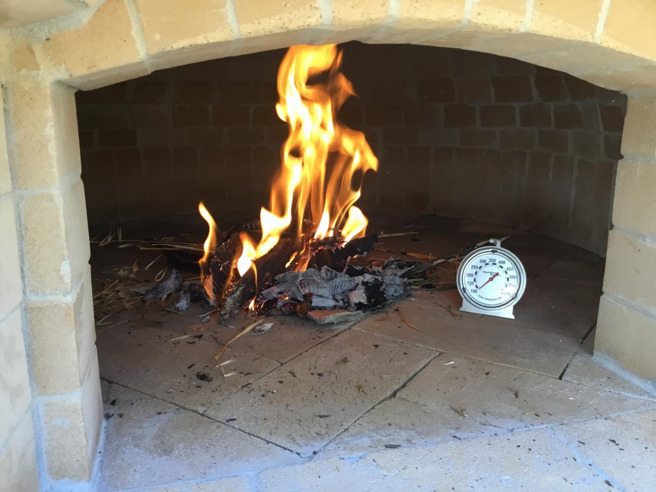

ID:	409435 My vent anchor setting. First Fire!!!!!! All neighbors came to celebrate!!! I must say (pardon the double entendre) a woman is only as good as her man's tools!!!!!! Thank goodness my husband saved me! The anchor plate screws would not go in! Ahhh!! Mortar set and in a panic I ran to get my husband. You guys really are amazing with tools!! Smoke going up vent but wish I had made bigger. We shall see once pipe is on. Insulating blanket 3-4 inches. Starting enclosure tomorrow! This is crazy! Haven't ridden my horse in a month! Ready to be done. Looking forward to cooking turkey in my oven for Thanksgiving! Working on door too. Wow!!

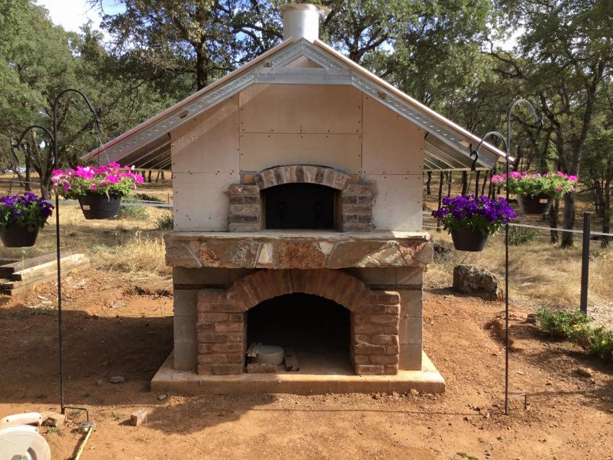

                        No problems with venting! Yay. Here is my progress so far!

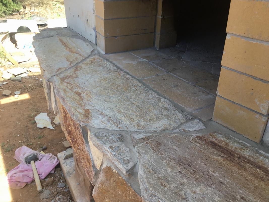

ID:	414945 I am working on completing the decorative and last arch! Whew! Placing flagstone too! No cracks in the oven. Pizza and chicken are fantastic but can't wait to try caveman style steaks!
