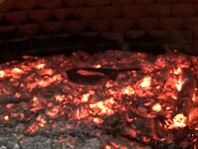

                I would like to show photos of the progress. The photos on my iPhone will not upload because they are too large. It says that they exceed the limited size. What is the best way to show you guys my progress?
                • #9
                  • #10
                    Try using the Upload Attachments button below. Select Photo Library. Now select the photo that you want to appear in the post. At the bottom of the screen should be a Choose Image Size option. Selcct Medium. Then selct the back to All Photos at the top of the page.That should have changed the photo size to under 100 mbs. Now select Done at the top of the page. When the Thumbnail appears, select Medium again.
