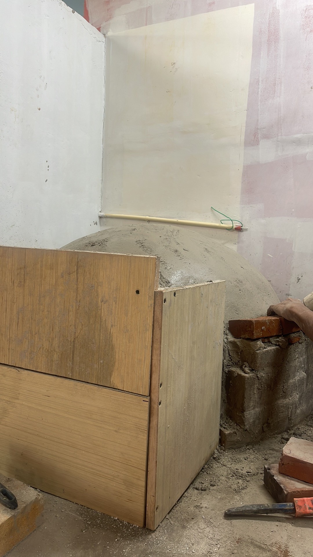

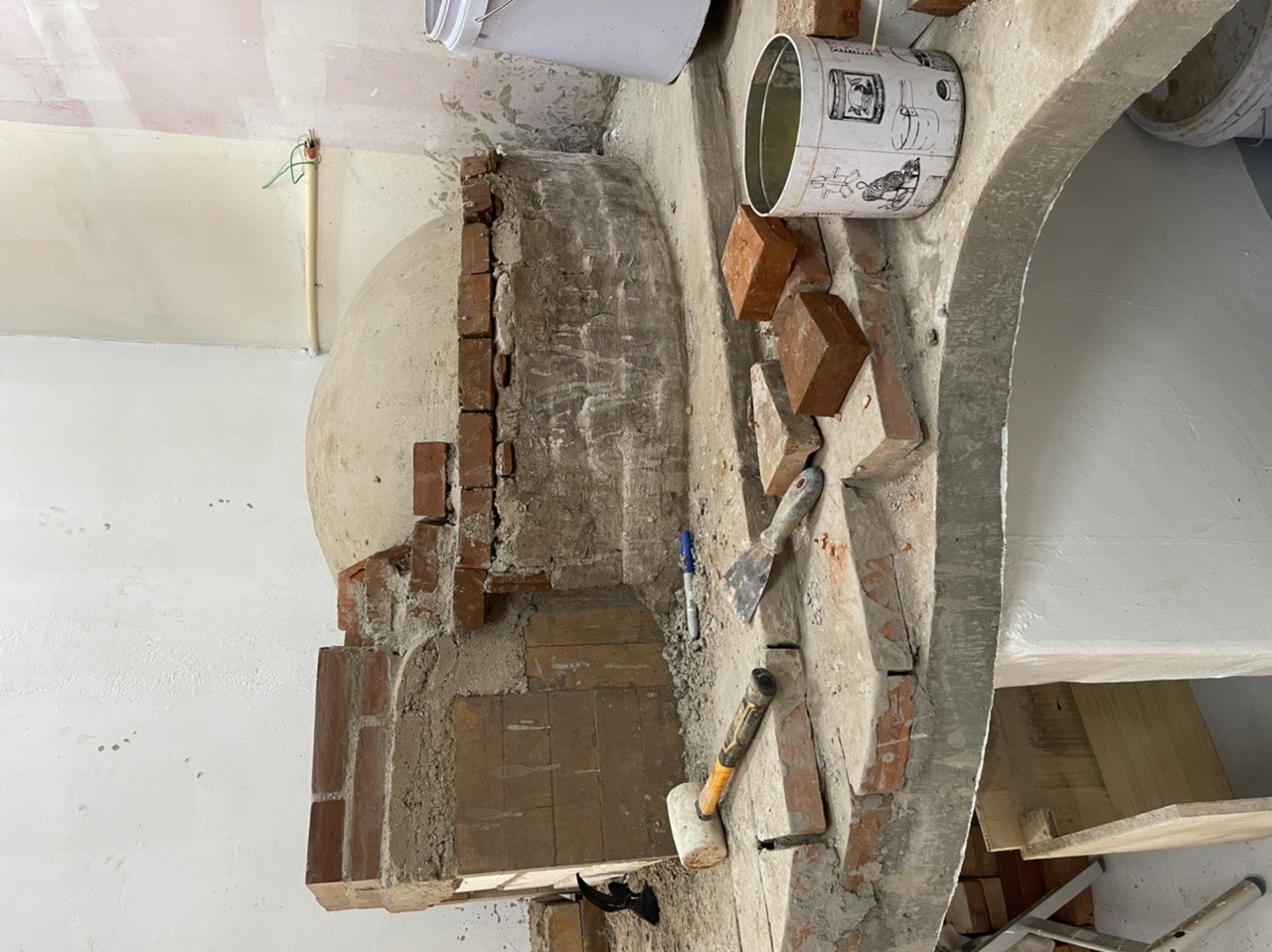

            Hey peeps, just a follow up. We are halfway through our build, mostly orchestrated by my husband. I’m so confused on the type of build they have made but it looks like it’s going well. Okay, just to summarize the oven components:
            1) oven floor is
            inner: 30%cement 70% pumice
            actual oven flooring: refractory bricks and wet mortar
            2) dome:
            Side base is refractory bricks with castable
            Upper bricks: red bricks with castable
            Inside dome layer: 3” castable Brand:BST 13ES
            middle dome layer: 1” castable Brand: BST 13LW
            Outer dome layer: 1” red clay bricks with 13ES castable
            crossing my fingers that this build will require minimal fixes

              • 9211
              How thick is your pumice insulation mix under the cooking floor and how thick are the cooking floor bricks? Generally the thickness of the cooking floor bricks is about the same as the thickness of the dome walls.
              Do you have any insulation over the dome?
              • raechelle
                • Oct 2021
                • 6
                pumice insulation mix - 3 inches + 1-2 inches of wet mortar and castable on top
                cooking floor - is 2.5 refractory bricks binded by wet mortar and castable
                ok, now I got more clarification about the dome. So here are the layers
                innermost dome: 13ES castable around 2 inches thick
                Middle layer dome: 13Light weight castable around 1-2 inches think
                outer layer: 2 inches red brick
                outermost layer: will be covered by another 1/2 upto inch layer of lightweight castable
                Did what I write made sense or not?
                my husband decided not to put an insulating blanket as the light weight castable is the substitute for that.
                I’m crossing everything that can be crossed in my body that this will work and not just crumble right before our eyes!

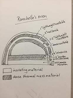

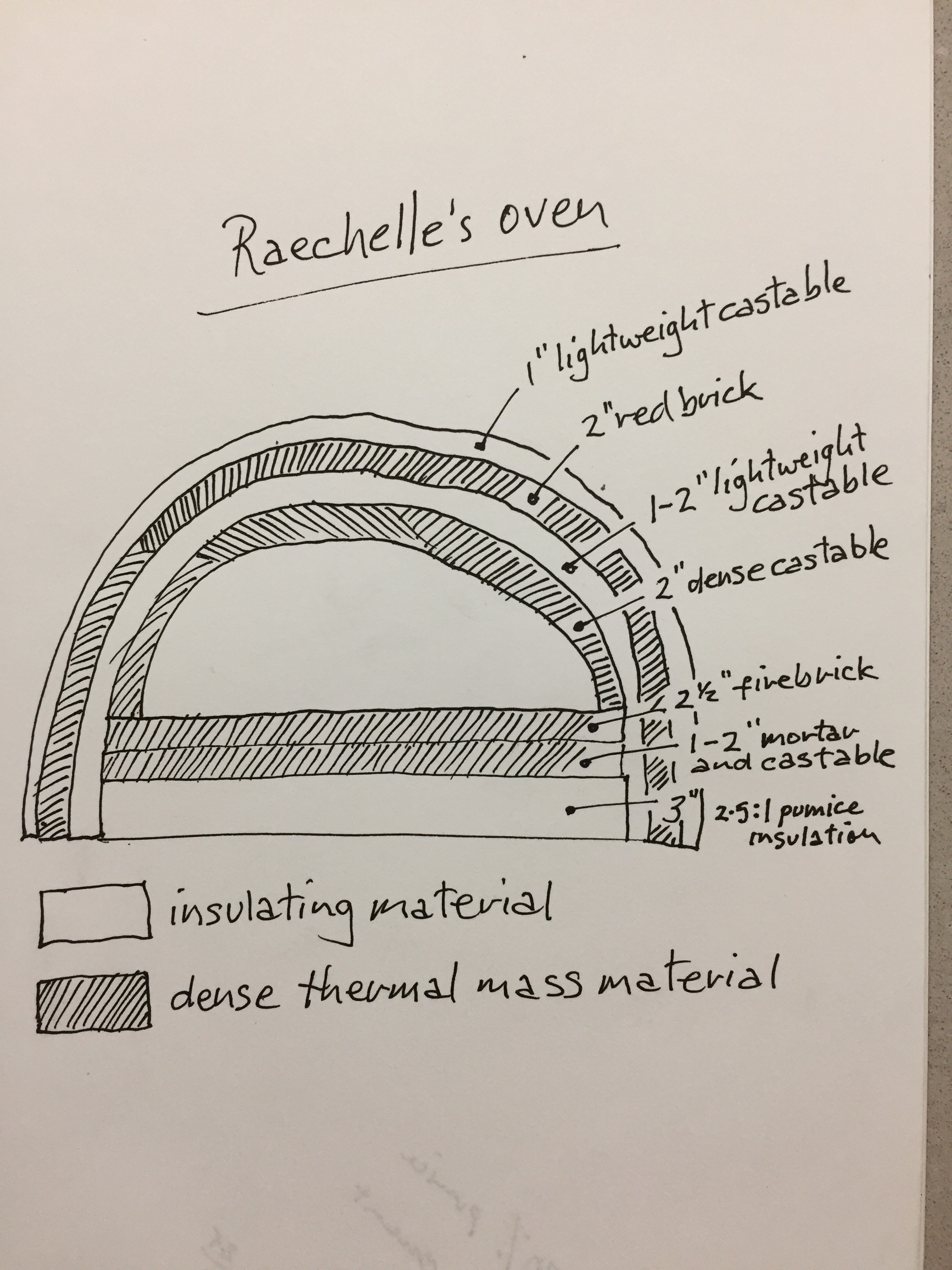

                    Hi Raechelle,
                    Here is a rough drawing from the interpretation of your explanation.(correct me if I'm wrong)
                    Firstly your underfloor insulation with your 70% pumice 30% cement equates to a 2.5:1 vermiculite:cement mix. The pumice is approximately (slightly denser than vermiculite) the same as vermiculite (see table for resulting insulation values. Most builders would use a 4" of 5:1 vermicrete to achieve good insulation with enough strength to support the weight on top of it. So it appears you probably don't have enough insulation under the floor, 2.5:1 is about 1/2 as insulating as a 5:1 mix, and you only have 3" of it, but don't worry, it will work.
                    2.5" firebrick sitting on 1-2" dense castable and mortar gives you a pretty thick dense thermal mass for the floor.
                    2" of dense castable for the inner dome is standard and provides sufficient thermal mass as well as the required strength.
                    1-2" of lightweight castable is very minimal insulation for the dome, most builders would use around 4" of over the dome insulation. Not sure of the insulating value of your insulating castable (you could check that against that of insulating blanket.
                    The 2" red brick layer is not an insulator, but a conductor, insulating over it will help hold in its heat once the bricks have heated up.
                    It appears that you have a 4" x 4' (16 square inches) for your flue. Not knowing what the internal size of your oven is, it is hard to say if it's adequate, but ovens up to 28" internal diameter require a 5" diameter round flue pipe (20 square inches), up to 36" internal diameter ovens require a 6" diameter flue pipe (28 sq inches) and ovens over 36 internal diameter 8" pipe (50 sq inches)
                    The chimney can be brick, but if you use a pipe, make sure it's stainless or you'll have to replace it after several years use.
                    Dave
                      Hi Raechelle,
                      Dave
                      Click image for larger version Name:	image_83170.jpg Views:	0 Size:	146.2 KB ID:	443783
                      Click image for larger version Name:	IMG_1991.jpg Views:	0 Size:	1.22 MB ID:	443784
                      Wow, it’s so amazing that you were able to draw it accurately!
                      and yes, the flue is about 50-52 sq inches.
