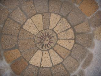

        Lots of folks end up with strange shapes at the top of their ovens. I ended up with a seven sided plug- see link below. You could hold a piece of cardboard up against the ID of the hole and trace the shape, then transfer that onto a plug. Might take a few pieces. Just don't do like I did and make the fit too tight. A light tap and I knocked some flakes from the adjacent bricks.

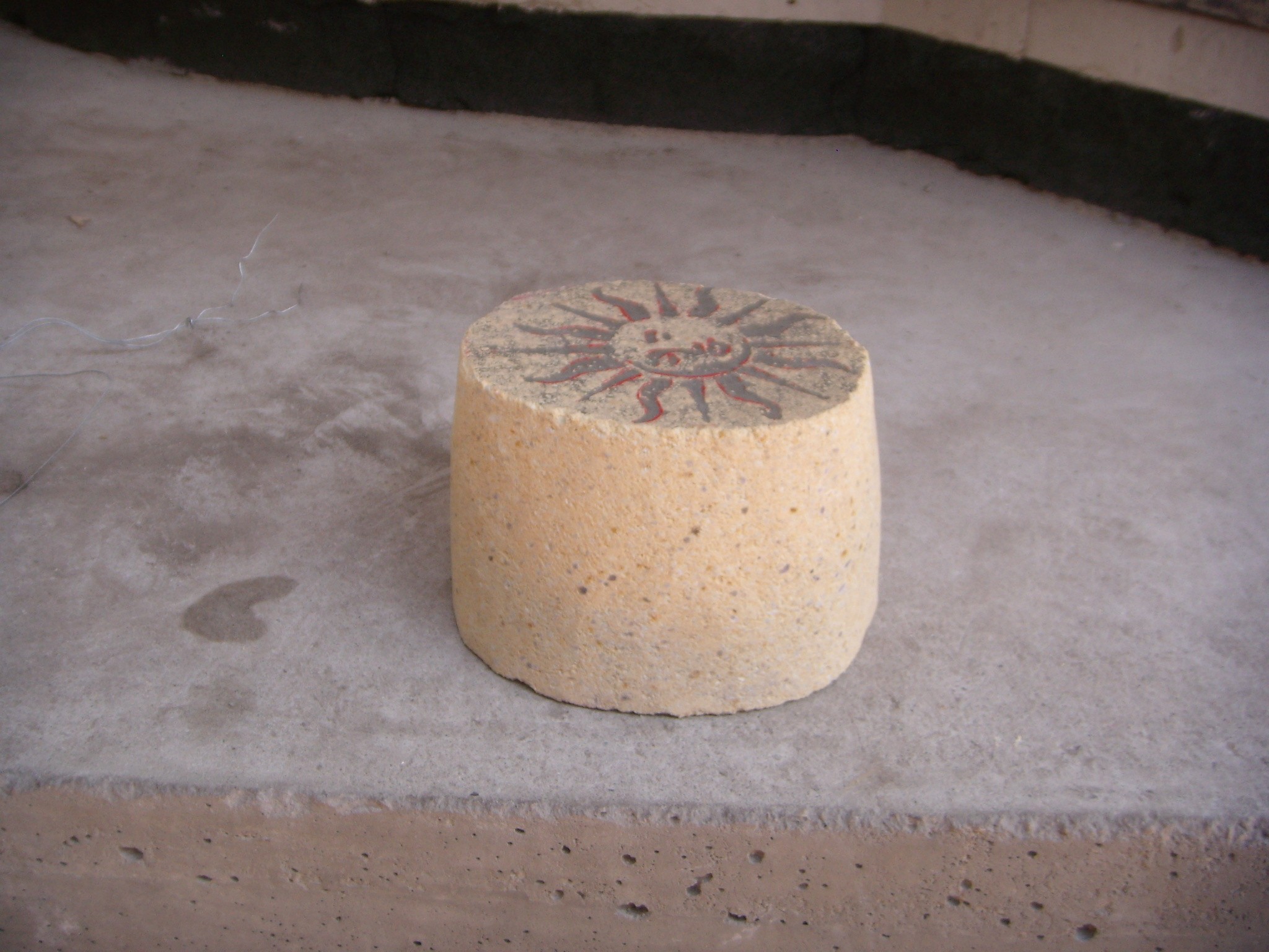

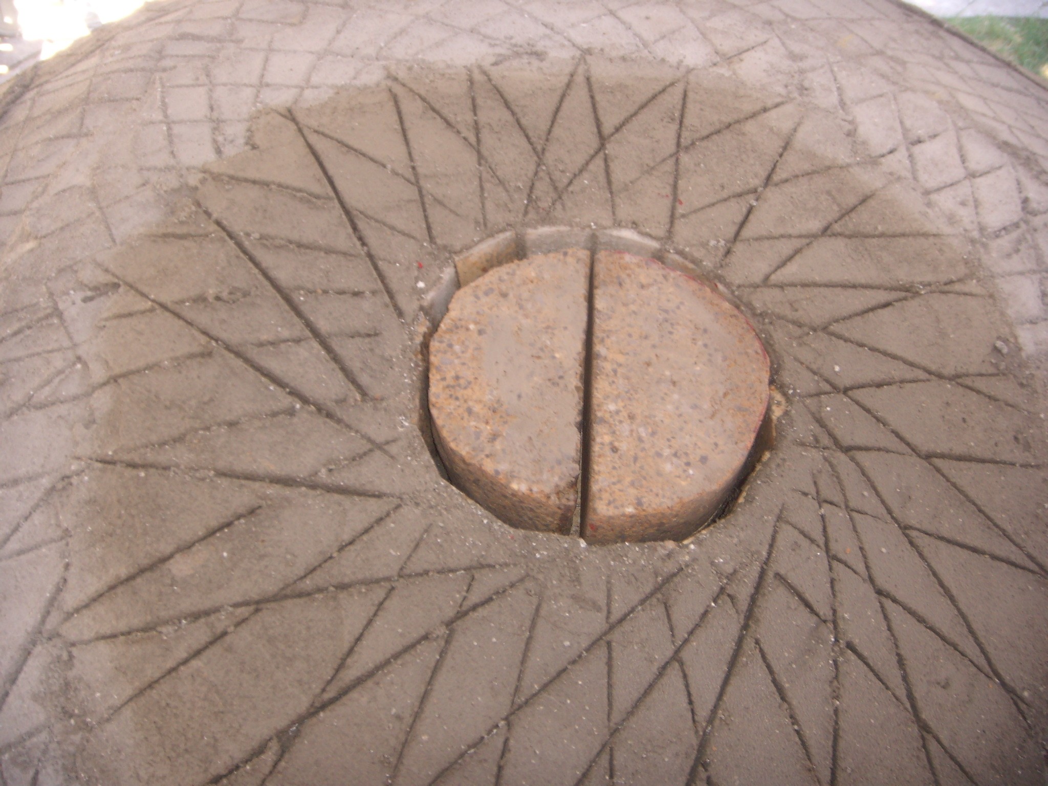

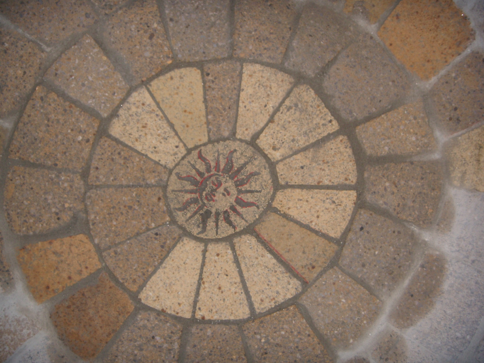

ID:	443758 I does not have to be one brick, my plug was three pieces, the lower or internal one piece the upper or outside was two pieces. So speaking of being impatient. Do step back and take a deep breath. It is later part of the builds the builders get in a hurry, wanting to get the project completed, This especially true when curing the oven. Take your time.
                . Click image for larger version
Name:	54F Plugging the Dome 8.11.12.JPG
