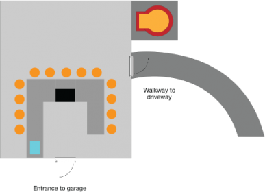

      I'm struggling with the idea of cutting the slab. I have access to a walk-behind saw, but I think that I have decided to place the oven on the side of the pad. The oven would be brick-walled, and it will have a gable roof (if we go this route). Here is a rough drawing of the location.
      I will start a build thread once we are sure of the location. I look forward to sharing my struggles (and I hope a few successes as well).

        Miles,
        I think that is a good idea for the oven location. Where will the fireplace be located?

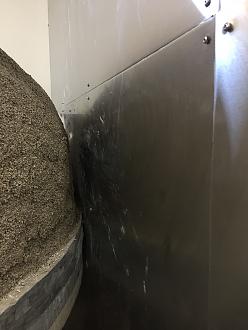

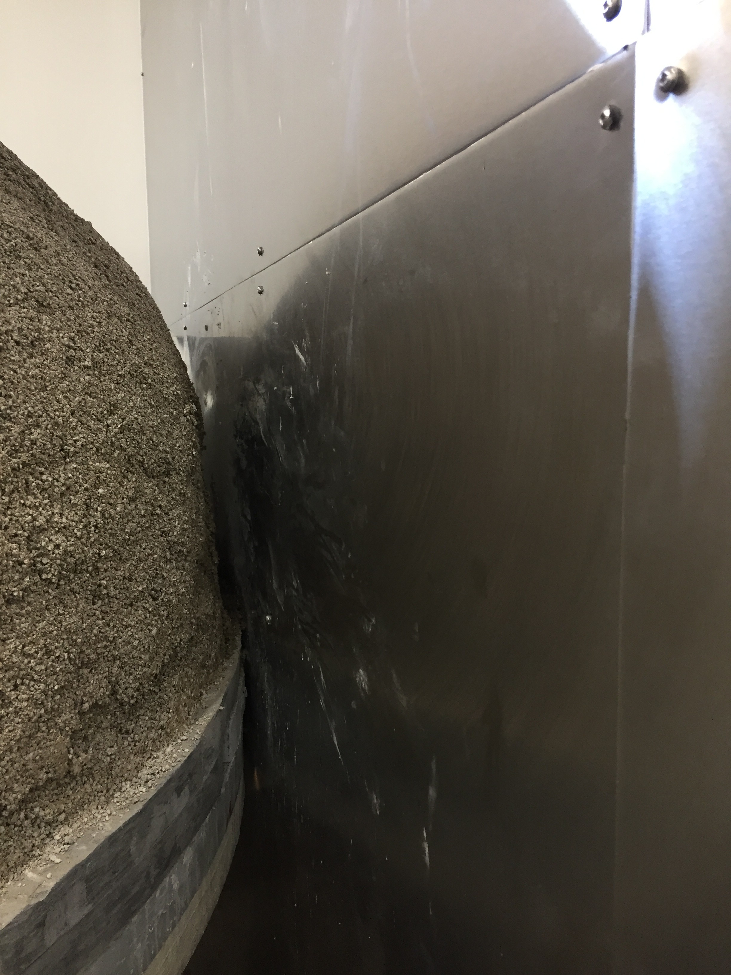

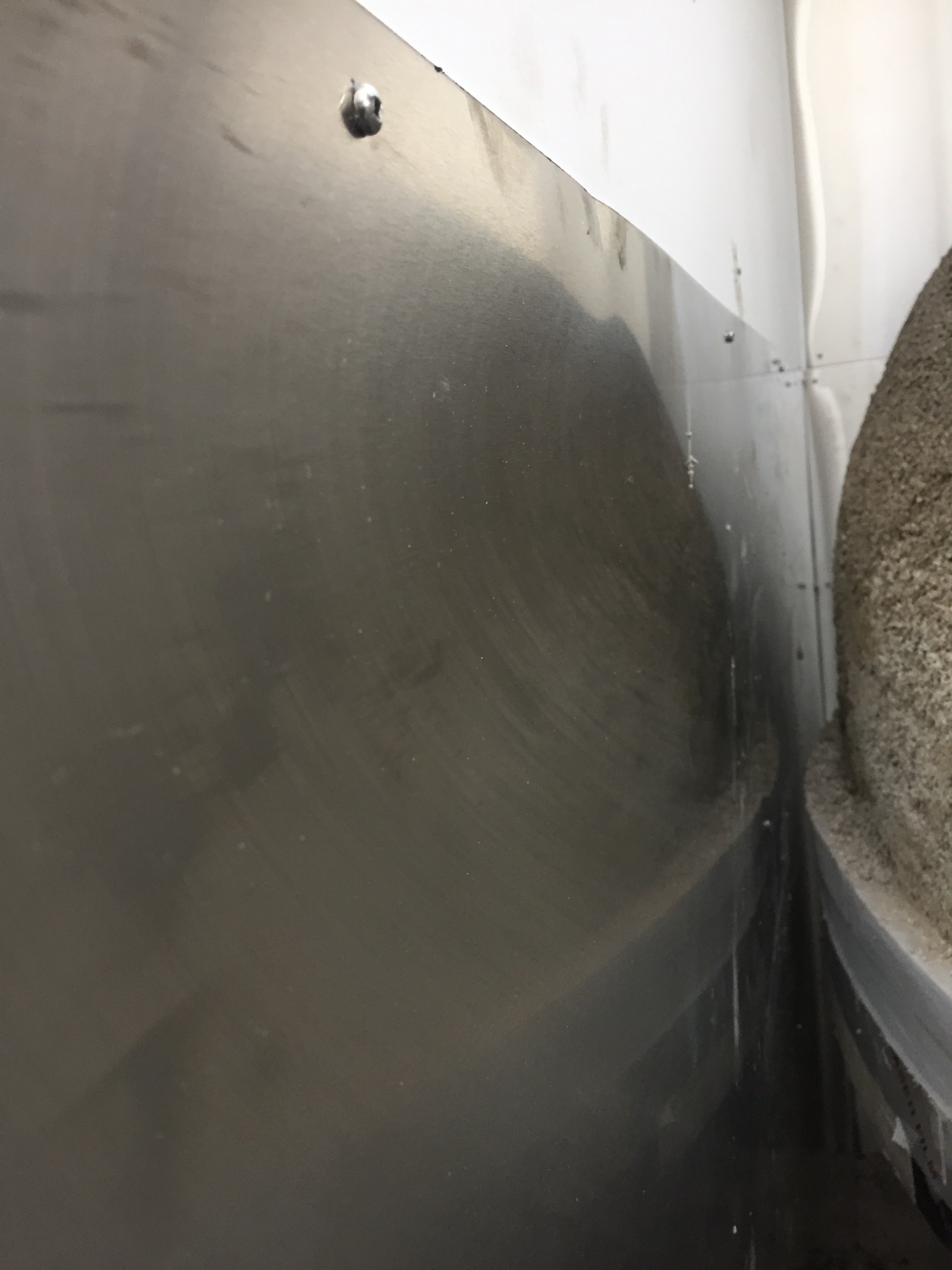

          Give plenty of thought before attempting a corner build. With two walls to cope with, it makes applying the outer layers really difficult, especially when your customer jams the supporting slab hard up against the wall.
          The only way I could access this oven at the rear was to crawl under the stand and squeeze into the tiny space in the corner. With hardly any room to move I had to apply the vermicrete in single handfuls which necessitated squatting down to the bucket at my feet and standing again. I have done hundreds of squats in the last few days and my quads are killing me.

            Gulf,
            The plan would be to put the fireplace at the end of the pad (across from the door to the garage). We would pour a pad for the fireplace, and the hearth would be on the current slab. I️ am toying with the idea of building a heat chamber (much like a steel fireplace insert except with brick) behind the firebrick and adding a fan system. Lots to think about there…
            Do you think working the oven would be too tight in that corner after the roof and screen walls are added? I’ve never loaded, turned, unloaded, or cleaned an oven with long handle tools.
            If we place the oven there, I️ think we will do a squirrel tail chimney. I️ need to research to see how much weight the dome can handle. I’d like to do a brick chimney.

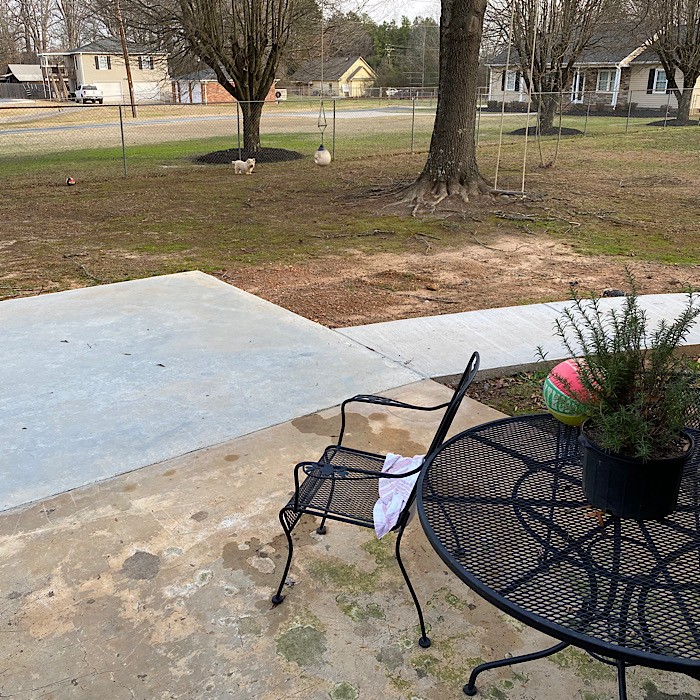

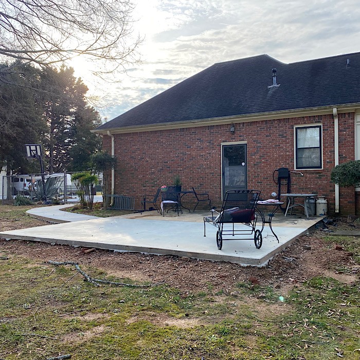

ID:	444014 Here are a few pictures of the patio and proposed oven location.
