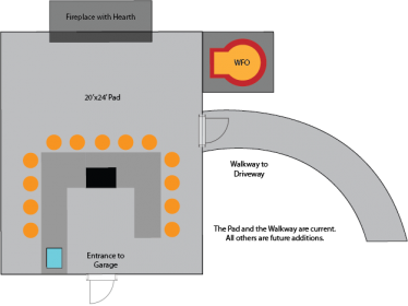

    I will place a rough drawing below to explain the layout. The serving area location is still up in the air as well. We may shift it to the wall adjacent to the WFO. This will depend on the oven/range/griddle combo that we end up with. The serving area will be attached to the wall with the door leading to the garage. This is where I have water, gas, and a drain line currently.

    The plan would be to put the fireplace at the end of the pad (across from the door to the garage). We would pour a pad for the fireplace, and the hearth would be on the current slab. I️ am toying with the idea of building a heat chamber (much like a steel fireplace insert except with brick) behind the firebrick and adding a fan system. Lots to think about there…
    I have found with my outdoor fireplace that you can't heat an area. I have a tall "Rumford style" so I can throw out the radiant heat to back folks up. but, if it is very cold, they are still cold on the other side. On very cold days it has been fun to watch folks turn like they are on a rotisserie. Or someone will say "somebody's done" . I have found that the fireplace works very well for ambience on cool days and evenings. The blower may help some?
    Do you think working the oven would be too tight in that corner after the roof and screen walls are added? I’ve never loaded, turned, unloaded, or cleaned an oven with long handle tools.
    Before you pour concrete footers and slabs for you oven and fireplace, my advice is to draw full scale drawings (templates) for your oven and fireplace. Include all the dimensions for their foot prints. And include the thickness of your side walls and screening. From that you will know what room you have in "the real world" to adjust your forms.

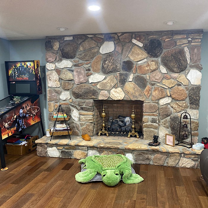

      Thanks for the reply. I️ will work on a to scale drawing…at least for the oven and pad. We haven’t fully decided on the fireplace dimensions, The fireplace in our living room is 10’ wide (pic attached). The 93 year old gentleman that we bought the house from collected these rocks and built the fireplace himself when the house was built in 1985. The hearth is a little low, but we like that we can fit several people on it during our Bible studies. We are leaning towards a 3’/4’/3’ (wood storage, firebox, wood storage) for the outdoor fireplace.

        Beautiful fireplace! The oven that I mentioned in your introduction thread will have a heavy duty drawer style trolley that will be installed in the oven's wood storage. It can be loaded from outside the screen room and unloaded from inside. It will service the oven and the fireplace. The guides and rollers for it will be fabricated from used garage door rails and new nylon rollers.

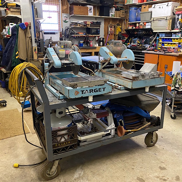

                  I had planned to buy a HF 10” wet saw, but I️ looked a FB MarketPlace and found what I️ hope is a deal. The guy wouldn’t split the saw package up, so I️ ended up with 2 Target 10” saws and a MK770 7” saw for $175. All 3 work well. I️ will attach a couple of pictures below. Excuse the messy shop.
                  I will try the blades that are on the saws, but if someone has a suggestion on a different blade, I️’m all ears.

                    That most probably a Great score on the wet saws! No advice on the blades at this time other than RTF. They may be quality blades and get you through your project. You may also be joining me and Russell UtahBeehiver in the forum scrounger club!
                      • 5261
                      Looks like you did good on the saws. You will use the 10 inches a majority of the time and with two you a good backup part supply. I preferred segmented blades because they were more aggressive in cutting yet you could still feather with sides of blade.

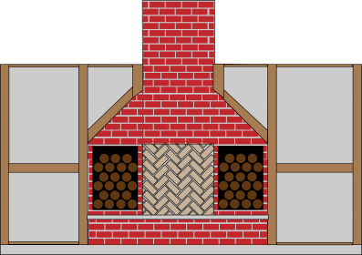

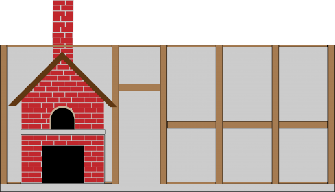

                        I will add a couple of elevation drawings (not totally to scale...especially the brick). I hope this gives an idea of what the plan is.
                        The oven template should be finished soon. After that, we need to acquire the rebar, and we will pour the base.

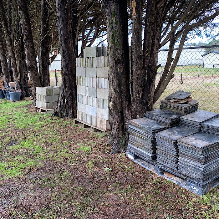

                            We had hoped to use slate tiles for the roof of the doghouse, but the sticker shock had me planning asphalt or metal. Last week, I️ ran across a deal on some old blue slate tiles. I️ had to take them all, way too many for this build, but I️ have less in all of the slate tiles than I️ would have spent for either of the other alternatives. I️ will post a picture below.
                            With being blessed with two saws, I️ thought it wise to set up a brick cutting station. I️ have a large rolling cart from an old junk deal, so the plan is to have both saws set up side by side on the cart. I️ still need to build the jig, but the thought is to use one saw for straight cuts and the other for angled cuts, All of this planning may fly out the window once the build starts. I️ have fabricated rubber washers and nylon spacers to allow some plumbing fittings that I️ had to form a drain to five gallon buckets that will be housed on the lower shelf of the cart. I️ haven’t bolted the saws down yet, but I️ will post a picture of the progress.

                              Not sure what happened with the pics. Let’s try again.
ID:	444468 Click image for larger version
