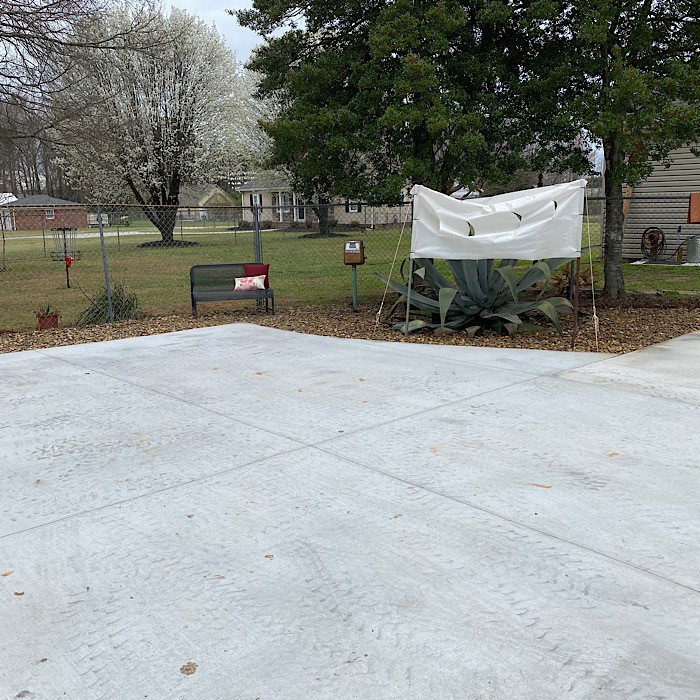

    No real progress on the oven this week. We had rain most of the week. We did finish up spreading roughly 9 yards of river rock on Friday. I had planned to pour concrete in the corner and center holes of the base yesterday, but the wind was high and the temps were steadily falling...and I was dragging from the rock on Friday. It dropped back down to 20 degrees last night. We are hoping to form the upper pad this week. With one running in college and one running in high school, the spring and the fall are loaded with meets.
    I'm glad to have the river rock job behind us. That is Elenor (one of our larger Century Plants) under the tarp. She is hoping to get out of jail next weekend. Ursula is another one of our Century Plants in the pot to the right. She is a little homely from neglect before we bought the house. Putting her in that pot was like wrestling an octopus with teeth on its tentacles.
    You can barely see the corner of the oven base peeking around the house in one of the pictures.
    I'm considering a rock finish on the oven like NCMan's build. I'd like to get opinions. Any thoughts on the rock walls connecting to the brick house. Really looking for thoughts on aesthetics.

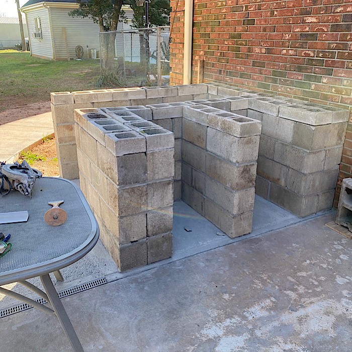

    We were able to finish laying the block this week. I️ decided To use the half block for the top row. We made a ton of dust cutting all of those blocks. King Roo, our 12 year old deaf Scottie has been hanging out with me as I️’m working on the oven. Even he left me when I️ started cutting the blocks.
    I️ shifted Gears today and pulled up a couple of large holly trees and put down 2.5 scoops of river rock before heading to a track meet.
    We have lots of rain forecasted this coming week. I️ ‘m hoping to get several of the holes filled with concrete and form the upper slab.

    Originally posted by Chach
    Very Nice! It won't matter much just be close and level the top of the structural slab. Use a Mason line to keep the same height it will help you keep yourself close to level. Build one corner to the desired height and use that as your guide to keep all the courses in check with the Mason line pulled tight and level with a line level on the Mason line.
    Ricky
    Thanks, Ricky. I have been using a line, but I'm not able to use a wooden block because one side on the base is up against the house. I built the wood stands (in the pictures) that I move about and adjust with screws to put the line at the correct height. I am also using a clamp to hold the string on the blocks that are against the wall of the house.
    We were able to lay a few more blocks last night. I'm hoping to be able to finish up with the block this week.

    Originally posted by Doodbird
    We were able to work on the oven Friday and part of the day Saturday. We have had rain several days over the past week or so.
    If I had to provide food and shelter by laying blocks, we would starve and freeze.
    As I cut the corner blocks in half, I split a block horizontally. It seemed to hold together well. I may go with the 4" cut block on top to get the height where we want it.
    We had about 1/2" to make up over the 80" run, so we are trying to add a 1/8" to each layer of mortar on the low side. A blind man riding by on horseback at night will never recognize my poor mortar joints. I'm glad these will be covered once the oven is complete.
    The half-block on the center row will be coming down. It was laid in a rush as the rain moved in. I should have laid a full block there. We are hoping to get more blocks laid each evening this week.
    Ricky
