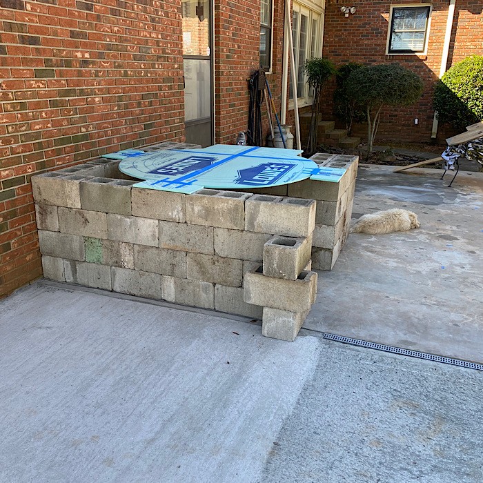

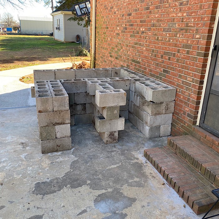

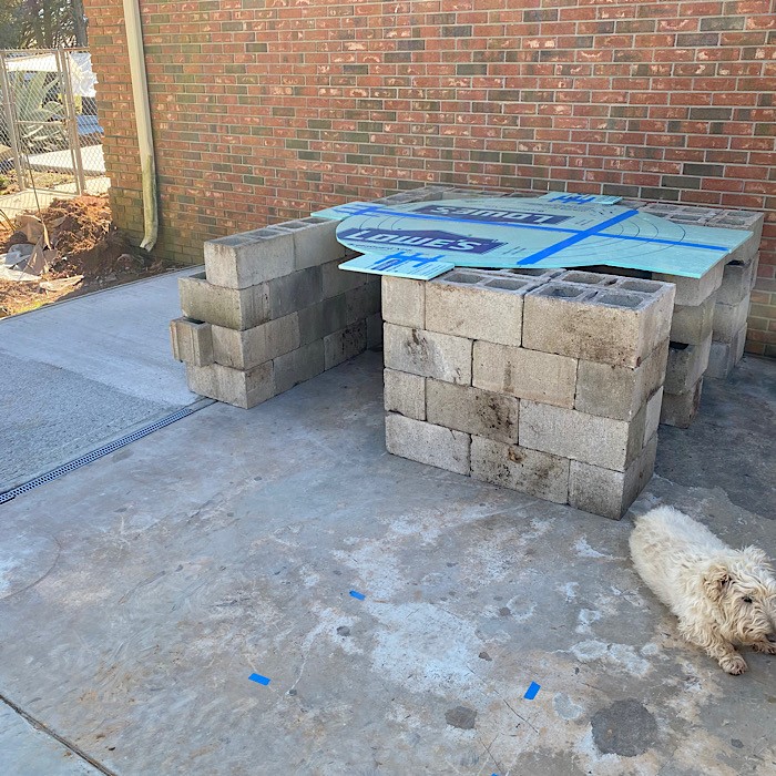

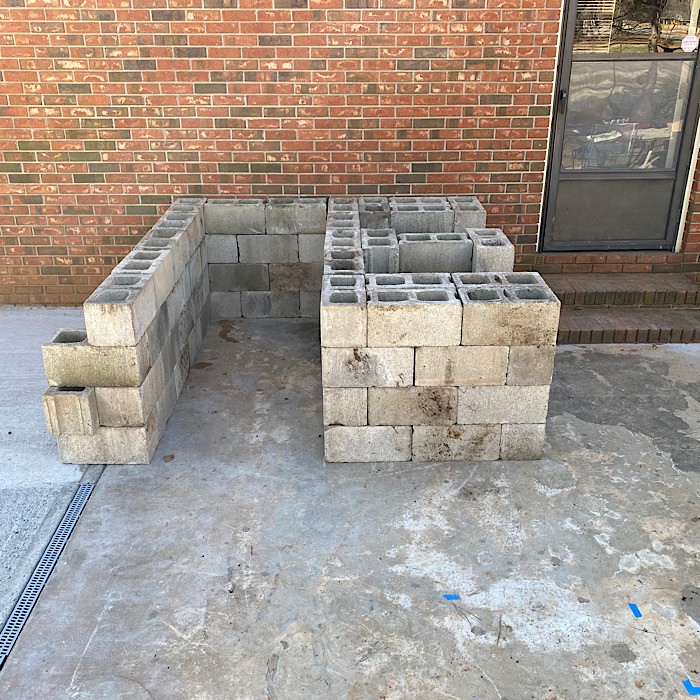

Dry stacked the base a couple of times today until I️ settled on 5 block square. I haven’t cut any half blocks yet, so I have some stacked sideways to get up to full height. We will have a long drawer on the side to store wood and two smaller drawers on the front to store tools.

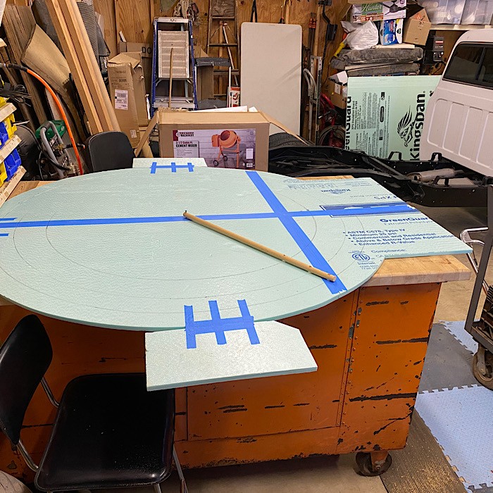

Worked on the template this afternoon. Unless these dimensions sound out of whack, I️ think I️ will go with 13” to 13.2” high and 20” wide on the oven opening. I️ don't have a picture of the updated template. I️ will try to get a picture tomorrow.

I don't envy you on building the right side of the dome. That is going to be a tight place to work. My back won't let me get on my knees to work anymore. Also, you will have to get very used to where that bottom step is when working the oven imo.Joe Watson " A year from now, you will wish that you had started today" My Build Album / My BuildComment
I️ should have mentioned that I️ dry stacked the block on the original pad. I️ wanted to give the new pad a few more days before I️ put weight on it.

Just to be clear, the oven will be built basically 7’ to the left (away from the door/steps) from where the photos show the dry stack. This stack was both a test layout and getting the block close to where I️ need them.
