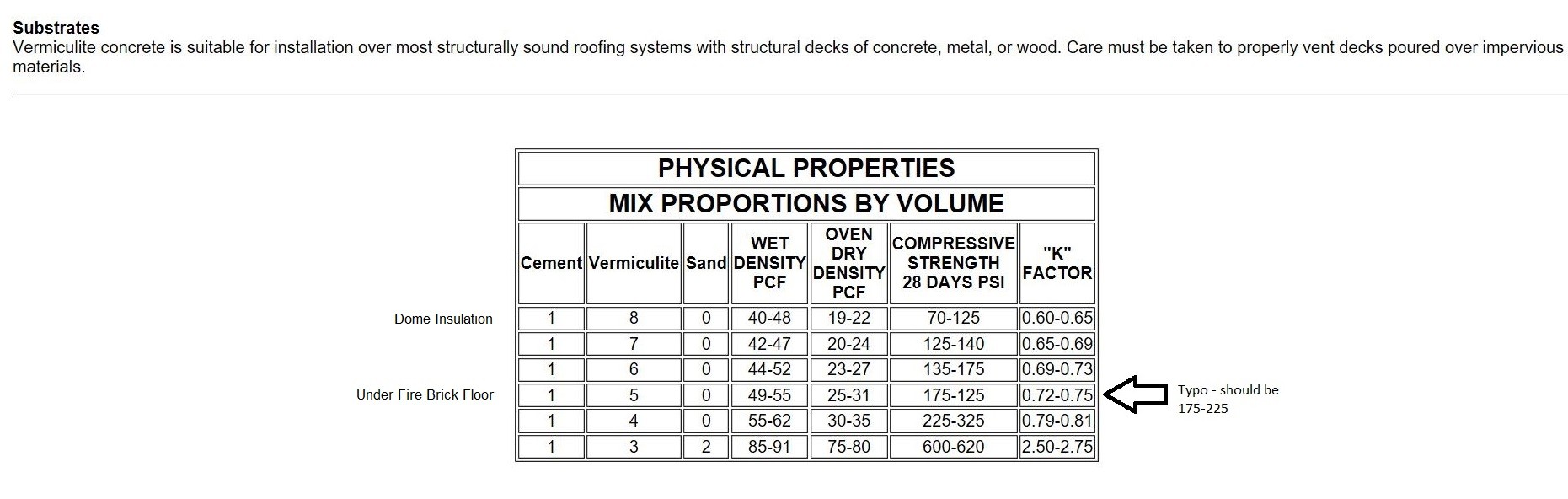

              I'll try and answer for David. P or Vcrete has a lot of water in the mix and has to be removed either by extended drying by natural or heat from the ovens. Using P or V crete is used for floor insulation is particularly difficult to remove if one start the brick floor before the mixture is completely dry. Wet insulation is one of the major factors for poor oven performance, this include CaSi board (for floor) and ceramic blanket (for dome) . It typically takes twice as much p or cvrete thickness to equal CaSi or ceramic blanket thickness. So in a nut shell, if your insulation is or get wet it will take longer to cure the oven. Attached is a pic showing p/vcrete ratios and insulation values.

                      The table also shows the relationship between density, strength and insulating value. You can make it stronger, but that reduces insulating capacity. Conversely you can make it more insulating, but that reduces strength.
                      Builders have found that because the underfloor insulation needs to support significant weight a 5:1 mix is required, but for insulation over the dome, where strength is not a factor, just enough cement to bind the grains together and to make application, particularly on a vertical surface, a 10:1 mix woks ok. Some builders have gone as lean as 13:1, but I find 10:1 as lean as is comfortable for me to handle.
