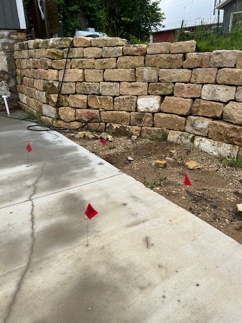

    I live in west central WI, so I need footings.
    This past summer, I built a stone retaining wall with crushed stone footings that go down 4’.
    My concern is that if I dig conventional footings for the pizza oven too close to the stone wall, the wall will cave in.

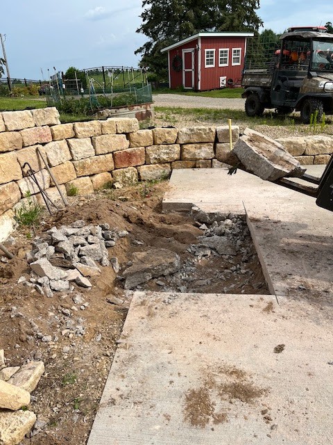

    Refer to the attachments. I cut the existing slab where the flags are so I have enough room for the piers.

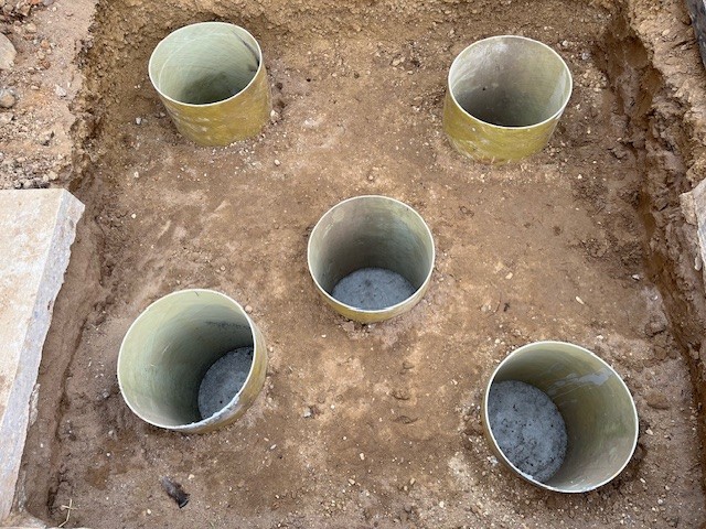

    After cutting out the existing concrete, I drilled five 18” diameter holes 4’ deep. One hole in the middle, and a hole at each corner.
    I poured 8” of concrete in the bottom of each hole as a footing.
    Then, my plan is to use 12” Sonotubes.
    The next step is to form out the base slab that will be poured on top of the piers.
    After which, I can lay the blocks that will support the slab for the oven.

    As stated before, not a pro or expert, but I did a lot of research on this for my build. I think what you have is fine considering you can't excavate. The bottom of the concrete piers will be below your frost line and they all live in the small footprint of the stand. The site should get reasonable drainage considering the proximity to the crushed stone under the wall. The recommendation is to not let the rebar contact the soil at the bottom of the hole, but you've managed that with the footings. Yes, put a 90 on the bars going in the holes and tie them to the grid in the slab. Remember to leave 3" of concrete between any part of the rebar and the soil.
    I worked in a rebar plant for a couple years and certainly saw a lot of welded cages and baskets for both building and road construction. I always thought that was done to improve the strength of the assembly and to make installation more efficient. I wouldn't think welding would have much of a benefit in this small application. I'm sure others on the site will chime in if they believe otherwise.
    12" tubes was a sound decision. Heck, they cover a significant part of the slab area. Yes, pour the tubes and the slab in a single pour.
    I wouldn't put foam board under the slab, but you could run a piece the thickness of the slab around the outside where it meets the soil. You'll also want to put some expansion joint material where the new slab meets the old. I would put 6" of compacted drainage gravel under the slab and put some heavy plastic over that for a moisture barrier...tho not quite sure it will be 100% effective since you'll need cutouts for the tubes??
    Slab thickness? I aimed for 6" and probably ended up around 7". Not sure what the minimum should be. Maybe someone else will weigh in. With all the weight of the stand, suspended slab and the oven, I don't think I'd go less than 5". I had to order a minimum of 1 cu yd of redi-mix and I had about a wheelbarrow extra. I think my slab was around 7'x7' and I filled 2 10" Sonotubes. Check out my build. The calculations are pretty simple if you also have a minimum delivery. No such problem if you're mixing your own.

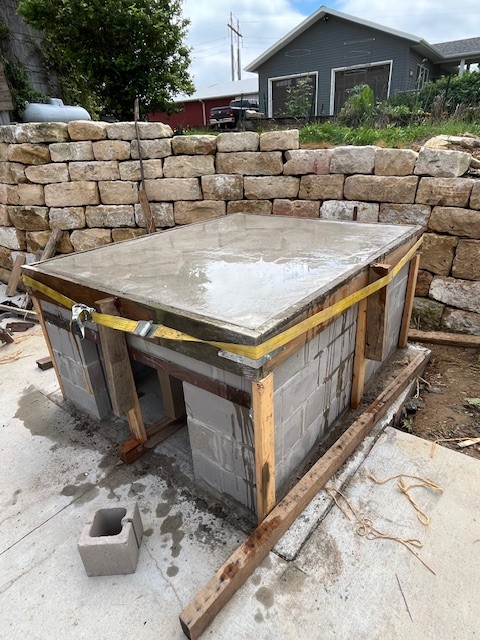

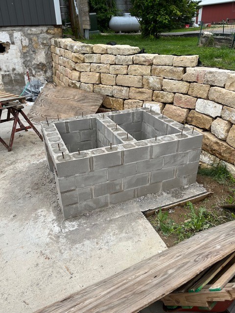

        I’m finally getting back to the oven build.
        Got the piles and base slab poured and block walls up.

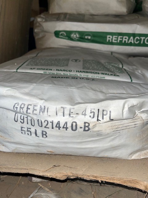

        I purchased several bags of insulating castable Greenlite 45 PL along with ceramic blankets and fire brick at an auction.
        Probably enough for three ovens.
        Can I use the Greenlite 45 PL as an underlayment for a fire brick floor?
        If so, how thick should the Greenlite 45 PL be to properly insulate the floor?
        Also, I was going to use Greenlite 45 PL to insulate the dome of the pizza oven over the ceramic blanket.
        Or, maybe after the dome is built, put a layer of the Greenlite 45 PL over the fire brick, then install the ceramic blanket, then put another layer of the Greenlite 45 PL over the ceramic blanket?
        I’ve tried contacting the company that manufactures the Greenlite 45 PL along with a couple of their distributors , but haven’t received any replies.
          The Greenlite 45Pl is really pretty dense at around 15mpa (2000lbs/in2) and not a brilliant insulator at 0.5 W/mK. As a comparison dry perlite is 0.05 W/mK Blanket and a 10:1 perlcrete are around 0.4 W/mK
          As you already have it then by all means use it for underfloor insulation, but make sure to allow it to dry for at least a couple of weeks before laying down any floorbricks which will hold the moisture in. Thermal conductivity also drops by almost half between ambient and pizza temperatures.
          For over the dome I'd be adding at least 30% perlite or vermiculite to it as an over the dome insulation, either beneath or over the blanket jayer, because you want maximum insulation value and it only needs to be just strong enough to act as a substrate for a render/stucco to cover it.
            thank you for the information. I purchased the Greenlite for a little under $7 for a 55 lb bag.
            I did mix a test run of the Greenlite, and yes, it is very dense. like a type S mortar.
            how thick should I pour the floor with the Greenlite?
            should I also add 30% perlite or vermiculite to the floor?

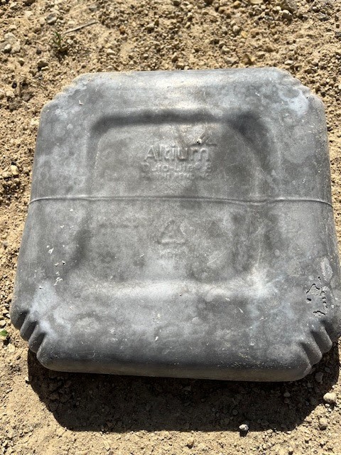

                I attached a pic of the cured Greenlite.​

                  I mixed the 10:1 perlite.Greenlite and the 5:1 perlite.Greenlite as well as the 1.3 perlite.Greenlite.
                  the 10.1, 5.1 did not fair well with strength. the 1.3 perlite.Greenlite is better, but not as good as the Greenlite un modified.
                  In the attached pic, the test sample on the right is Greenlite un modified.
                  the left and center is the 1.3 perlite.Greenlite.
                  it looks as though the Greenlite un modified has a finer size perlite in it. ​

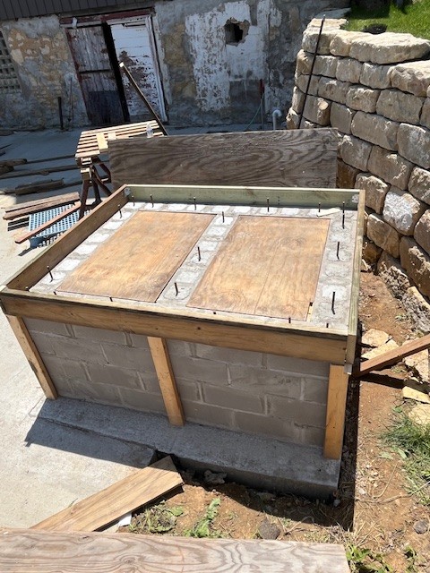

                  after reviewing the test results, my plan is to lay 4" of Greenlite un modified.as the subfloor to lay the fire brick on.
                  I'll drill, from the bottom, and place some thermocouples at different depths in the 5" concrete base to see how well Greenlite un modified insulates the floor.
                  attached is a pic of my build thus far.
                  the ratchet strap and 2x4s in the middle of each wall, worked very well for holding the form together while pouring the floor.
Name:	pizza oven slab strap.jpg
                  plan to pour the subfloor sometime this week.
