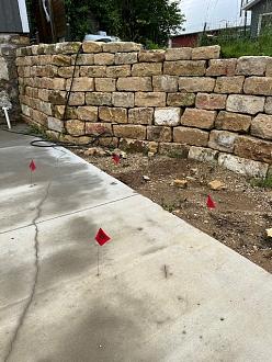

    I live in west central WI, so I need footings.
    This past summer, I built a stone retaining wall with crushed stone footings that go down 4’.
    My concern is that if I dig conventional footings for the pizza oven too close to the stone wall, the wall will cave in.

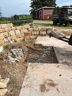

    Refer to the attachments. I cut the existing slab where the flags are so I have enough room for the piers.

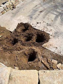

    After cutting out the existing concrete, I drilled five 18” diameter holes 4’ deep. One hole in the middle, and a hole at each corner.
    I poured 8” of concrete in the bottom of each hole as a footing.

    As stated before, not a pro or expert, but I did a lot of research on this for my build. I think what you have is fine considering you can't excavate. The bottom of the concrete piers will be below your frost line and they all live in the small footprint of the stand. The site should get reasonable drainage considering the proximity to the crushed stone under the wall. The recommendation is to not let the rebar contact the soil at the bottom of the hole, but you've managed that with the footings. Yes, put a 90 on the bars going in the holes and tie them to the grid in the slab. Remember to leave 3" of concrete between any part of the rebar and the soil.
