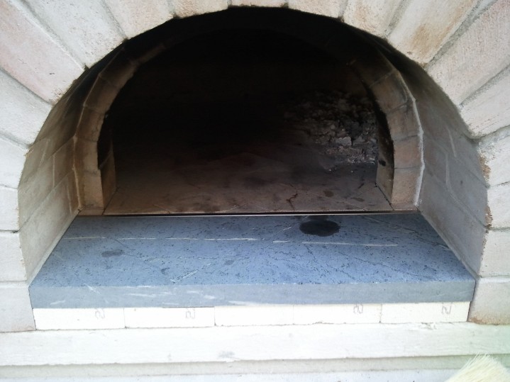

          To your heatbreak question - I did something similar in my oven. I used a piece of 0.75" x 1.5" stainless tube, set on insulated firebrick to bring it to the oven height. You can see it here behind the soapstone. I ran the IFB all the way under the soapstone in order to get it up to level and provide less opportunity for heat transfer from the oven to the landing

          I think the piece that you have will work fine - but you should fill it with CF Blanket or v-crete as you are planning. I left mine empty, but there is some limit to how wide an air-space you can have in a tube before you get a convection effect - which can be worse than having no heat break! There is quite a discussion of this on my thread here, if you are interested.
