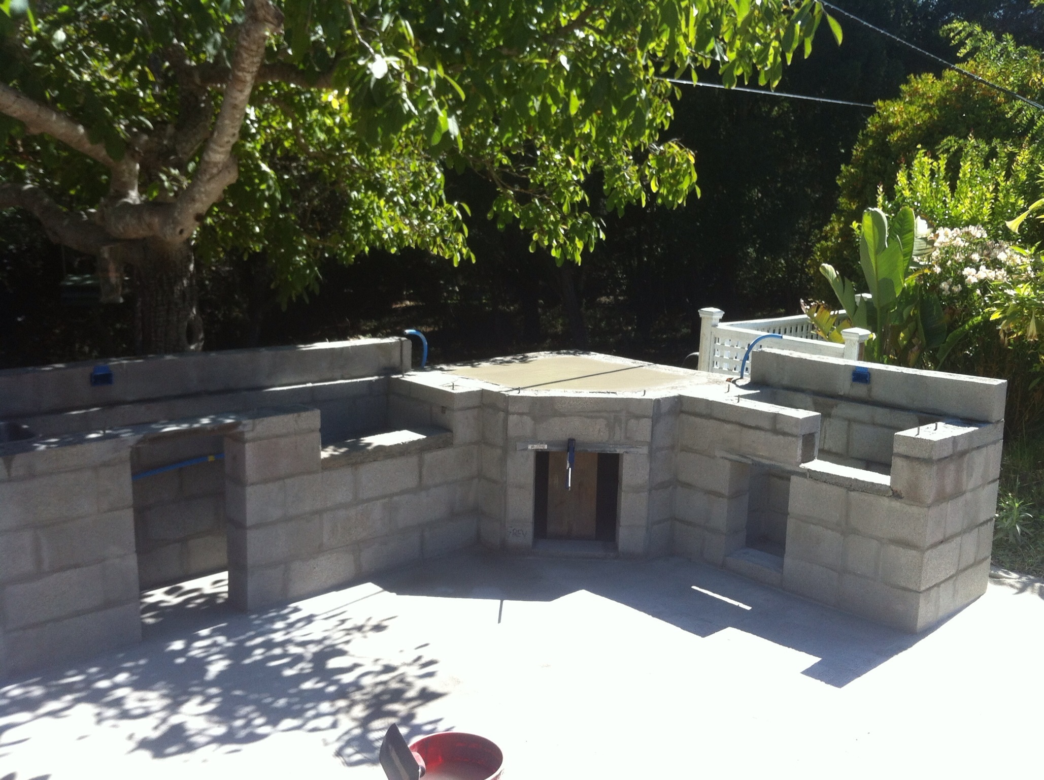

        Here is a quick picture of the kitchen.
          Re: Info on a corner build for an outdoor kitchen
          Great looking start on the kitchen and beautiful location. I am a little on the jealous side . 5-1 for vcrete is correct for under the oven. I don't think that you will regret the extra oven floor height.
