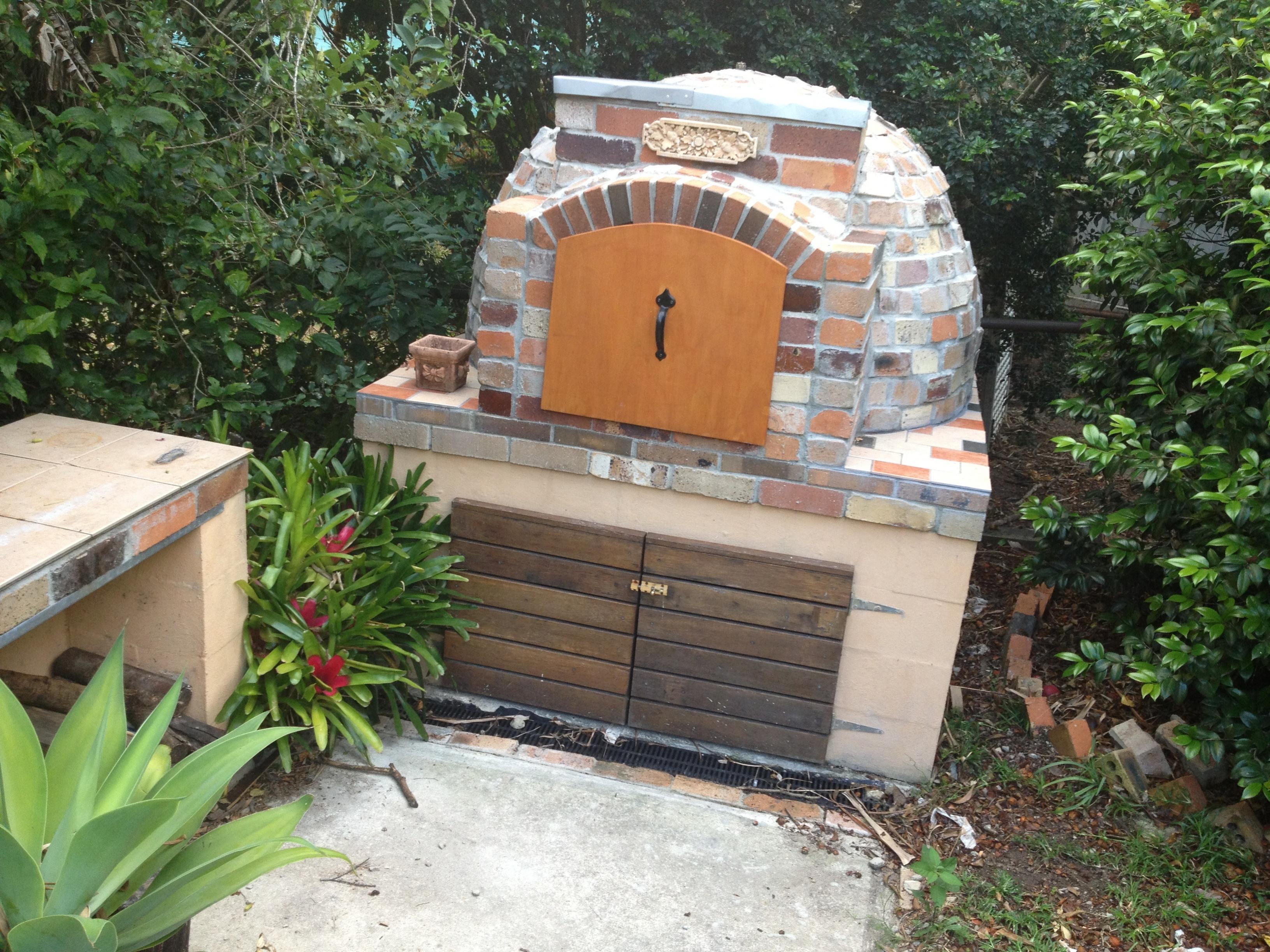

      Gudday tikidolracer in answer to post 15
      Yes in theory that sound good . But my oven operates in a real world.
      With a sealed dome any moisture end up in the insulation and yes it will be there insulation just loves to wick up water, it only has one way to get out. Back into the brickwork of the dome. Slowly.
      A vent at the top of the dome tips the balance and allows me to dry my oven effectively
      Equilibrium could be achieved in the Simpson desert I suppose but my oven lives at the bottom of the garden. It gets wet from time to time, and you dry it out.
      It never had a vent to start with, but a few dome cracks mainly a the rear of the chimney. It now has vent and a brick veneer (unsealed I might add) and a outer rain door and a spoon drain.
      So in a way I have achieved an equilibrium. It get damp I dry it out and cook in the open air the way I like too.
