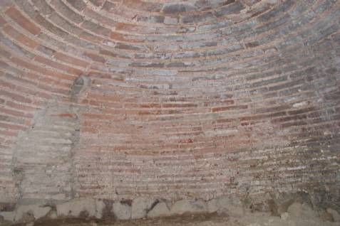

    There is a long history of ovens in pompeii constructed with 1" bricks. A few builders here have made the same inquiry as yours, but I am aware of only one builder who used splits, and it was for his entryway, not the dome.
    Personally, I think using splits makes for a very handsome and unique oven,
    I am not aware of a barrel vault being made with splits, but there is no reason it wouldn't work. It will just take more time and mortar to construct than using standard firebrick.
