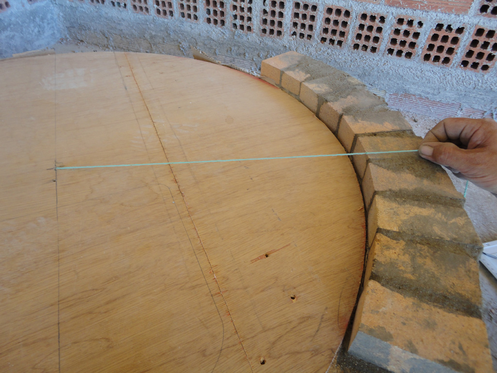

                          Hi,
                          You can use string for guidance if you don't want to make IT tool.
                          You can see my thread photo.
