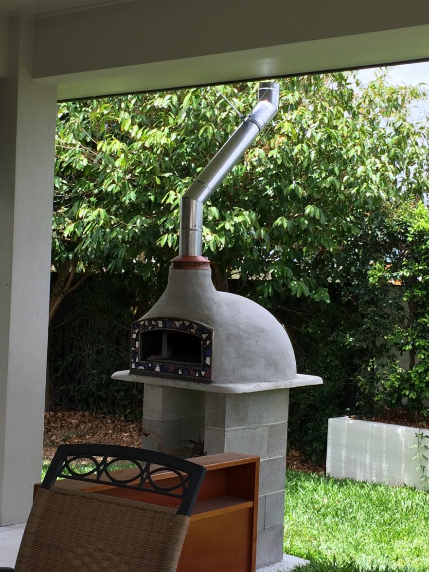

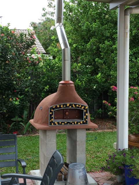

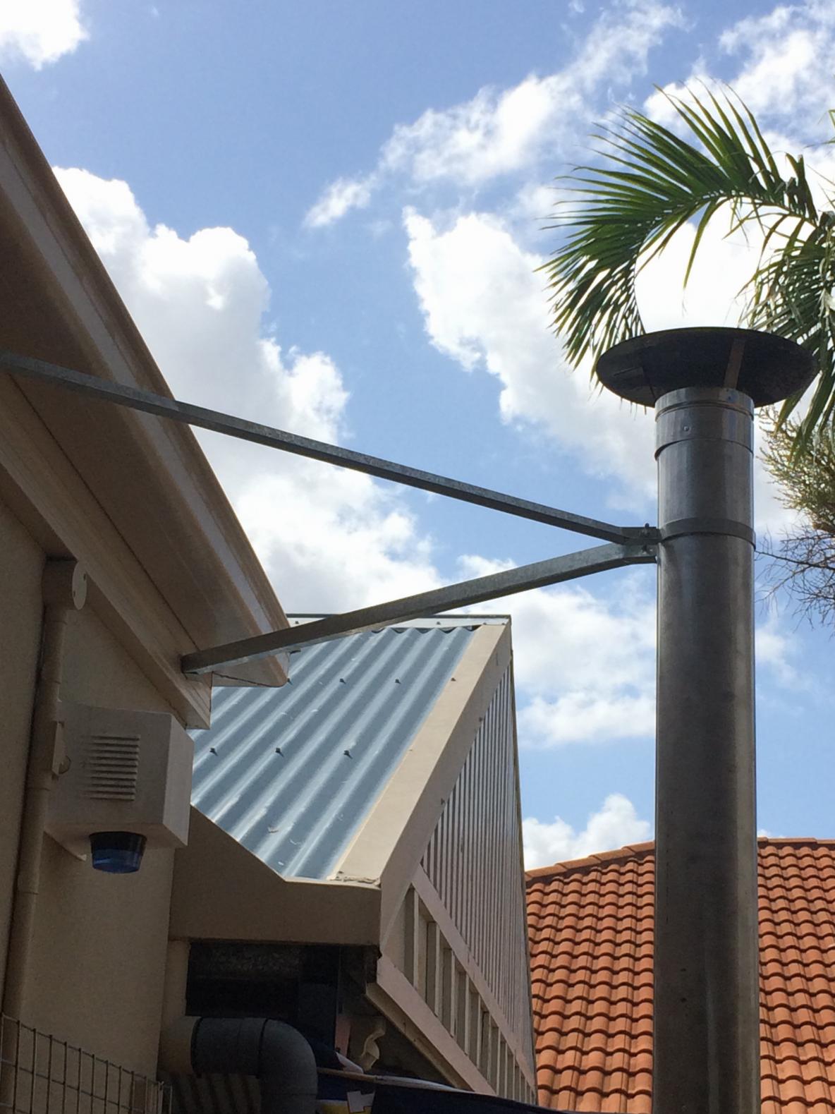

    I've done several ovens this way. I think it is a better solution than going through the eaves, although the stainless bends and extra flue lengths add up. Don't go less than 50 mm from the gutter. I usually have a vertical stay on the 45 and two horizontal ones attached to the facia board. This way the oven can be tucked neatly out of the weather, with maybe its bum getting a little bit wet.
