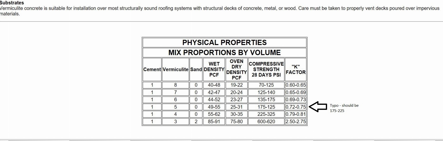

          The attachment shows relative strengths of perlite/vermiculite mixes. Note the 5:1 mix is around 200 psi. By contrast a proprietary castable refractory is around 3-4 psi. As I mentioned in my previous post the rendering of a stronger mix on the inside is not likely to be successful, but if you want to give it a go you will have to thoroughly wet the dome or it will suck the moisture out of the applied mix and not leave enough for the hydration process. Also if you make it too wet there will be issues with the mix bonding. It requires somewhere between wet and dry, difficult to judge.I'd be most interested to see how it goes if you want to give it a shot, so report back if you do.
