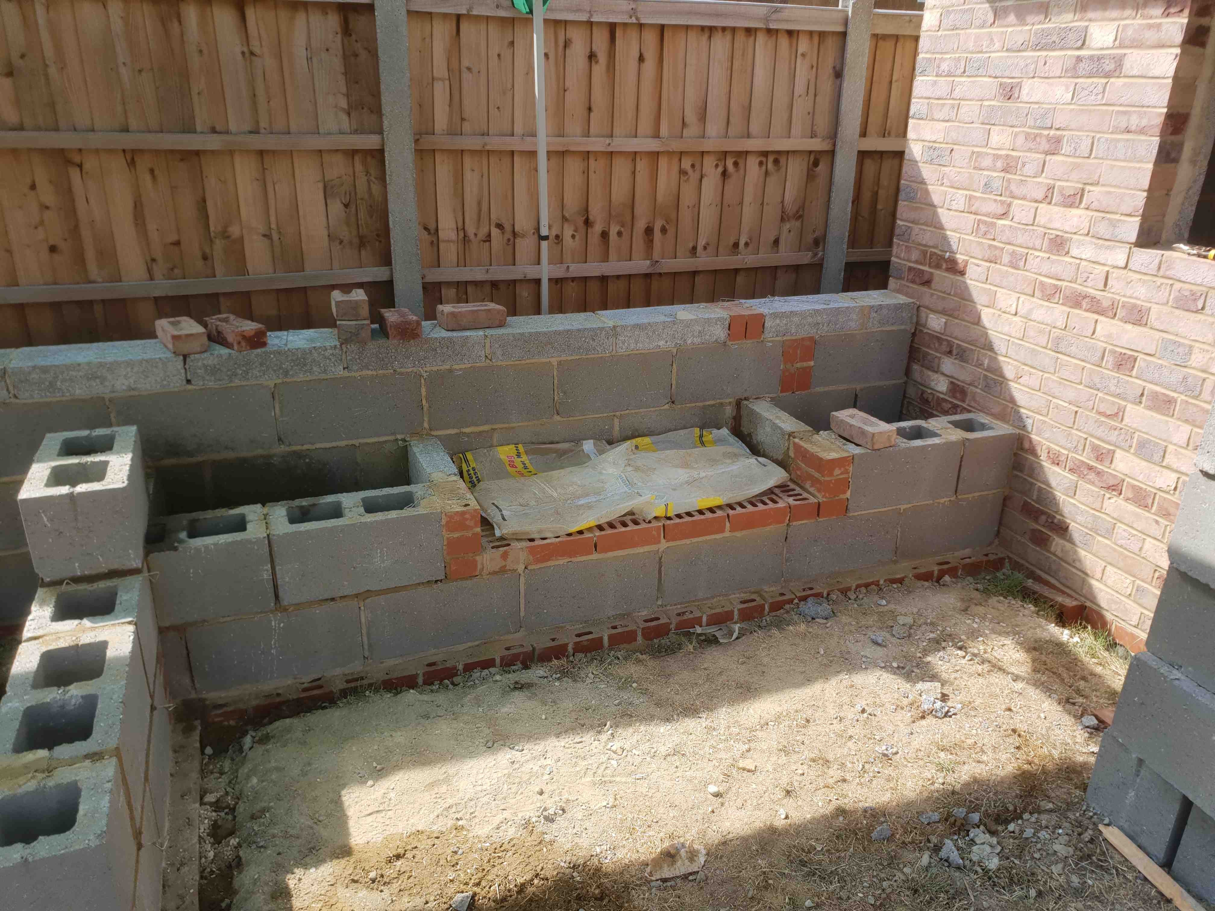

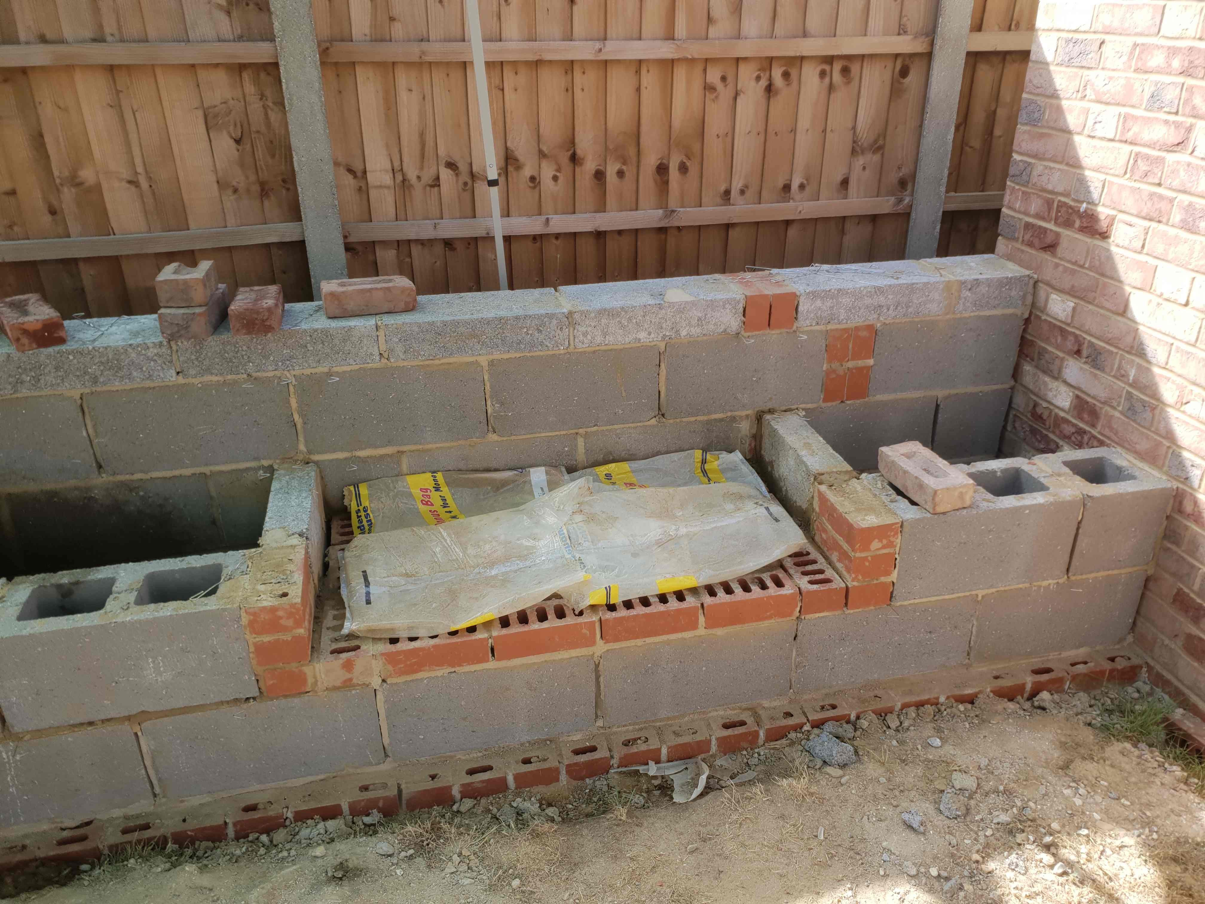

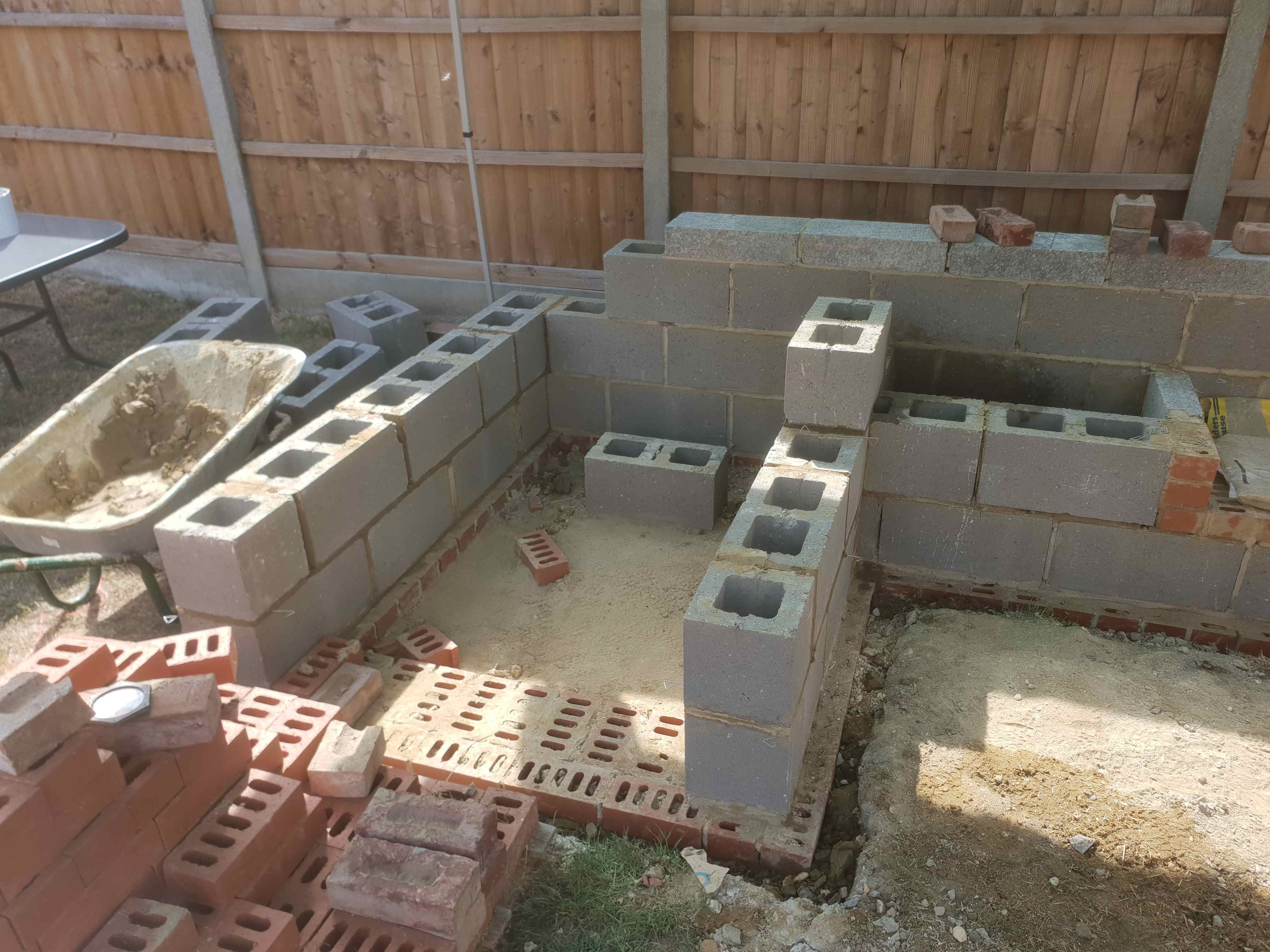

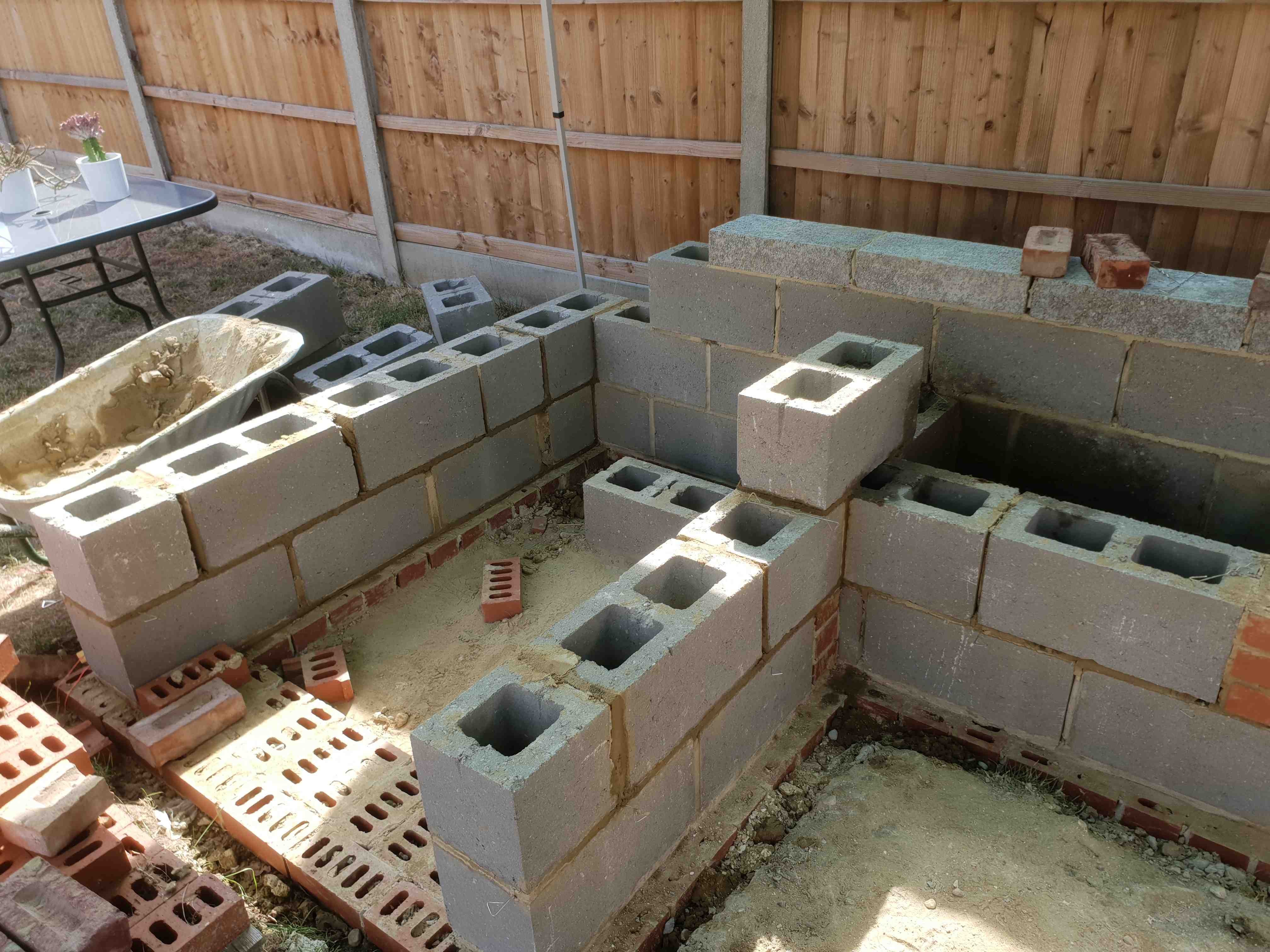

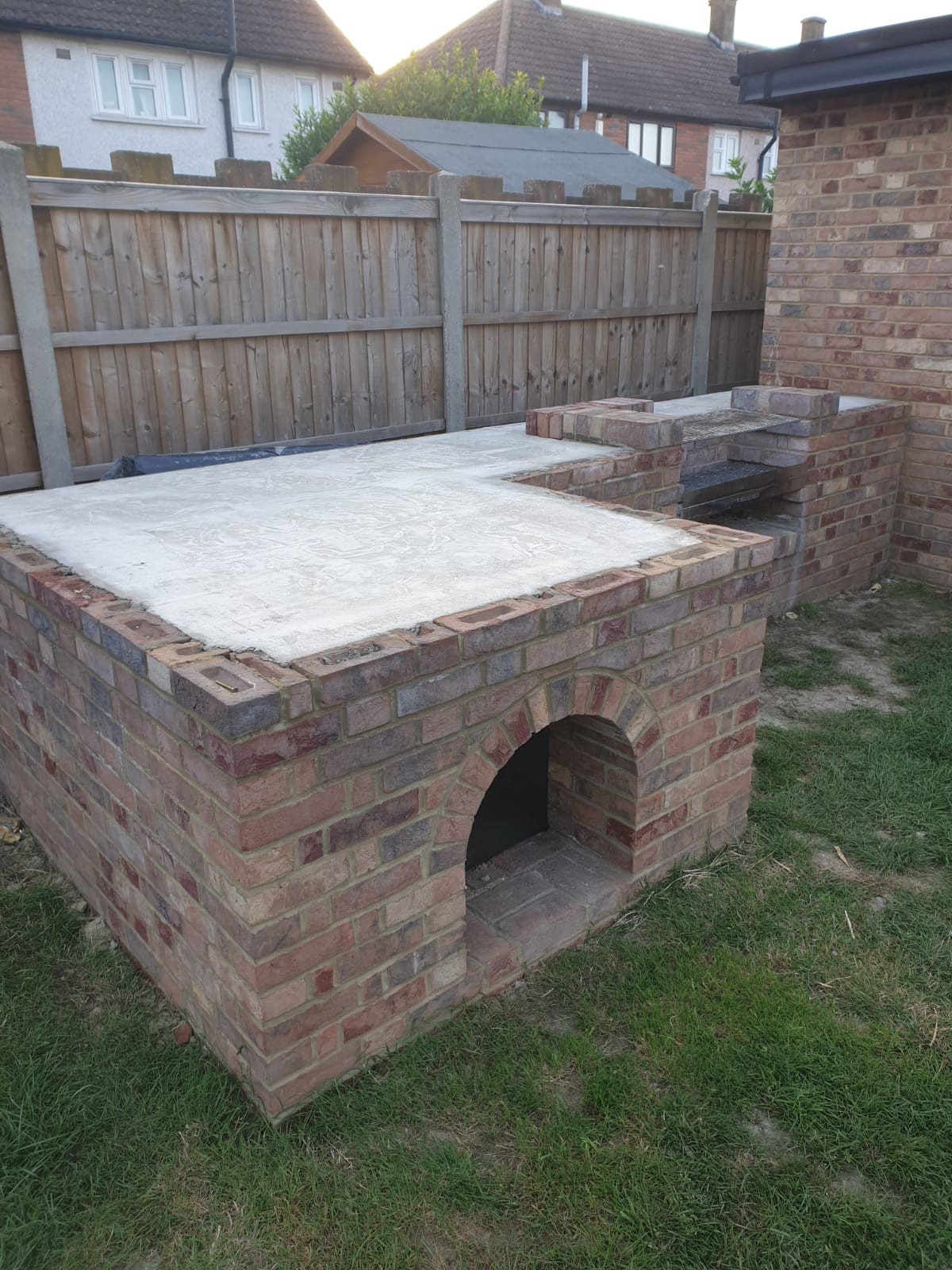

so I've started my build and now at the stage of installing the base.
I'm using 50mm ceramic board, will I need to still use 100mm of vermiculite cement below the board?
I laid a 30mm base of vermiculite and cement mix down today more just to get a nice flat surface for the ceramic board to lay on, after i finised i started to think that i should have just gone thicker,
Is this enough insulation or should i bite the bullet and re do it and make it thicker?
I'll try and get some pis added of the build so far, not much of a pizza over yet though
Thanks
