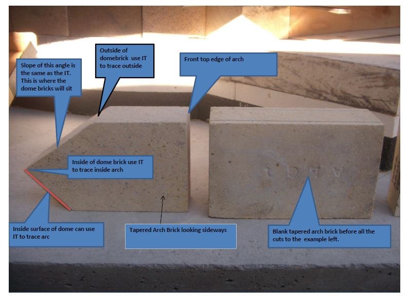

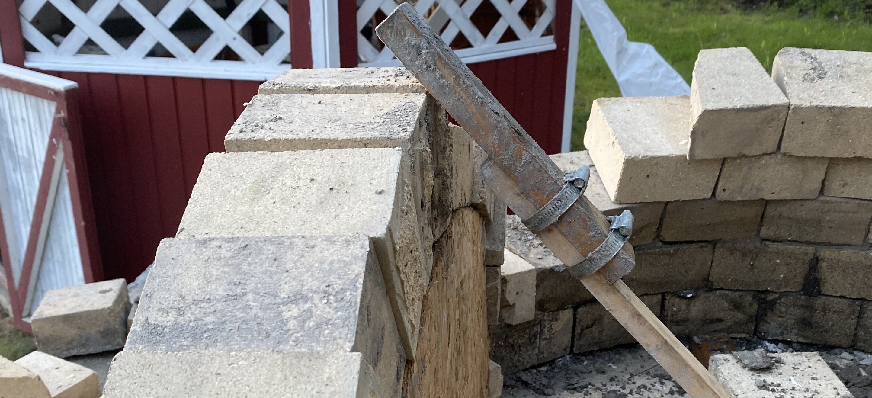

Hi - a very basic question but I simply can't get my head straight on how to:
1) place the inner arch soliders. Is it simply at the dimensions of your intended opening size?
2) how deep to place the arch into the oven (if that even makes sense)
I'm following the 36" build dimensions but for whatever reason I can't visualize where the top of the arch will connect back into the dome and at what angle to then taper the arch bricks. I feel like I'm definitely overthinking a basic part of the build but the more I stare the more I get into the mud....
