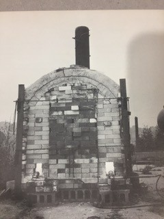

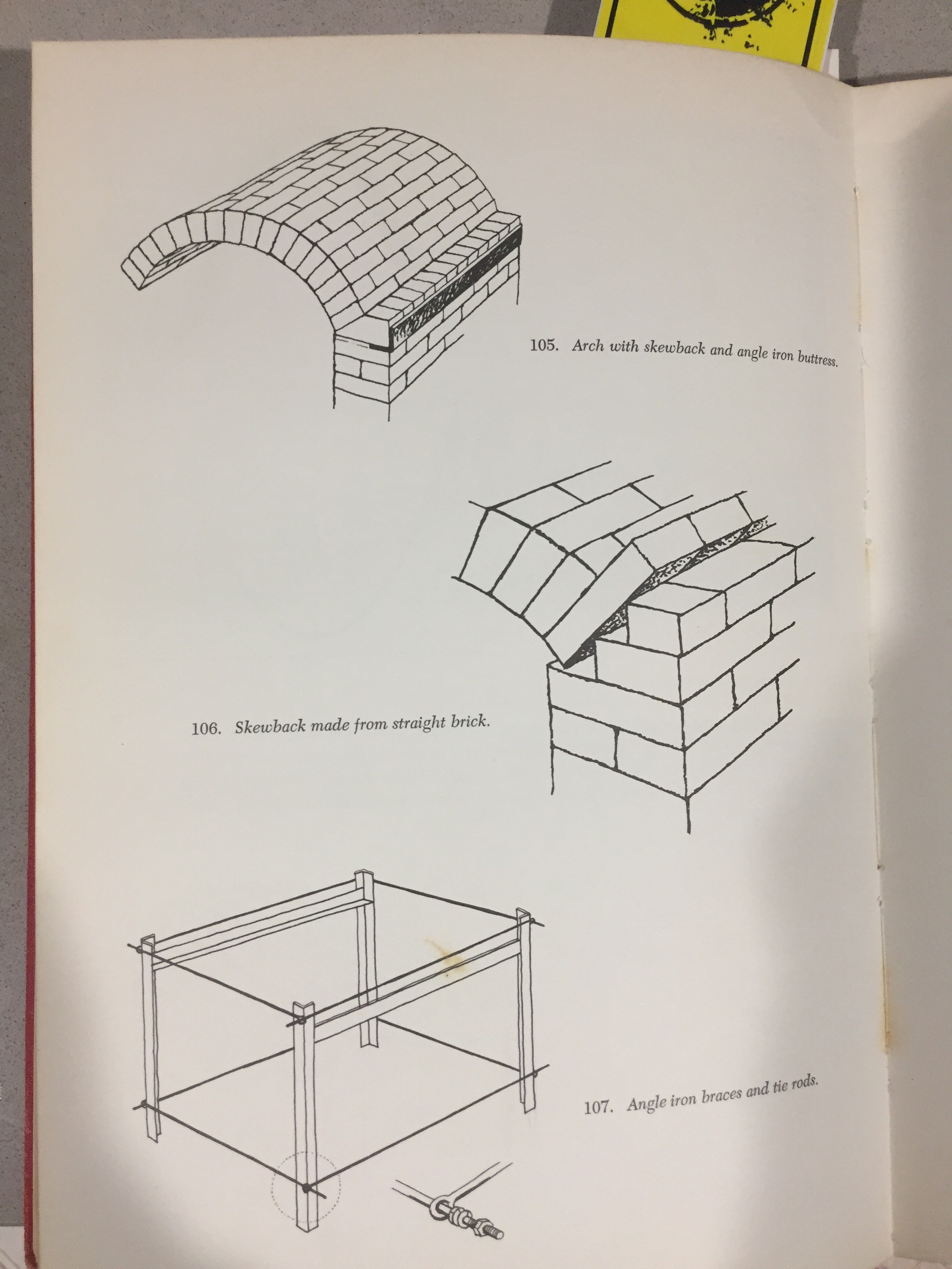

            Here are some images from Daniel Rhodes Kilns (the kiln builders bible)
ID:	438792 Click image for larger version

              I can see how the bracing shown in the pictures you posted make sense in such a tall structure. The outwards thrust the arch places on the walls would easily topple the tall walls.
              I plan on filling up inbetween the oven and outer walls with vermiculite mix, up about 3 bricks. Do you think that will be enough support?
