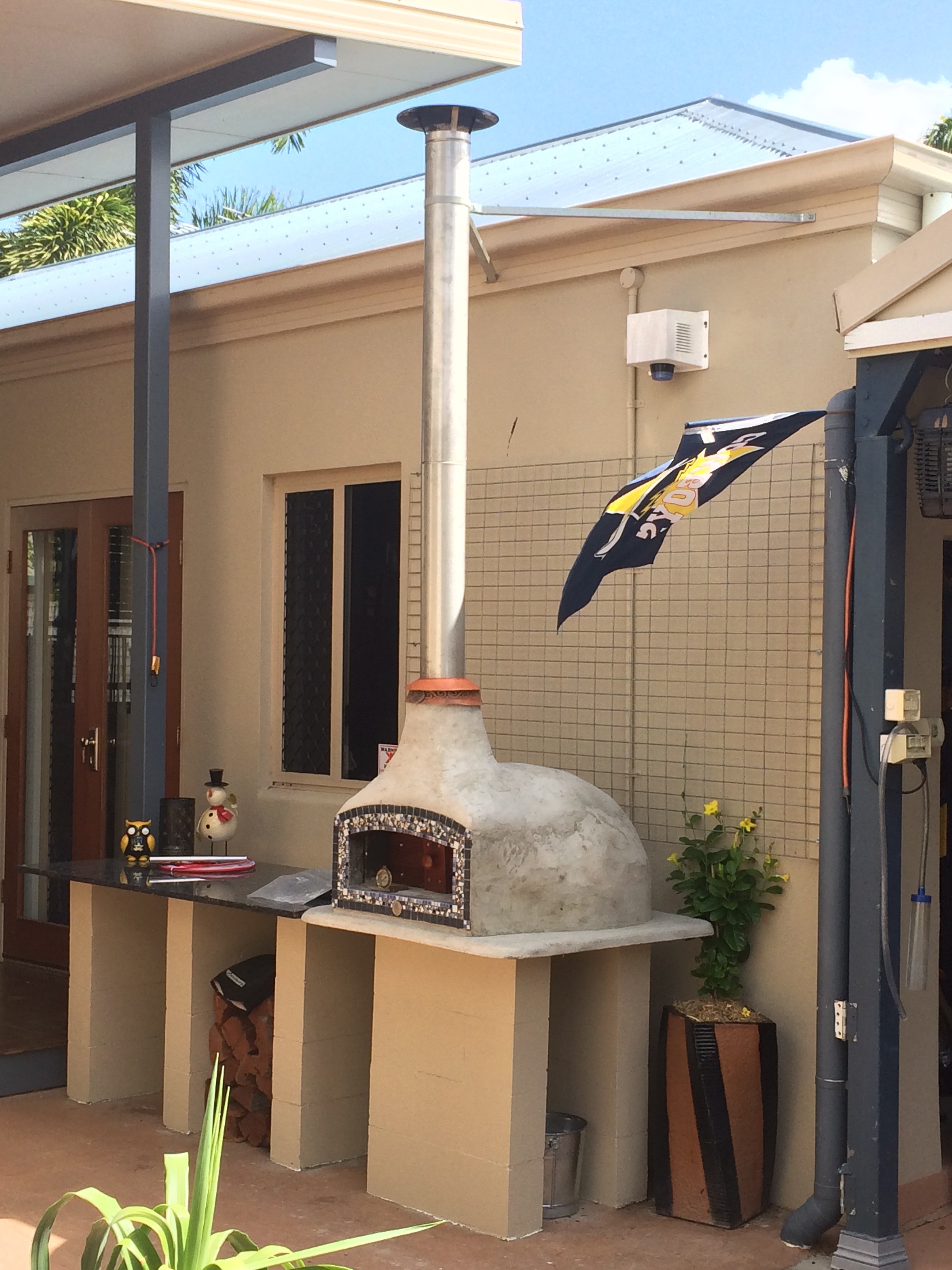

              Here's one I built with a tall flue for exactly the same reason as yours. The oven fires and performs pretty much the same as one with a short flue.

                Nice, thats pretty much how long I would like it. Thanks.
