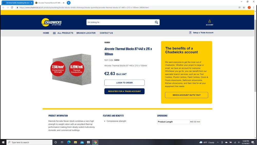

                    So things are about to start materials for the support stand and slab are arriving this week, planning on commencing work over the Christmas period. I’ll start a different thread and picture document it there. BUT I need a little bit of advice again. I have CalSil board coming 60mm, but I was originally going to do a 100mm vericrete course to sit CalSil on. I’ve come across thermal blocks and am wondering would they be a good substitute for the vermiculite course? I’m not well versed on insulation terms Heres the link to the blocks themselves.............

                      I'm not very good with converting the many different measurements that are used worldwide for compression strength and thermal conductivity. However, from my memory of past discussions, I believe that compression strength for aircrete is well above what you would get with vermicrete but, the insulation factor is well below. That may not be an issue since you have a little over the minimum of 50 mm of CalSil that is recommended. It's best that you wait for the engineers on the forum give you a definitive "pie R square" .
                      If it has not been covered above, I would like to remind you about the weep holes and elevating the insulation above the structural hearth. I now like the grid pattern that mosaic tiles offers.
