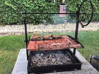

    I purchased a grill. It looks like this:

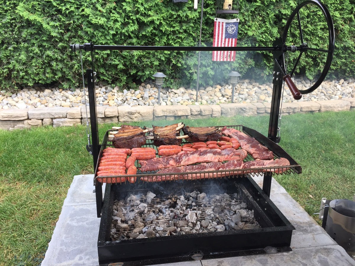

    It doesn't come with a bottom - they tell you to line the bottom with fire bricks, which I will do, but there are no instructions regarding what would make an appropriate table / counter / base.
    So ... I have a big 2" thick granite slab that I want to use as a kind of tabletop for the grill to sit on. I was hoping I could place the firebrick pad directly on the granite slab, and build a fire right on that firebrick. But after reading some horror stories about how granite will crack or even explode when exposed to high heat, it's become clear that I need some insulation between firebrick and granite. Perhaps quite a lot.
    (Unlike with a pizza oven, I don't need the fire bricks to retain heat for any reason.)
    Is this workable? Could I use the 2" ceramic fiber boards that Forno Bravo sells, put them between the firebricks and the granite? Or should I completely scrap the granite and come up with a different slab solution?
    Any advice is much appreciated.
