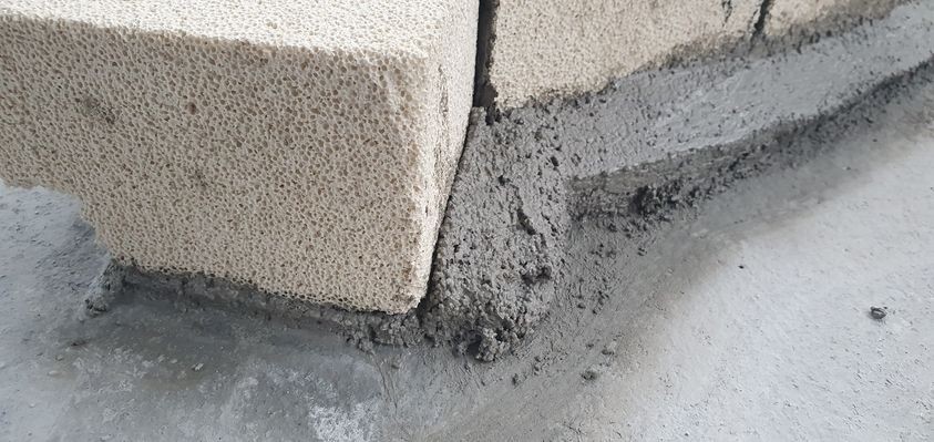

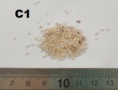

            I grabbed some of the 1mm filter sand, I think it's too course. Gave it a go to mortar the insulation bricks down to the slab, this joint was a bit thicker then I'll want for the higher levels, but none of this bit will be seen, so figured it was worth a go. Worked under the bricks ok, but way to course for between. I had a small 5kg bag of a high heat mortar that I ended up using between the brick, so that was a bi of a pain running to mortars at once..
            here is a pic of the mortared down bricks

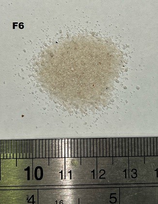

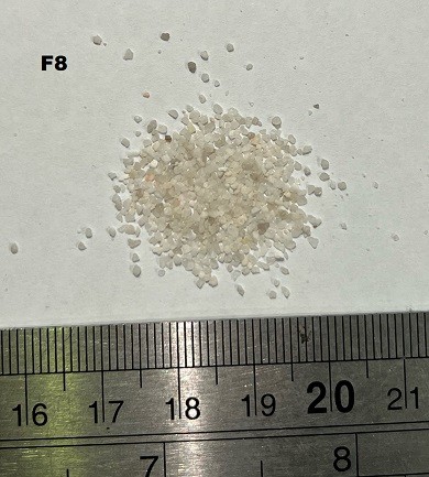

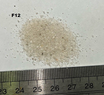

              following is some close up pics of the sand. The first is the c1 filter sand that I used in the previous posts pic.
              the next 4 are from the other supplier. I think I'll have to go for a drive during the week.

                    I tried sieving the silica sand with a seive I had, and it didn't anything out of it, looking closer at is the grain size is very consistant. i.e. there's not alog of smaller stuff in there.From the pics previously, I think the f12 sand looks a better option. I am trying to get as tight of joints as possible.
                    The mix I'm using is just the 3:1:1:1 mix I've seen on here as the standard.
