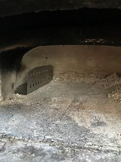

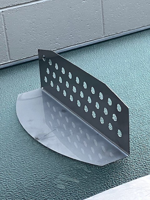

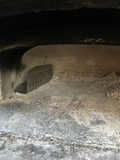

          In order to maximise cooking floor area and to reduce the tendency for the edge of the pizza burning because it's too close to the fire, I often use this fire tidy device. Because my oven is small this is a bigger problem than those with much larger ovens. It allows you to clean the floor right up to its face and easily feed small bits of wood into it by hand after pre-heating them in the sides of the flue gallery. After making a couple of prototypes to sort out the appropriate size, holes and thickness of material I've settled on this from 0.9mm 304 stainless and had a bunch laser cut.
ID:	451106 Click image for larger version
