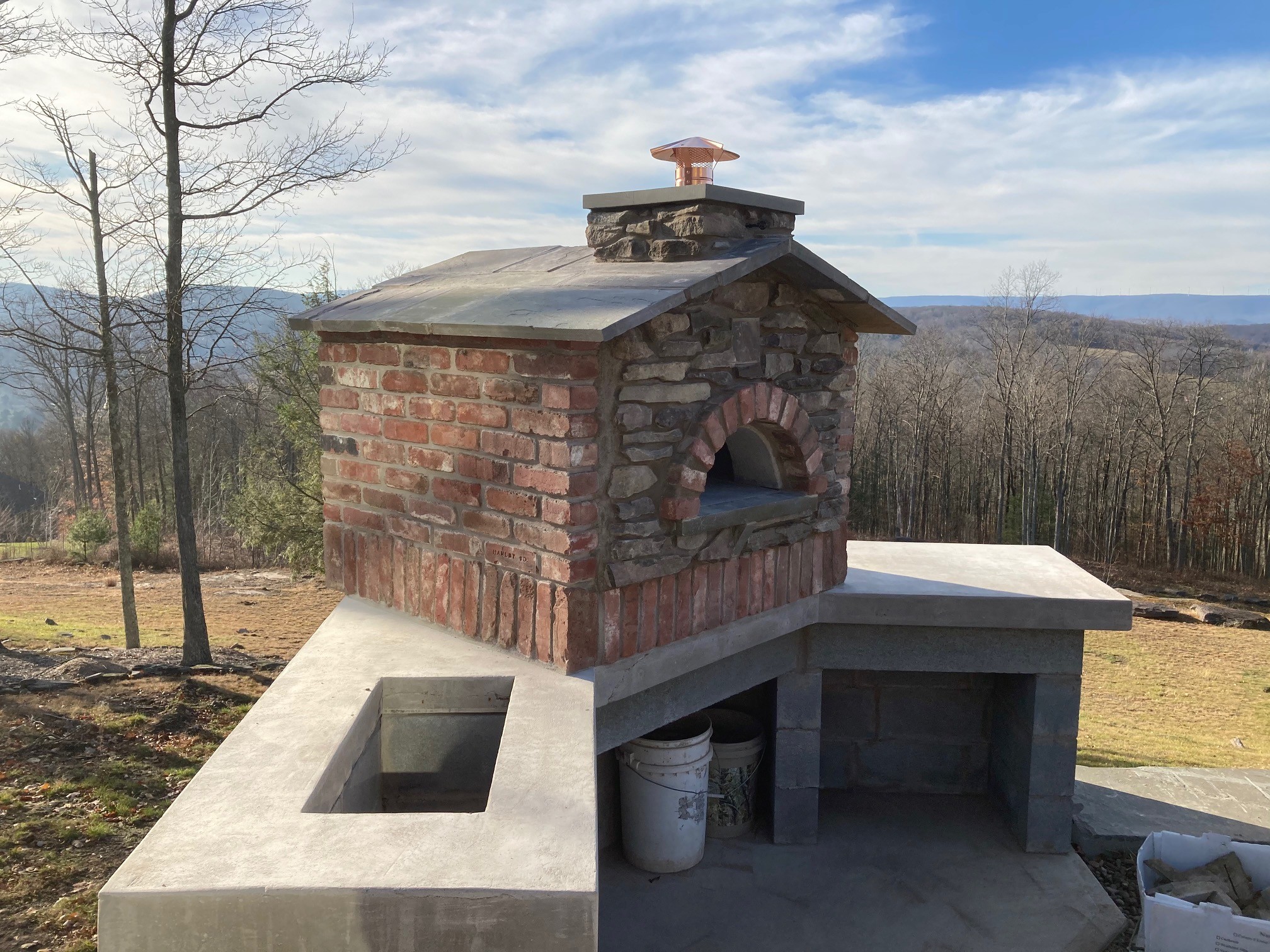

              32” inside and I’m quite happy with it. No need to go bigger for me. Click image for larger version
