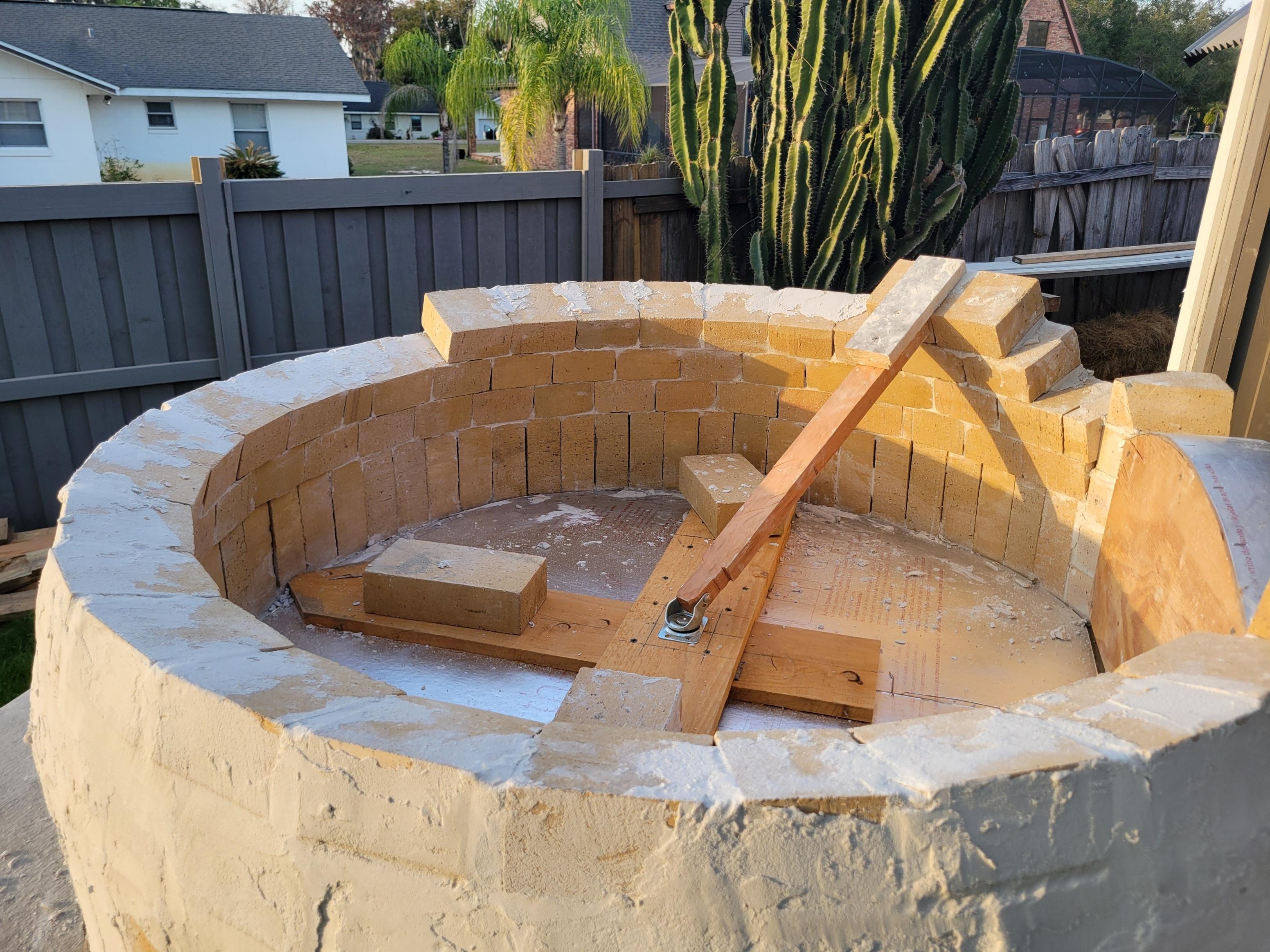

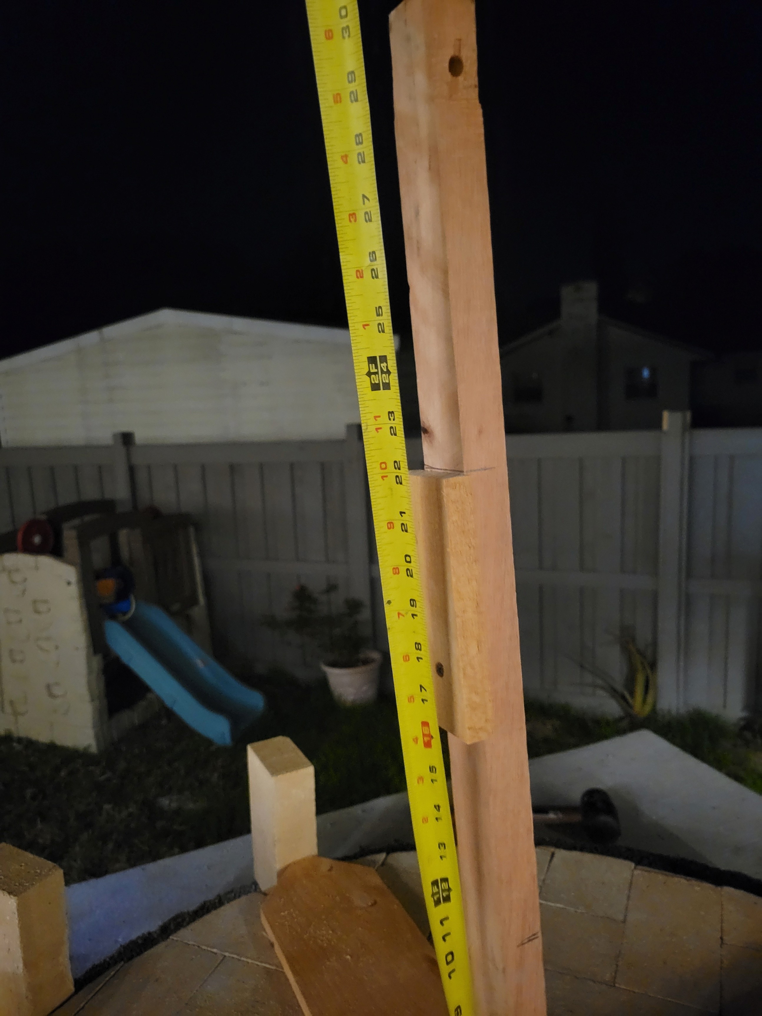

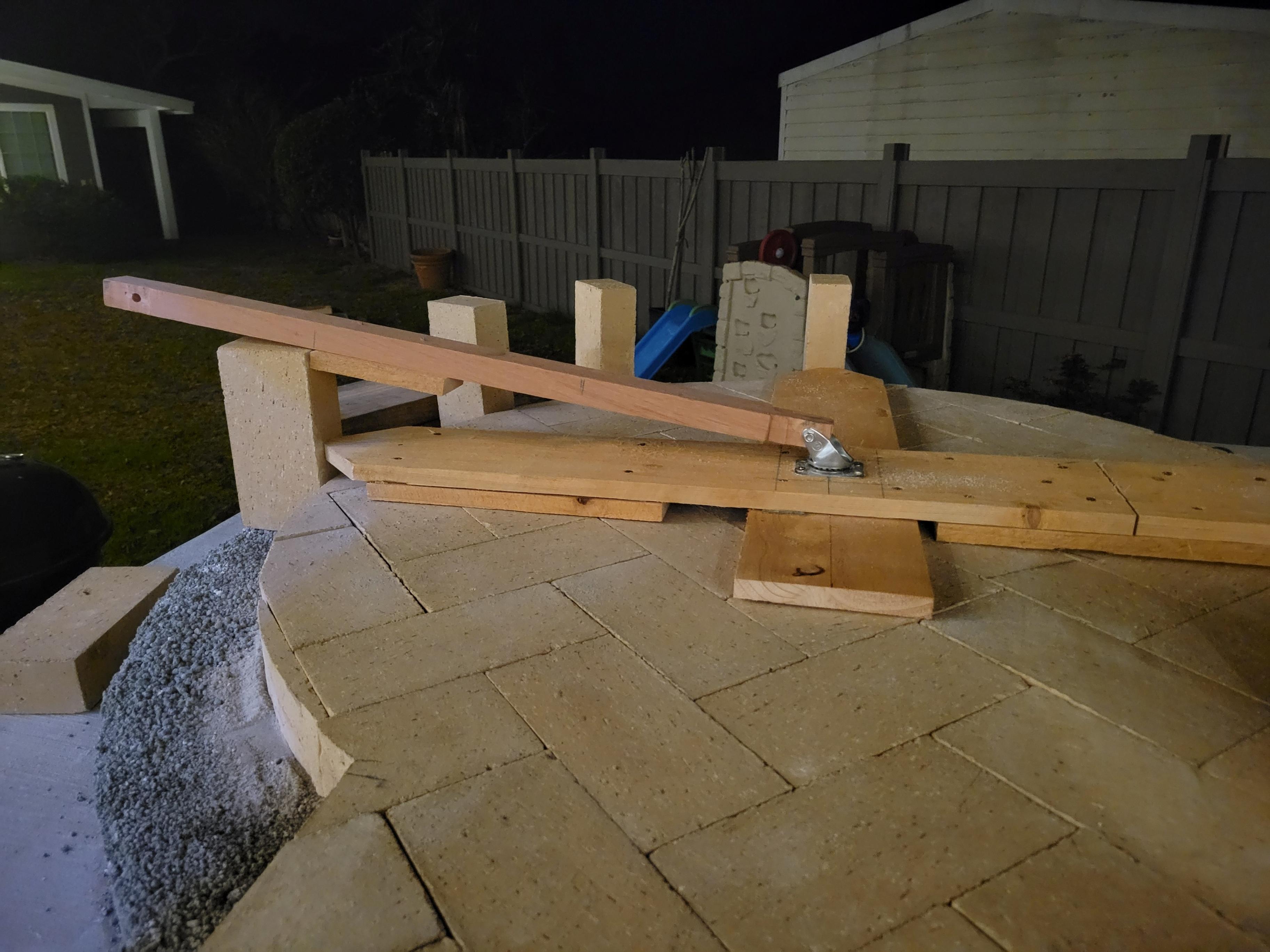

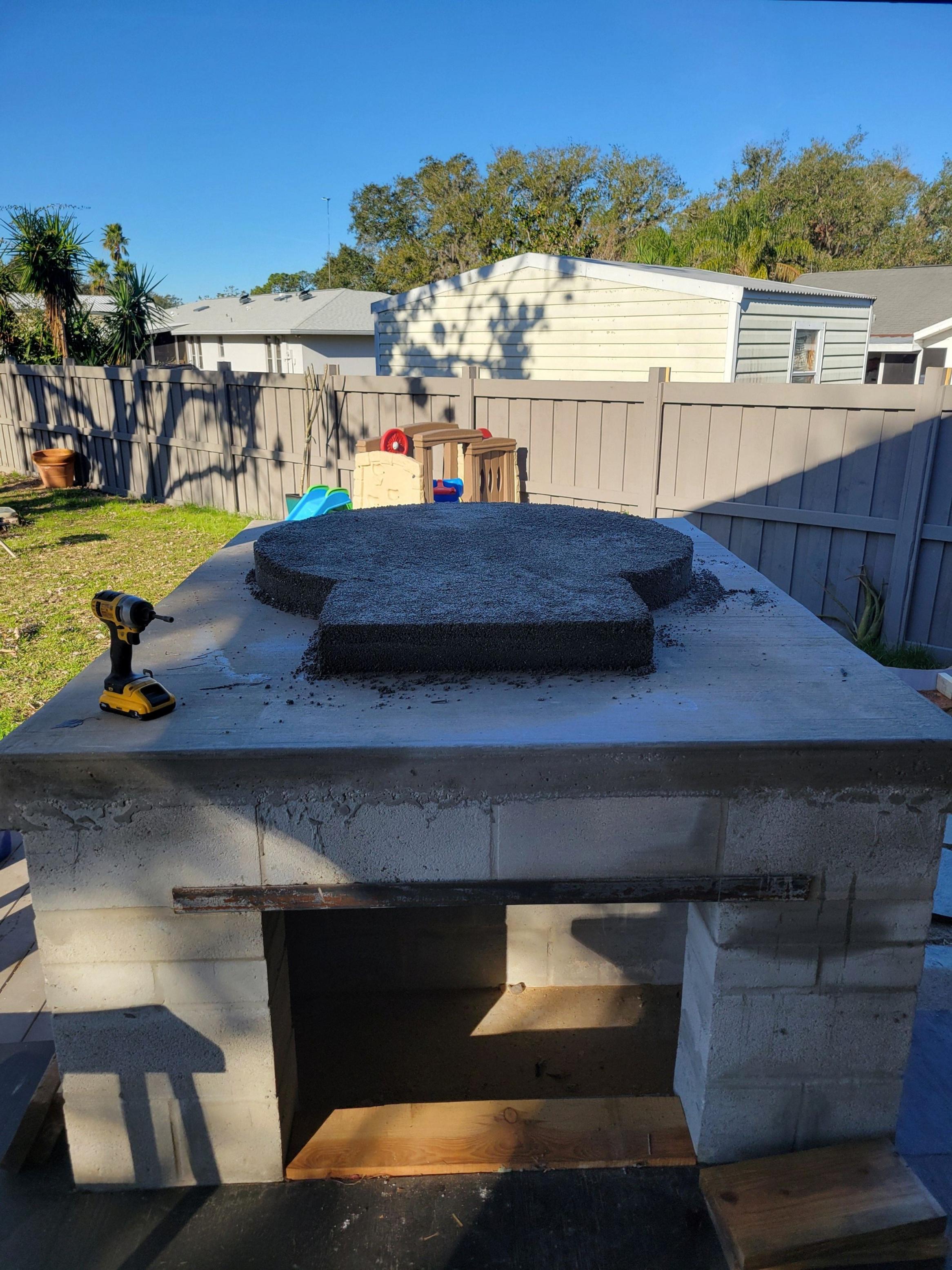

      I poured the perlcrete, came out pretty good, I was afraid that I did not use enough water, it was pretty crumbly but set up nice. I was able to find a bag of fire clay and I did a 50/50 mix with sand to set my floor. with help from my friends we were able to get it pretty level (and it passed the peel test with no snags)
      My next question is with the indispensable tool, I made it with a castor, and I have the 21" radius at the bottom but when I go straight up I am 22" from the base of the castor, add another 1.5" for the thickness of the wood on the bottom , my ceiling will be at 23.5", will this affect my build?
      Thank you

      • #18
        The increase the dome height due to the pivot point off the floor level will not affect the operation of the oven. But with the pivot point off the floor level and the offset of the castor will affect the angle of the interior of the brick face. It will not be perpendicular to the center of the floor, the error is cumulative as you go up in courses and you will see a stepping of the brick face and the higher you go the worse it gets. It is also important to have the IT adjustable in length to adjust for brick variables. Also the line from the center of the dome (at floor level)along the IT NEEDS to intersect the center of the brick face. Right now the IT hits the top of the brick.
        • #19
          The pivot point can be lowered to floor level by removing the centre brick and replacing it with a wooden brick of the same dimensions..When the dome has been built and the IT removed, the original brick can be replaced.
          • #20
            To adjust your existing IT as Utah suggests to make sure the pivot point intersects the midpoint of the brick, you could cut the long piece of wood where you've marked a line. This new cut surface is what will contact the brick. Then, glue/screw the smaller block on top of the long piece, extending over the top of the brick. Better still, put a a spacer even with the new cut surface to raise the top piece about 1/2". I'm assuming you're using 2.5" thick brick, so you want the pivot point to be 1.25" below where the arm hits the top of the brick. Currently you have it 3/4" above (assuming that's a 1.5" this piece lumber you're using as the arm), which is going to get the angles increasingly wrong as you go up.
            Here's the IT from my second build--you can see how the pivot point is ~1.25" below where the top of the brick will hit, and in that pic I also had mocked up attaching the IT to a wood block below floor level, as Davis S suggests:

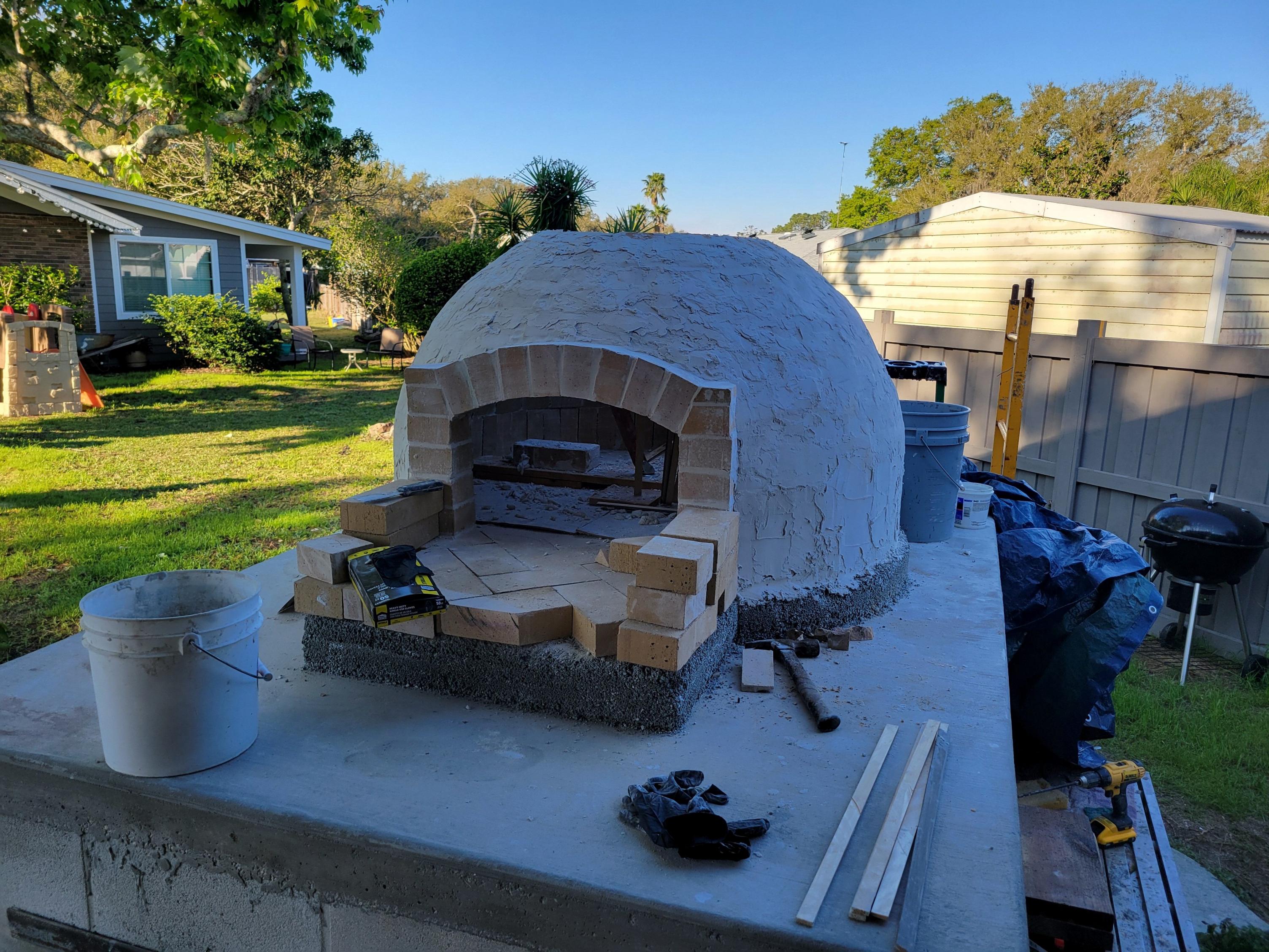

              I reworked the IT as you suggested and is working very well, however I do have a lot of small gaps on the inside of the oven, Should I fill these gaps with mortar? aesthetically it would look better, but is it needed?
              my fear is small pieces of mortar falling off. any thoughts on this?
              Thank you.
              • #22
                Use a rubber mallet to tap brick in when setting, it will help keep joint to a min. and help mortar squeeze out through joint. IMHO I would not fill existing gaps, fill will most likely not stay.
                • #23
                  It's a bit hard to tell from your photo, but you may consider thinning your mortar just a tad. Then, the gentle tap as Russell suggests will squeeze the mortar out of the joints and solve the gap problem. There's no harm in this. Similar to laying courses of brick or block, the excess is troweled off and reapplied to the next brick. The difference in oven dome construction is that you want to minimize the mortar joints on the inside face. There's plenty of mortar around each brick to hold it in place due to the north-south angle created by the IT and the east-west angle created by the arc of the dome shape. I was told to work each brick left and right until I could feel and hear it scraping on the course below. Then, gently tap it snug to the brick next to it. This brings up a tip that, I believe, I learned from Russel. Set a single brick on your next row at the end of the day and leave it to cure with it still resting in the IT. That gives you a great anchor to work against when you resume work the next day.
                  The one thing you probably know (but for new builders reading this) is that, since your bricks don't clamp into your IT, you'll want to make sure each brick is firmly seated in the "L" of the IT when you have finished positioning each one.
                  Remember, as you climb beyond course 5 or 6 (maybe sooner since you started with a soldier course) you'll want to watch and maybe add some supports to counter the effect of gravity until the mortar sets.
                  Looking good so far. You're at the fun stage when it really starts to look like a dome.
