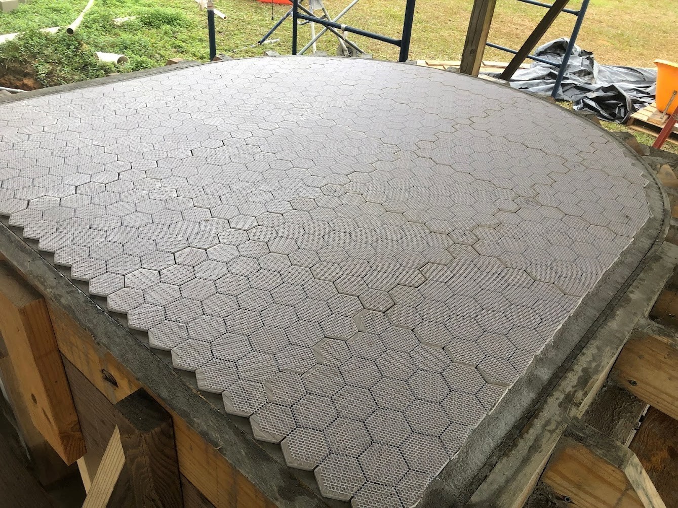

              Here's another build that illustrates use of the "upside down" mosaic tile sheets (post #21, but whole thread is a good read).

                Here's a pic showing under floor tiles supporting cal sil insulation. It's a bit hard to see but it also shows one of the four drain vent holes which lines up with the dome insulation space. (Also two in the centre of the floor)
                Click image for larger version  Name:	IMG_0613.jpg Views:	0 Size:	134.6 KB ID:	462307 Click image for larger version  Name:	IMG_0661.jpg Views:	0 Size:	122.5 KB ID:	462308
