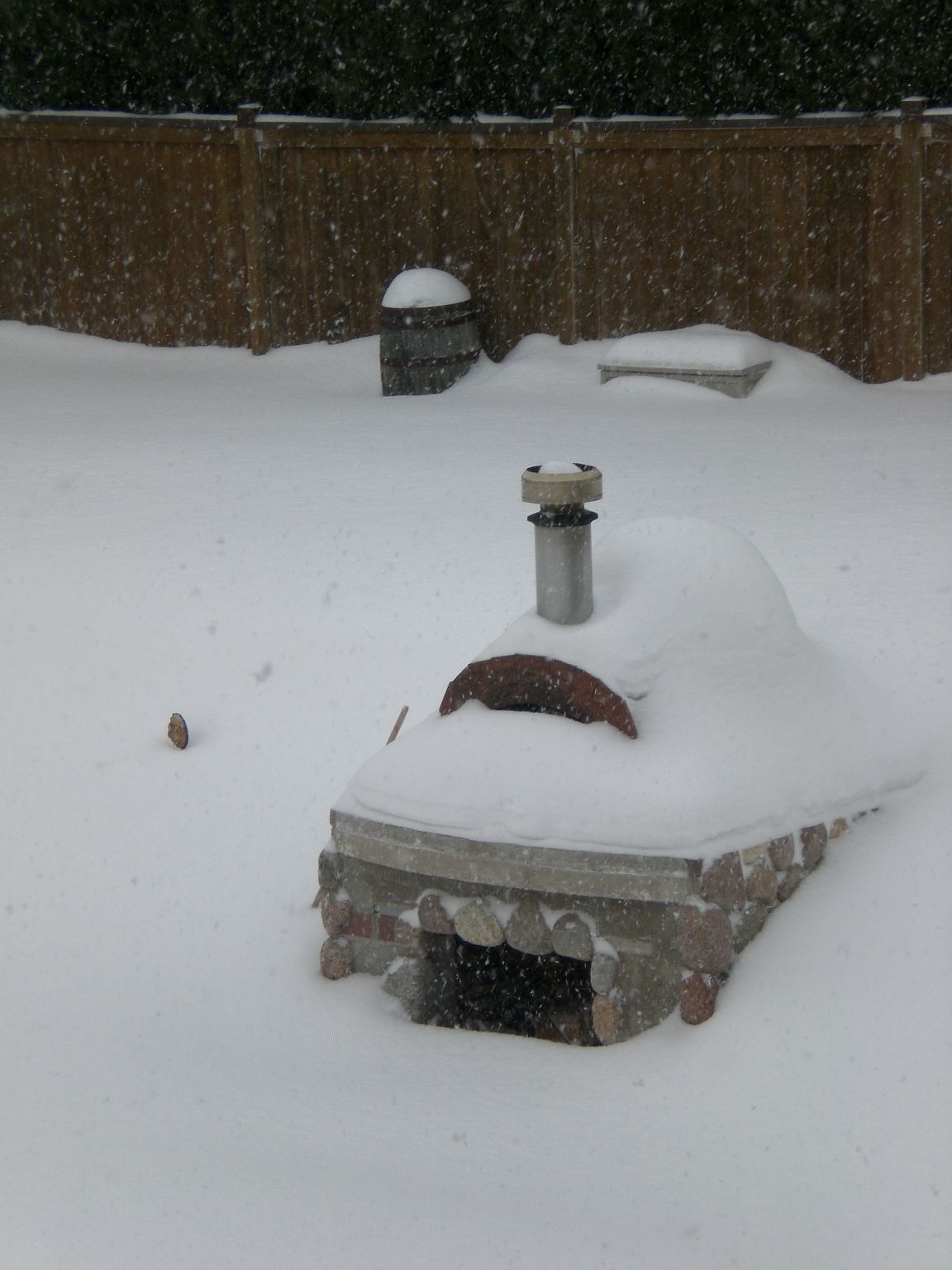

The question I'd ask about Enerwrap is about the facing and it's ability to withstand heat. The RW won't have any problems with a WFO at temp and I'd bet that the facings won't but I'd ask about it. I used 2" RW boards, these are flexable to some degree, in direct contact with my dome. The price was right and with a bit of easy manipulation, ripping tearing and stuffing, I had coverage.
In my application, a structure enclosed oven, I didn't need as much tailoring as an igloo type oven would need. I don't know that the ceramic blanket does any better job of insulation than does the RW, at least in my application. In the end I have a minimum of 5 inches of RW at the base of the oven and the insulation thickness increases as you move up the oven. I'd guess I have 8 inches of RW over the top of the oven and additional vermiculite over this. The benifit of the oven house is the ability to add additional insulation and provide weather protection.
