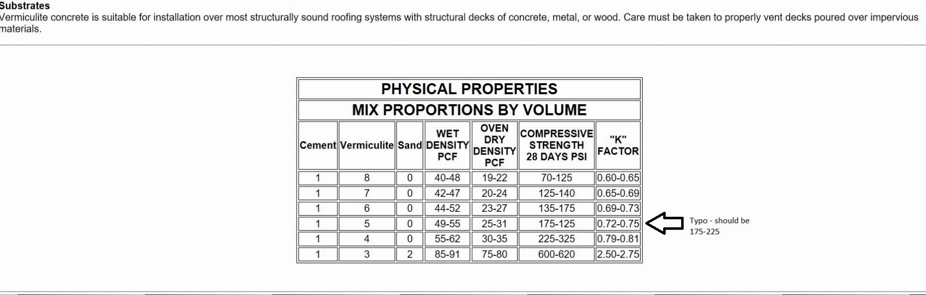

                      Ok, that sounds like a plan. While any exposure to flame is the most detrimental re rusting, I’d be guessing that the plate which supports the floor is mild steel. Any other structural elements in the oven, including fixings are also more vulnerable if not stainless. Insulating under the supporting plate sounds like a much easier solution, but bear in mind that a highly conductive material in you insulation space is not ideal, especially if it is not stainless and will be exposed to both heat and moisture.
                      To make a vermicrete mix you should be able to buy smaller quantities of both perlite and vermiculite at Bunnings. Nursery suppliers probably only stock 100 litre bags.
                      Making a lean mix is important to achieve good insulation value as the density of the cement, even in a 10:1 mix is greater than the lightweight aggregate.( see attached table).
                      A 50/50 mix of medium grade perlite and fine grade vermiculite works nicely with a 10:1 mix. Ie 5 litre perlite 5 litres vermiculite with one litre GP cement. To make this very lean mix more workable throw in a handful of hydrated lime or powdered clay. Mix all dry ingredients well in a barrow. Water addition depends quite a lot on the grade of the aggregate used, but for mine it’s 4 litres. The water needs to be added and folded in progressively. If it pools slightly in the bottom of the barrow, that’s the correct amount. Continue to fold the mix and the grains will absorb the excess water. Wear rubber gloves to apply the mix. Not sure about your dimensions but for around 100mm thick you might need a couple of the above batches. The high water content of the mix takes some time to dry. See attached drying test.
                      But bear in mind that any modifications you make will void your warranty.
                      Click image for larger version  Name:	image_83170.jpg Views:	0 Size:	146.2 KB ID:	462447 Vermicrete insulating slab PDF.pdf
