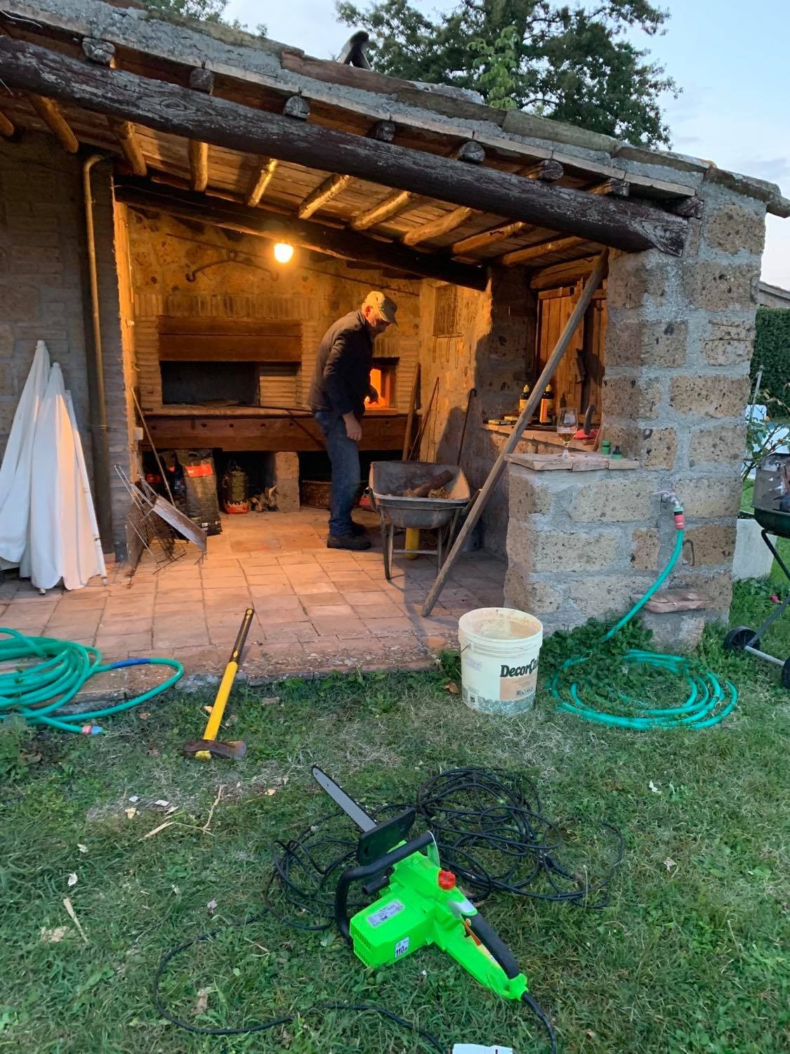

        There's a pic of the setup - oven + pizza oven built in to the house.
        The chimney goes up through the roof, but it's not shared with any of the house chimneys.

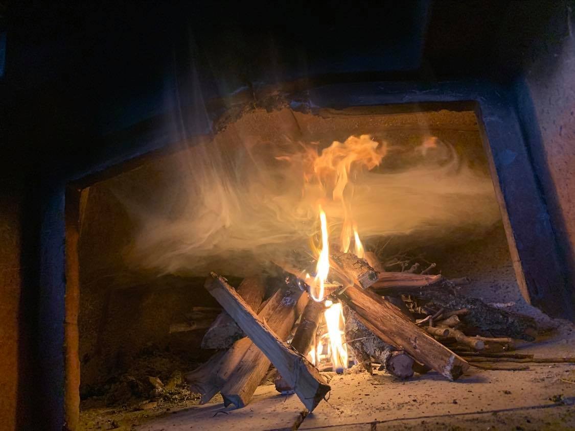

        Then there's a pic of the oven - there's no vent or flu inside the oven, just a narrow gap immediately behind the metal doors, about half an inch.
        If there were a flow, I can imagine the smoke being sucked up through that slit on its way out of the oven. I'm thinking I just need to get that flow moving.

          .....there's no vent or flu inside the oven, just a narrow gap immediately behind the metal doors, about half an inch.
          I may be confused! But, I'm assuming that your are referring to the (pizza) oven. If so, the "slit" is not enough opening size to remove the smoke from the oven. I would not build another fire in that oven without a proper flue opening. The danger is the possibility of putting too much fuel (wood) in the oven. Just like the smoke, flame can shoot out the front with an over built fire. That and exposed timbers in the shed could lead to a structural fire.
            My opinion is that you will need to build/install another chimney/flue just out side the cooking chamber of the "pizza oven".

              Hi Stephen
              Thanks for the detailed reply. Looking at an enhanced view of your photo. It seems like the smoke is sucked up into a much bigger "gap" than "half an inch" Please confirm.
