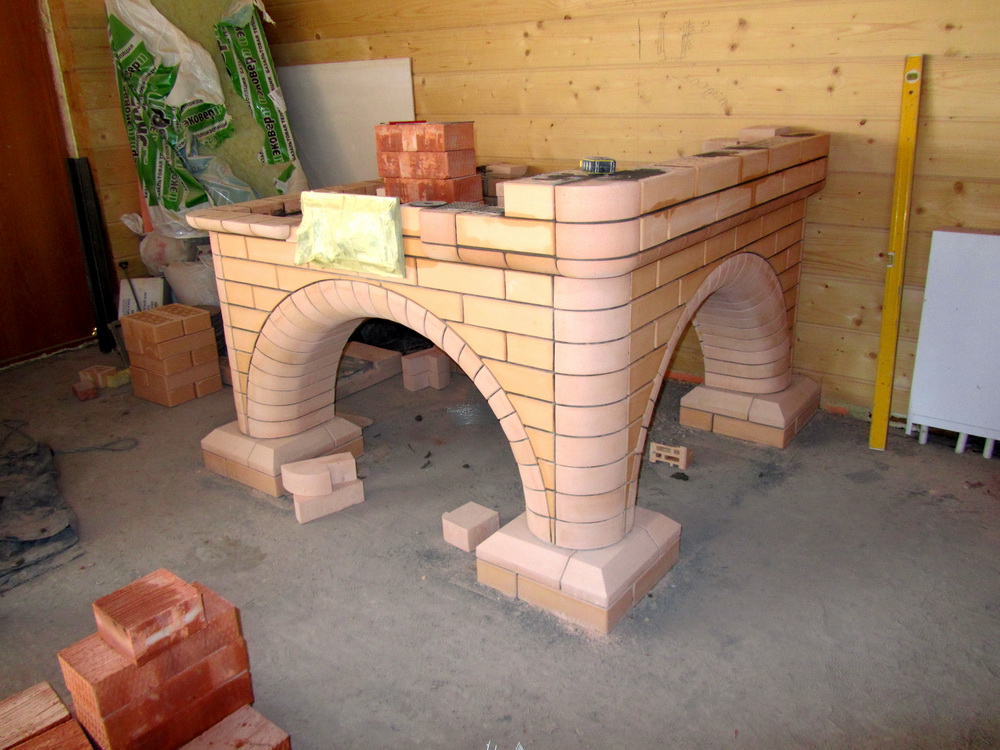

                      The lower part of the concrete blocks barbecue practical, but not very nice. You can do everything from a brick. like this
                      Fireclay brick hearth is better not to be laid on the solution, and lay on the sand, fireclay.
