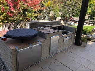

          I built mine over last 18 months. Selecting equipment was a challenge for sure. I found it helpful to ID the type of equipment I wanted first without getting into the nitty gritty of brand etc. My first step was to build a two tier patio for kitchen and fire pit. That was a couple years ago. The kitchen built has 42” WFO, larger 22” komando style grill smoker, gas grill (about 40”), side burner, 14 foot serving bar with insulated dry sink built into Glas reinforced concrete countertop, two under counter storage doors on either side of a built in Komodo grill space, 30 inch tool drawer below the gas grill, two door storage area below dry sink, 3 drawer storage built into serving bar and an under counter storage space for a rolling service cart. I purchased all equipment but WFO which I built last summer. Holding off let me finalize layout specs for cabinet bases I built from metal stud and track skinned with durock, glass reinforced browncoat and stucco. I use Komando for most small smoking jobs. I will be able to get smoke into WFO with little difficulty if needed for big jobs. My dry sink came out nice, it doubles as a beer / wine/ water chilled and accommodates 3 half 4” steam table trays with covers to serve chilled foods. I opted not to do a refrigerator, the dry sink has been great when packed with ice. It has a drain into the flower bed behind it.

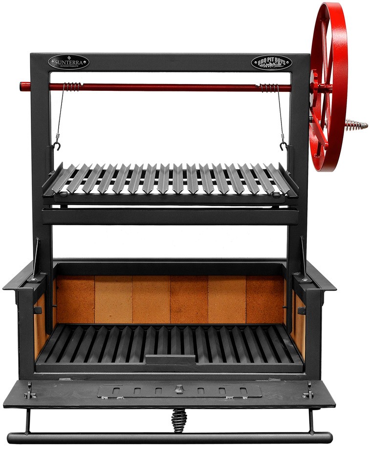

                WooHoo ... another SantaMaria / Argentine Grill lover ... So, am I. I like the Sunterra website that is also BBQ Pit Boys related / affiliated. Here is an image form their website:

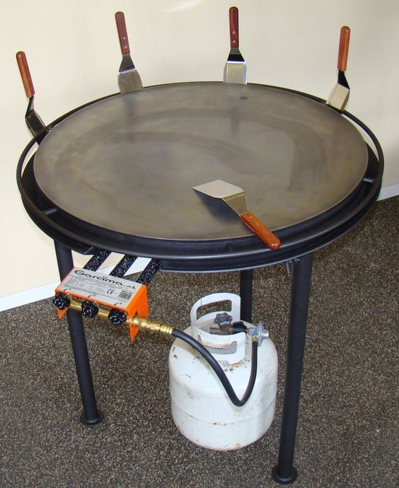

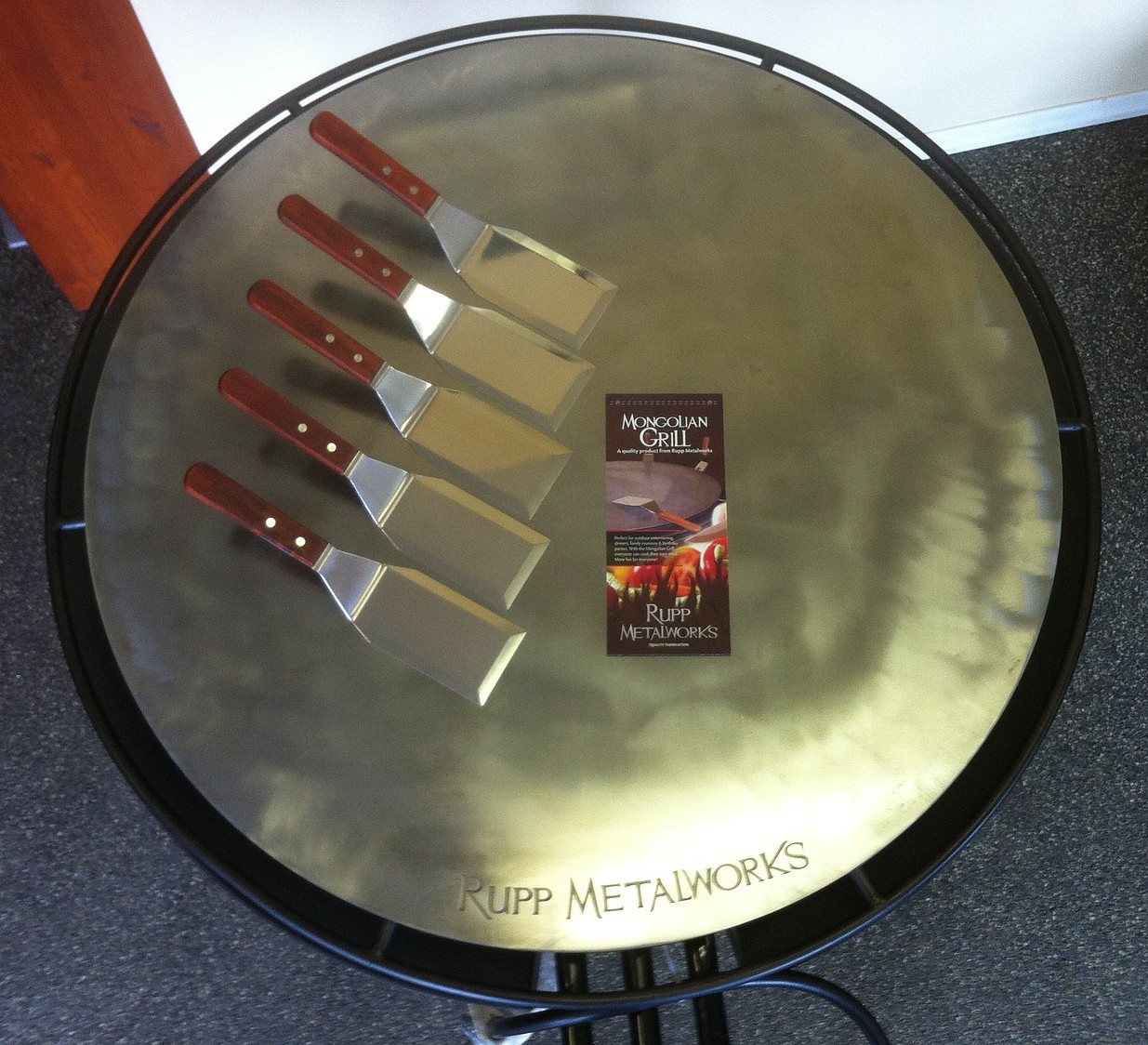

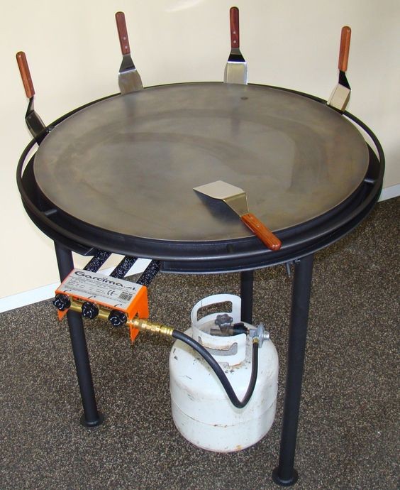

                  I really like my mongolian grill that is FLAT and gets b***chin hot ..!! I took the legs off and now it sits on top of my right side of my BBQ station .... and it looks like it is "floating" which is kinda cool. The Santa Maria grill is going to be on the right side.
                  • ogopogodude
                    • Feb 2017
                    • 102
                    Rupps Metalworks sold me this flat mongolian grill and the cool part is that they are only a stones throw away from my house in Kelowna, BC, Canada. They have their small metalworks operation in Salmon Arm BC. I paid around $1700 for it with the cover. They told me that they can make my unit natural gas since I have a bib nearby my station .. but they informed me that propane gets WAYYYY hotter and also heats up FASTER than natural gas. The tank is going to be hidden down below

                      Also, .. I wanted to stay away from the typical / conventional (boring as h***) bbq station with the typical stainless steel burner bbq. I wanted something TOTALLY different so that when I have guests over .... they say .."wow, ... that mongolian grill is soooooo cool, .. and that SanaMaria / argentine grill is even more cool." My BBQ station is definitely unique. I feel like a Cro-Magnon / Neanderthal since I use chucks or coal in combination with wood to get to the final glowing embers

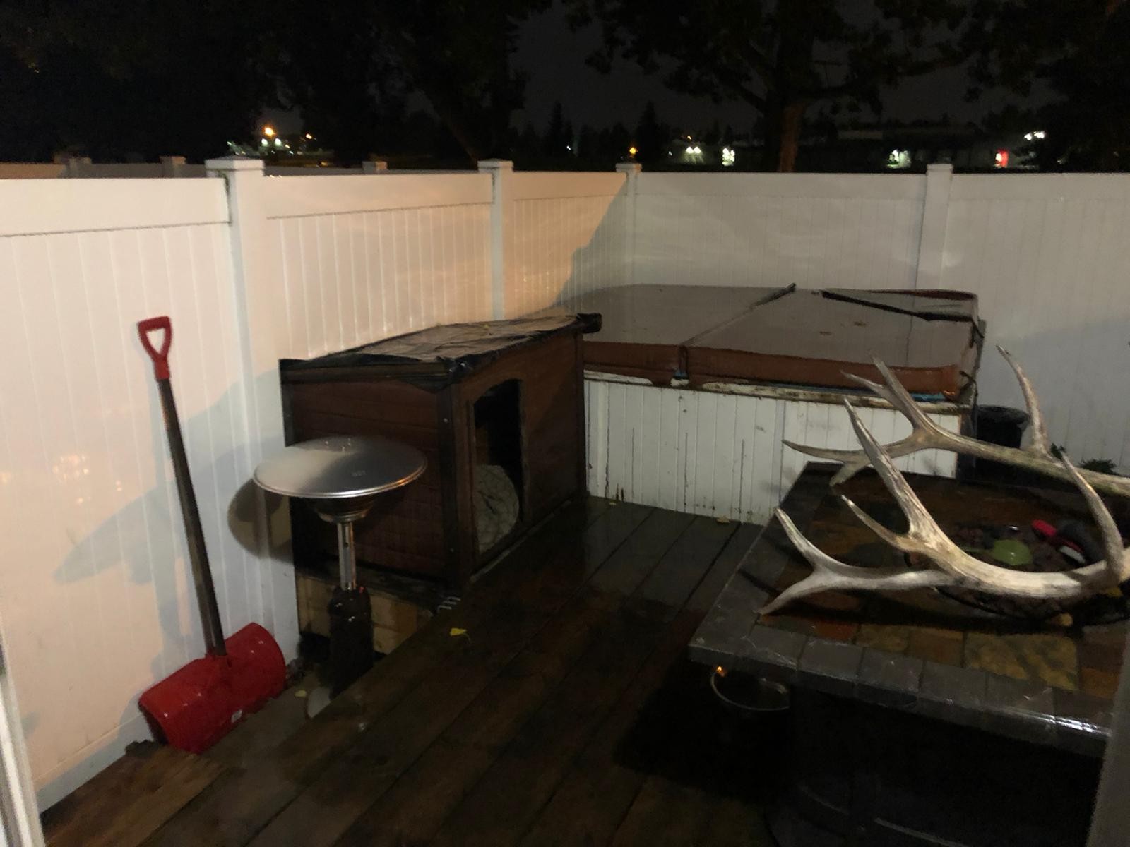

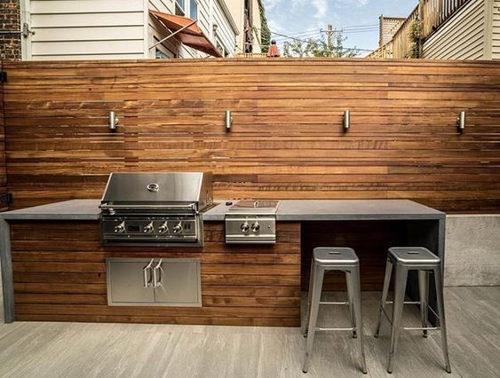

                        I'm also planning to rebuild my backyard and already got a new grill. At first, I wanted to get a Webber grill, but it's a bit expensive. So a friend of mine suggested to me Blossomz grill. It's not very expensive, has a large cooking area, and what I like the most, it has two separate sides for gas and charcoal.
                        On the images you can see what I have now and how I want it to be
                          Oooooooo...I want one of those!

                            Hello, .. they are pretty cool alright, .. I will provide a few more pics soon .. of my unfinished BBQ station that has yet to be masoned.
                            They are made "LOCALLY" , .. that is if you are a Canadian living in western Canada, specifically the province of BC. The workmanship is amazing. Very heavy (which is what one WANTS ... heavy means quality).

                              Here's a few more pics of the Mongolian Grill by Rupps MetalWorks in Salmon arm which is a small Mom & Pop operation near my home in Kelowna, BC, Canada. (near Vancouver)
