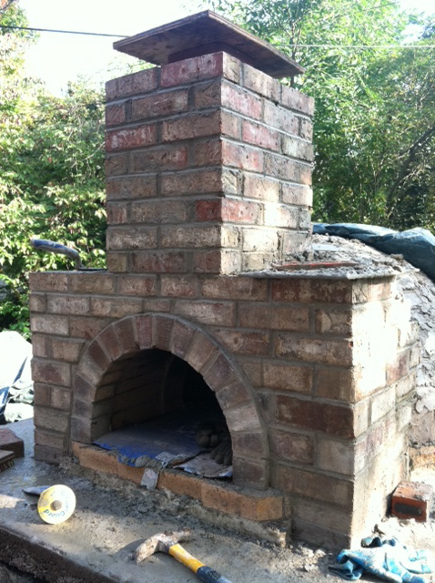

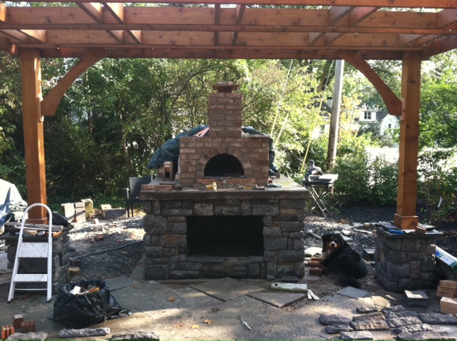

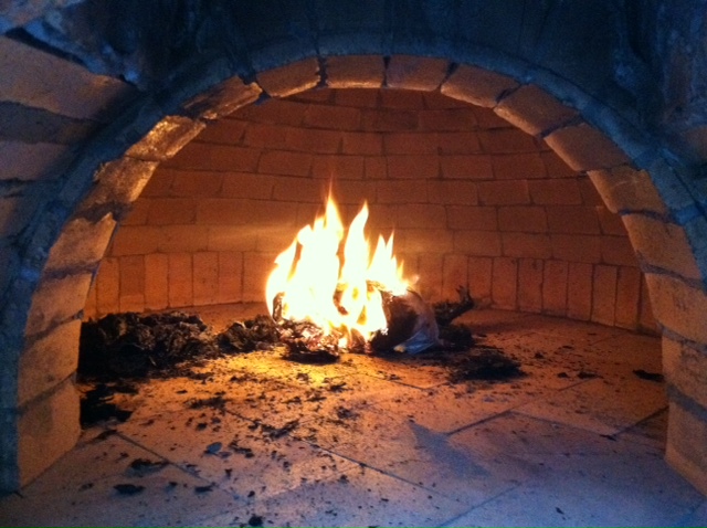

                  I will try to post some pictures of the smoke if I can get a good enough image. In the meantime, here are some pictures of my oven so far.... Thanks for all your help. Mike

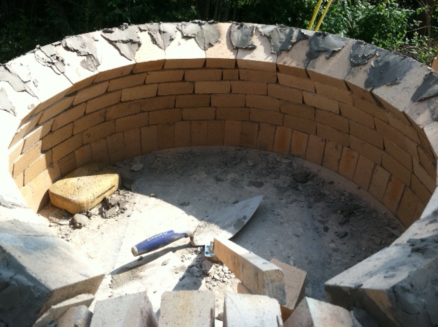

                        I know these are out of order but I thought maybe it would be helpful to see the dome construction in more detail....

                          Mike,
                          I assume you are going to cover this with a blanket. It doesn't matter if it is steam or smoke. You are doing an enclosure so you are safe to keep building (it won't be air tight). Keep the fire going to purge any vapor - no worries.
