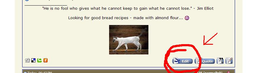

    Psst!!!!
    You can use the Edit button to fix your post - near as I can tell it's not set to a time limit.
    It's at the bottom of your post (you can only see it on your own post - hence using my sig for the example). Just click it and it'll let you back into the reply screen so you can make changes.
Name:	edit button pizza.JPG
