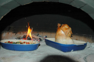

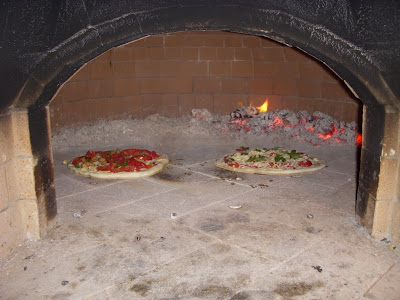

      Found some pics:
      Not cleared dome. I was roasting chicken so the temps are around 300-400 degrees. You do see some "clearing" down low, about the 1st 1-2" of brick since the logs and flames were concentrated there.
      This is a much hotter oven: it's around 900 degrees, so now all the black is gone and the dome is 'cleared', or cleaned. The bricks have absorbed all the heat and it's a much hotter oven than the pic above where you actually SEE flames.

                      What's interesting is the band of clear dome next to the floor suggesting the floor is contributing to the dome clearing upwards and the clear band of chicken just inside the ovenproof dish. Can you guess the oven temp in the first photo?
