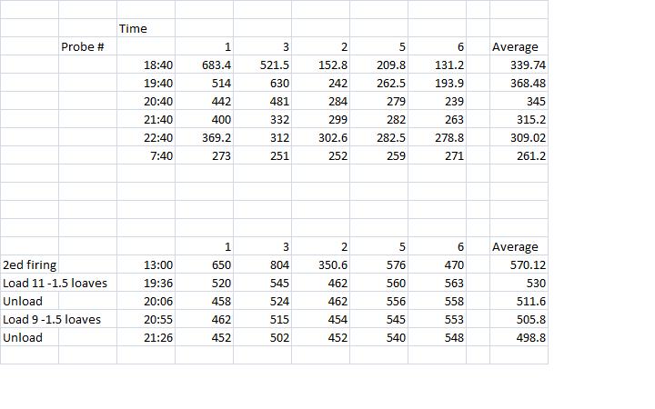

The first graph is the preheat of my oven for a bread bake the next day. It starts with a cold oven.
I have a 42 inch oven with 7.5 inches of thermal mass. the floor has 3.5 vermiculite/Portland insulation and the dome has 4" of ceramic.
I have 6 thermal couples (#4 is down due to wire connection problem)
#1 is center oven floor 3/4 inches from the oven interior.
#2 is center oven floor 4.5 inches from the oven interior
#3 is mid dome 3/4 inches from the oven interior
#4 is on the other side 3/4 inches
#5 is mid dome 4.5 inches from the interior
#6 is on the outside of the dome between the oven and the insulation.
You will note that I recorded the time at each measurement. I started the measurement at the end of the firing and left the coals in and put on the insulated door so the oven wall increased temperature after the door went in. You can see how long it takes the interior heat to migrate outward.
The second graph is the firing on bake day.
I started a medium fire at 08:00
Raked out the coals at 13:00
Loaded 11 each 1.5 lbs loaves at 19:36
Unloaded at 20:06
Loaded 9 each 1.5 lbs loaves at 20:55
Unload at 21:26
So this was quite interesting for me and it is a great help to know when I have enough heat for the oven. I find that if I average out the temperatures of my probes I can have a good idea what temperature the oven will equalize to. Nothing sucks worse then to have your oven too hot or too cold when your bread is ready to go in.
I hope you can follow my graphs I tried to put in the data that is in the spread sheet but it was unreadable when it got here.
When you look at the graphs probe #1 and #3 are 3/4 from the interior #2 and #5 are 4.5 inches from the interior and #6 is all the way out.
