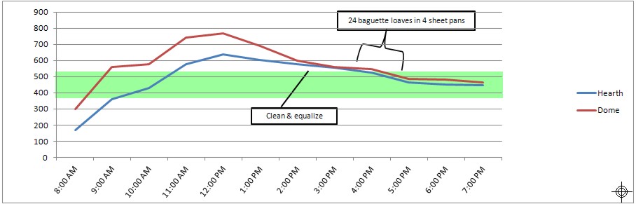

        Yes, I only keep a fire in the oven when I'm doing pizza. My oven holds heat well after firing and I just don't like to have all the ashes flying around when I'm baking...so out they come before I start cooking. Normally I bake on Fridays between 15-20 loaves of bread in three batches and the temp holds just fine. I think as long as your oven is well insulated it will bake a lot of food after sweeping the fire out. If you have an IR gun (or can borrow one), bring the oven up to temp and use the gun to get some time/temp data. Graphing the data really helps you in determining your oven's capabilities. I attached a line graph of temps I did for my oven so you can see what I mean.
        I just baked a 21.7 pound (9.8 Kg) turkey this last week in the oven. I started a fire late in the evening before, only coals left in the morning. Started the fire up again and when the oven cleared, I swept out the coals and closed it down to let the oven equalize. When I put the turkey (roaster pan + water/onions/apples) in, the oven temp was a bit high (500F/260C) but I covered the bird with foil and just rotated the pan every 45 minutes or so. I took the foil off for the last 45 minutes to get a good browning and made sure I had internal temps appropriate for turkey "doneness". Out for a rest after the four hour bake and it was fabulous.
