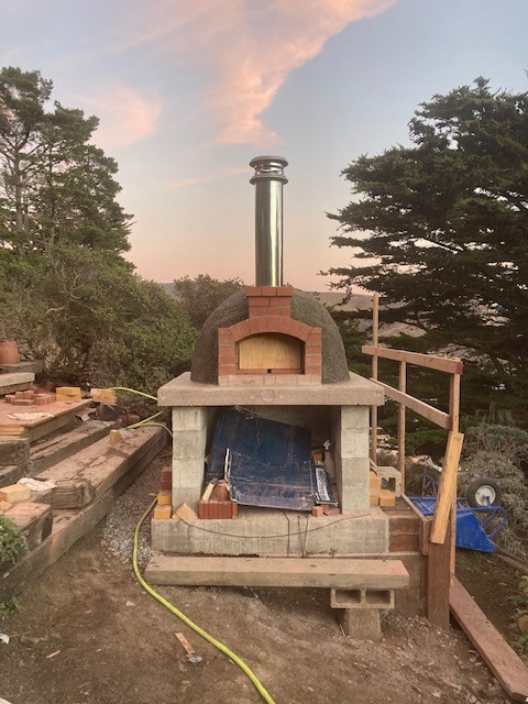

I have been curing my oven for the last week and I'm using the low, long and slow method. The first 4 fires I used lump charcoal and increased by temperature 100 degrees each day. I was taking temperature readings with an inferred thermometer on the brick at the top of the dome and then on the sides as well. On day 5 I started using small pieces of wood and kept the fire going making sure not to exceed the target temperature.
Now that I am using wood I'm not sure when to take the temperature reading. If I take it while the flame is licking the top of the dome it quickly reaches 600 + degrees. When the fire dies down a little and I take a temperature reading on the dome it reads closer to 500 degrees. My question is do I take a temperature reading when there is a flame or wait until after the fire has died down a little. Is it the temperature of the brick that needs to reach the desired temperature or is it the peak temperature of the fire.
I'm also looking for advice about the best way to finish the outer dome.
The hearth is insulated with 2" thick ceramic fiber board which I understand should not get wet. I put a layer of the Forno Bravo waterproof mortar over the entire dome before insulating. There is 2" of ceramic blanket insulation covered with 2" of pcrete mixed 4:1. Over the top of this I was planning on using an acrylic stucco. I understand the acrylic stucco is flexible and less likely to crack but I've also heard that it will eventually crack making it no longer waterproof. Should I put another layer of the waterproof mortar over the pcrete before applying the stucco?
Any information you can provide me with would be greatly appreciated. Thanks!
