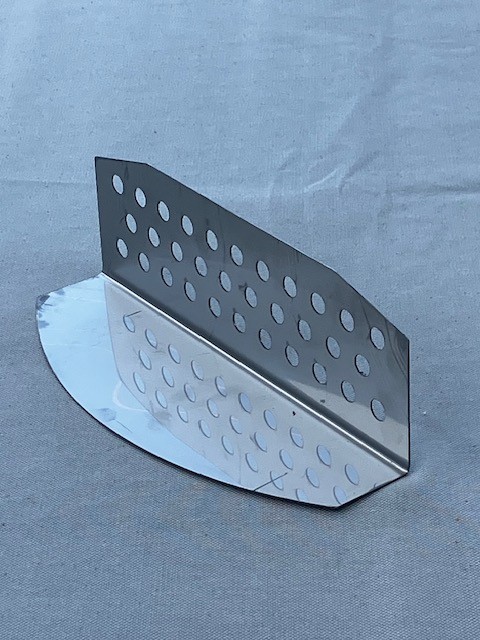

      Can I ask about the still L bracket? Does that contain the wood? Did you order from somewhere or put together yourself?
        Because my oven is small, burning of the pizza edge can be a problem with the pizza so close to the fire. To solve this issue and provide more cooking floor area, I made an L shaped guard from 0.5mm stainless (with no holes) and used it for about 10 years with good success. So, I had a bunch laser cut from a thicker material, 300 x 300 x 95 x 0.9 mm and also designed in some holes to allow some air and heat through the vertical side.
        The original prototype suffered from warping badly, so don't go too thin. Mild steel would also work although it will rust. Don't use galvanized because the zinc will burn off and the fumes are highly toxic.
        I don't think anyone sells them, but not too hard to make, but any metal shop should be able to make one up if you're not up to fabricating it yourself.A curved edge for the horizontal part can be shaped to fit your oven perimeter.
        With the bulk of the coals pushed to the rear of the oven, feeding preheated sticks from the entry and easily fed into what I call the "fire tidy", management of the fire on the side is pretty simple.

          Purplehouse I bought mine from Amazon. it's similar to the one in David's picture but without the tapered corners. Will not do pizza without it now. If you're someone who moves the fire from side to side to recharge the floor during long bakes, the holes also make it easy to hook and reposition it.
