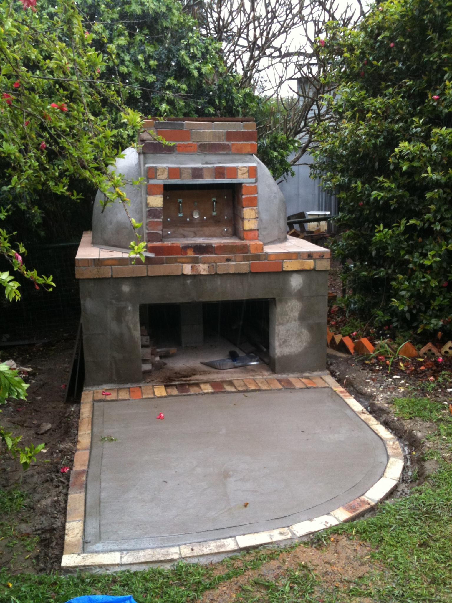

                              I'll throw this in the pot
                              My wfo has 55mm 21/4in Hebel cemmet block layer under the hearth. Dome insulation is 1200 C ceramic insulation 1in thick all over and extra inch over the top down to 8in from bottom then this is covered with Fiberglass insulation 4in.
                              Wire and cement render over this. Works... seems to. Gets warm on top but you can comfortably hold you hand on it. Junction of dome and brick chimney does get noticabily warmer. perhaps the heat travels up the brick. the cement slab remains cool with a warm spot in front.im sure this is because the hebel stops and the hearth bricks continue past them.
                              before I forget the fire bricks are "lighter" 29 per cent silica.
