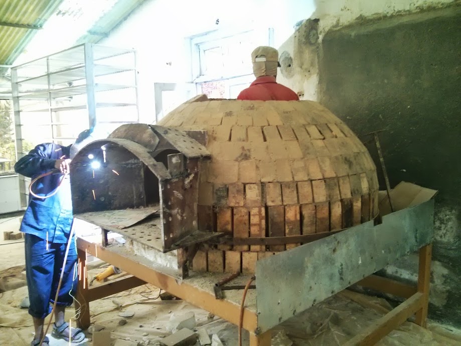

                  #23
                  Re: Second Large WFO in India
                  have a few more pictures of all the work done today.
                  made a small fire, and i was expecting some sweating which i got,also started working on the front facia
                  adding the mounting skirt to the chimney
                  a view through the chimney and the skirt before being welded up
                  the chimney is on, the lower bricks under the door are in place and the fire is burning.
